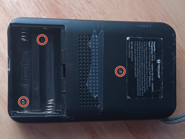

  1. TUFA21 TECHUP Radio Teardown, TUFA21 TECHUP Radio Teardown: crwdns2935265:01crwdnd2935265:01crwdnd2935265:02crwdne2935265:0 TUFA21 TECHUP Radio Teardown, TUFA21 TECHUP Radio Teardown: crwdns2935265:01crwdnd2935265:02crwdnd2935265:02crwdne2935265:0
    • Flip over the device
    • Remove the batteries.
  2. TUFA21 TECHUP Radio Teardown: crwdns2935265:02crwdnd2935265:01crwdnd2935265:03crwdne2935265:0 TUFA21 TECHUP Radio Teardown: crwdns2935265:02crwdnd2935265:02crwdnd2935265:03crwdne2935265:0 TUFA21 TECHUP Radio Teardown: crwdns2935265:02crwdnd2935265:03crwdnd2935265:03crwdne2935265:0
    Phillips #00 Screwdriver
    $5.49
  3. TUFA21 TECHUP Radio Teardown: crwdns2935265:03crwdnd2935265:01crwdnd2935265:03crwdne2935265:0 TUFA21 TECHUP Radio Teardown: crwdns2935265:03crwdnd2935265:02crwdnd2935265:03crwdne2935265:0 TUFA21 TECHUP Radio Teardown: crwdns2935265:03crwdnd2935265:03crwdnd2935265:03crwdne2935265:0
    • Remove the battery springs from the casing by pulling them up.
    • Example of what a battery spring looks like when already removed
  4. TUFA21 TECHUP Radio Teardown: crwdns2935265:04crwdnd2935265:01crwdnd2935265:01crwdne2935265:0
    • Unscrew the main board
  5. TUFA21 TECHUP Radio Teardown: crwdns2935265:05crwdnd2935265:01crwdnd2935265:03crwdne2935265:0 TUFA21 TECHUP Radio Teardown: crwdns2935265:05crwdnd2935265:02crwdnd2935265:03crwdne2935265:0 TUFA21 TECHUP Radio Teardown: crwdns2935265:05crwdnd2935265:03crwdnd2935265:03crwdne2935265:0
    • Lift up the main board and use your other hand to pull the antenna from its socket
    • Main Board
    • Antenna
    • Antenna Socket
  6. TUFA21 TECHUP Radio Teardown: crwdns2935265:06crwdnd2935265:01crwdnd2935265:03crwdne2935265:0 TUFA21 TECHUP Radio Teardown: crwdns2935265:06crwdnd2935265:02crwdnd2935265:03crwdne2935265:0 TUFA21 TECHUP Radio Teardown: crwdns2935265:06crwdnd2935265:03crwdnd2935265:03crwdne2935265:0
    • Pull the red plastic strip from the casing using your free hand.
  7. TUFA21 TECHUP Radio Teardown: crwdns2935265:07crwdnd2935265:01crwdnd2935265:01crwdne2935265:0
    iFixit Opening Tool
    $1.99
    • Remove the board glued to the speaker using your opening tool.
    • You will likely want some isopropyl alcohol to help you break through the adhesive more effectively.
