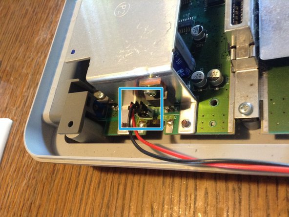

  3. Super Famicom Teardown, Removing the Power Switch: crwdns2935265:03crwdnd2935265:01crwdnd2935265:02crwdne2935265:0 Super Famicom Teardown, Removing the Power Switch: crwdns2935265:03crwdnd2935265:02crwdnd2935265:02crwdne2935265:0
    • We'll need to remove a couple screws with a Phillips #2 screwdriver.
    • It's plugged to the main board with a small plastic socket. Simply pull on it to set it apart.
    • Don't pull on the wires to avoid damaging them. Pull on the plastic socket instead.

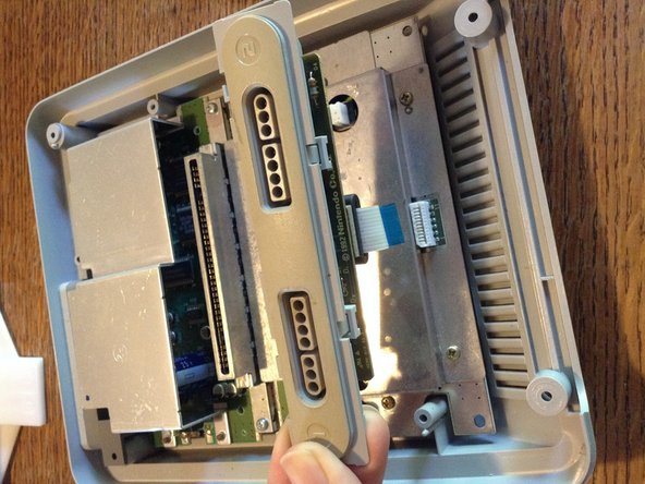

  4. Super Famicom Teardown, Removing the Front Panel: crwdns2935265:04crwdnd2935265:01crwdnd2935265:02crwdne2935265:0 Super Famicom Teardown, Removing the Front Panel: crwdns2935265:04crwdnd2935265:02crwdnd2935265:02crwdne2935265:0
    • The front panel is connected to the main board with a ribbon cable. Gently pull it out of its socket.
    • The front panel can then be lifted out.

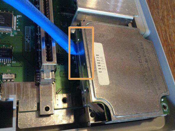

  6. Super Famicom Teardown, Removing the Sound Chip: crwdns2935265:06crwdnd2935265:01crwdnd2935265:02crwdne2935265:0 Super Famicom Teardown, Removing the Sound Chip: crwdns2935265:06crwdnd2935265:02crwdnd2935265:02crwdne2935265:0
    • The chip is held by 2 Philips #2 screws.
    • It's then just held by the bus socket on the lower left side of the chip.
    • Simply shimmy it out of the socket. You might need the help of a prying tool but don't put to much pressure on the cartridge port.

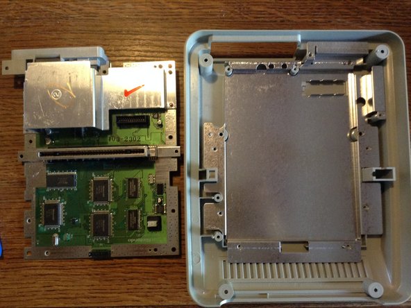

  7. Super Famicom Teardown, Lifting the Main Board: crwdns2935265:07crwdnd2935265:01crwdnd2935265:02crwdne2935265:0 Super Famicom Teardown, Lifting the Main Board: crwdns2935265:07crwdnd2935265:02crwdnd2935265:02crwdne2935265:0
    • The board is now only held by 3 Philips #2 screws.
    • Lifting the main board reveals the lower shield that got scrapped in later hardware revisions of the console.
