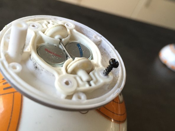

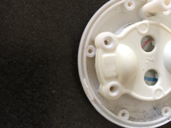

    • The head is kept in place by magnets. The wheels are located inside the head and pick up all kinds of dirt so over time the wheels are getting stuck by all the dirt and BB-8 doesn't respond as it did when it was new.
    • I thought i could pry the bottem out but that is not possible.
  3. Sphero BB-8 head Teardown & Cleaning, Open the Head: crwdns2935265:03crwdnd2935265:01crwdnd2935265:02crwdne2935265:0 Sphero BB-8 head Teardown & Cleaning, Open the Head: crwdns2935265:03crwdnd2935265:02crwdnd2935265:02crwdne2935265:0
    • use a plastic opening tool to pry the head open. There is some glue used so be careful not to use to much force.
    • The hardest part is to break the glue. once this step is done the head is much easier to take apart in the future.

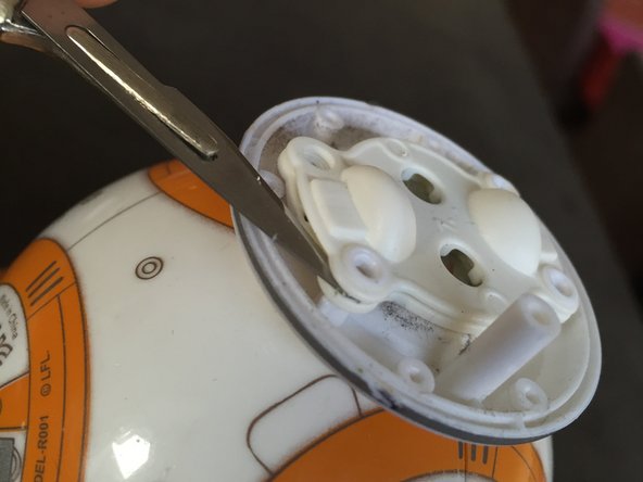

  5. Sphero BB-8 head Teardown & Cleaning, get access to the wheels: crwdns2935265:05crwdnd2935265:01crwdnd2935265:03crwdne2935265:0 Sphero BB-8 head Teardown & Cleaning, get access to the wheels: crwdns2935265:05crwdnd2935265:02crwdnd2935265:03crwdne2935265:0 Sphero BB-8 head Teardown & Cleaning, get access to the wheels: crwdns2935265:05crwdnd2935265:03crwdnd2935265:03crwdne2935265:0
    • cut the plastic rivets with a sharp blade. Make sure u don't loose any of the white plastic because it will be used again as a washer.
    • when u loose or break one (like me) i will show you how to make a new washer later on.

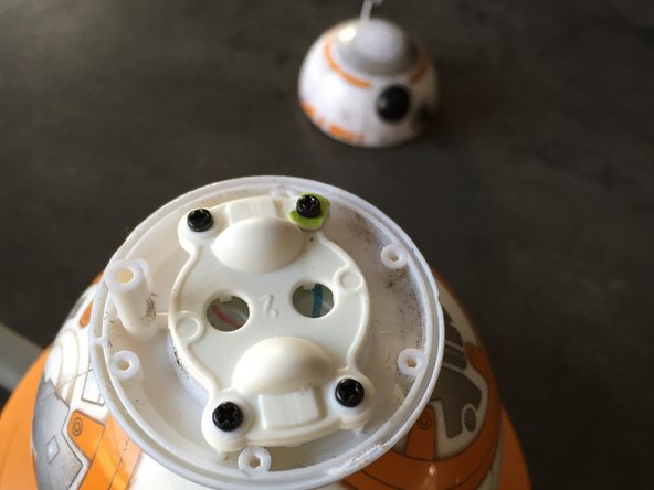

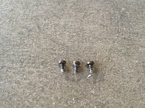

  6. Sphero BB-8 head Teardown & Cleaning: crwdns2935265:06crwdnd2935265:01crwdnd2935265:03crwdne2935265:0 Sphero BB-8 head Teardown & Cleaning: crwdns2935265:06crwdnd2935265:02crwdnd2935265:03crwdne2935265:0 Sphero BB-8 head Teardown & Cleaning: crwdns2935265:06crwdnd2935265:03crwdnd2935265:03crwdne2935265:0
    • use a small screw to make thread inside the plastic rivets.
    • I used some old laptop screws which I cut to the right size using a side cutter.
    • screw the top plate back using the cut screws and washers.

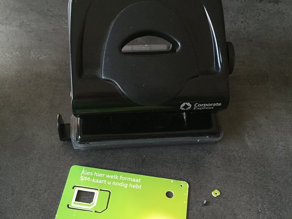

  7. Sphero BB-8 head Teardown & Cleaning, creating a washer: crwdns2935265:07crwdnd2935265:01crwdnd2935265:02crwdne2935265:0 Sphero BB-8 head Teardown & Cleaning, creating a washer: crwdns2935265:07crwdnd2935265:02crwdnd2935265:02crwdne2935265:0
    • use a perforator and an old bank or sim card to cut a plastic washer.
    • Make a hole use a small screwdriver.
