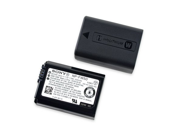

  4. Sony a7R II Teardown: crwdns2935265:04crwdnd2935265:01crwdnd2935265:02crwdne2935265:0 Sony a7R II Teardown: crwdns2935265:04crwdnd2935265:02crwdnd2935265:02crwdne2935265:0
    • We find the same NP-FW50 7.2 V, 1020 mAh swappable battery pack as the original a7R and the rest of the Sony Alpha lineup—good news for anyone building a fleet of flagship mirrorless cams.
    • Sony advertises a 290-photo battery life (up to 340 without the electronic viewfinder), a minor increase from the 270-photo limit of last year's model.
    • Sony kindly included not one but two batteries. You can also charge the battery inside the camera (USB adapter included), and even power the camera entirely via USB.

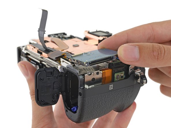

  10. Sony a7R II Teardown: crwdns2935265:010crwdnd2935265:01crwdnd2935265:03crwdne2935265:0 Sony a7R II Teardown: crwdns2935265:010crwdnd2935265:02crwdnd2935265:03crwdne2935265:0 Sony a7R II Teardown: crwdns2935265:010crwdnd2935265:03crwdnd2935265:03crwdne2935265:0
    • With the rear housing and button assembly removed, the motherboard shield comes out with very little resistance.
    • Getting our first clear view of the motherboard, we set to work disconnecting every ribbon cable created since the dawn of time.
    • Process note: We managed to get the motherboard out at this point, but we're pretty sure that's not as Sony intended. Had they deigned to give us a manual we would have known to skip ahead a few steps.

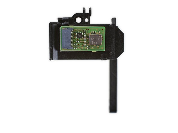

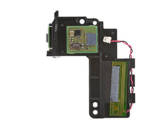

  13. Sony a7R II Teardown: crwdns2935265:013crwdnd2935265:01crwdnd2935265:03crwdne2935265:0 Sony a7R II Teardown: crwdns2935265:013crwdnd2935265:02crwdnd2935265:03crwdne2935265:0 Sony a7R II Teardown: crwdns2935265:013crwdnd2935265:03crwdnd2935265:03crwdne2935265:0
    • We find a trio of boards hiding behind the grip, supporting a couple of chips and what looks like an NFC antenna.
    • Perfect for Sony's Playmemories Mobile application, the NFC chip will allow interactions between smartphones the a7R II when Wi-Fi is not an option.
    • Funny how our smartphones are becoming more like cameras and our cameras are becoming more like smartphones, huh?

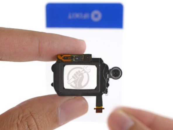

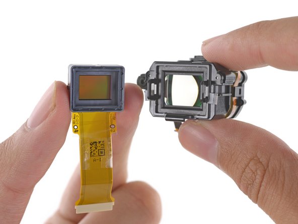

  14. Sony a7R II Teardown: crwdns2935265:014crwdnd2935265:01crwdnd2935265:03crwdne2935265:0 Sony a7R II Teardown: crwdns2935265:014crwdnd2935265:02crwdnd2935265:03crwdne2935265:0 Sony a7R II Teardown: crwdns2935265:014crwdnd2935265:03crwdnd2935265:03crwdne2935265:0
    • Back to the viewfinder—turns out we can pull it straight out of its cavity. With its frame previously dispatched, it was only held in place by a gummy thermal pad.
    • Why the thermal pad? Might have something to do with the 1.3 cm XGA OLED. With 1024 x 768 pixels in half an inch, that's 2,560 ppi. Wowza.
    • After removing the OLED, we take a peek through the lens assembly. A set of four optical lenses improve the field of view while minimizing distortion.
    • The lens assembly even works as a standalone upside-down-maker! Aren't optics cool? That logo sure is.
