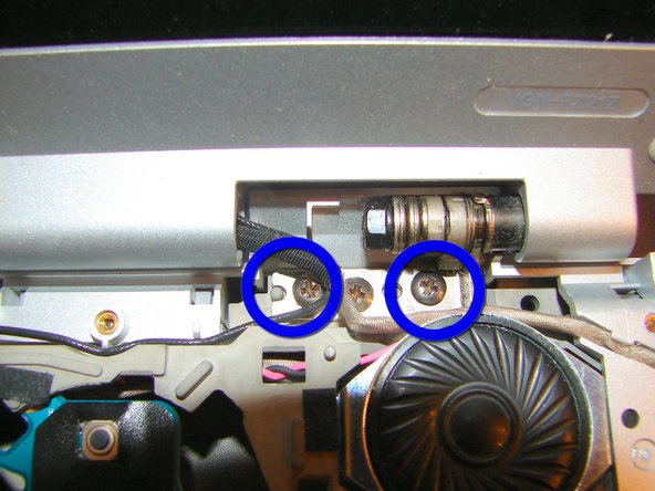

  5. Sony Vaio FZ Teardown: crwdns2935265:05crwdnd2935265:01crwdnd2935265:02crwdne2935265:0 Sony Vaio FZ Teardown: crwdns2935265:05crwdnd2935265:02crwdnd2935265:02crwdne2935265:0
    • We need to unscrew 4 more screws (next to the monitor holds) to release the bottom cover.
    • Unscrew only the 2 outside screws. The middle ones hold the monitor on its place.
    • On the left side the second screw is under the bunch of cables.
  6. Sony Vaio FZ Teardown: crwdns2935265:06crwdnd2935265:01crwdnd2935265:02crwdne2935265:0 Sony Vaio FZ Teardown: crwdns2935265:06crwdnd2935265:02crwdnd2935265:02crwdne2935265:0
