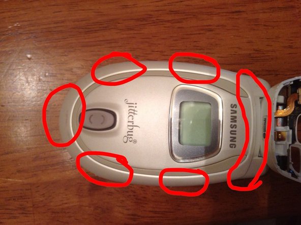

    • First remove the battery and rubber feet from base and under phone number inside.
    • Undo all six screws. Only the two under the battery will come out fully.

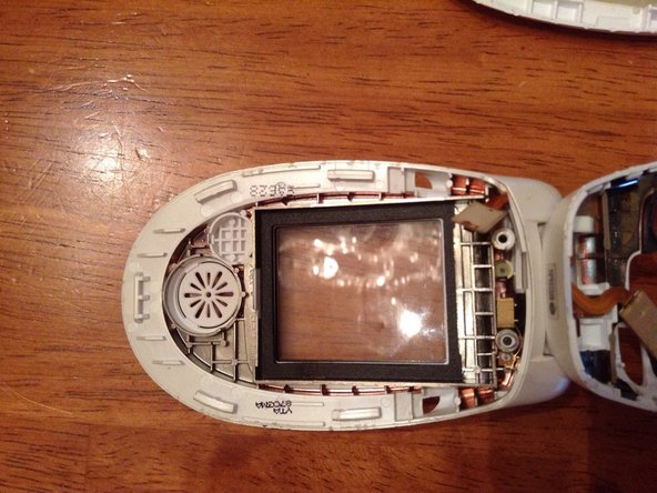

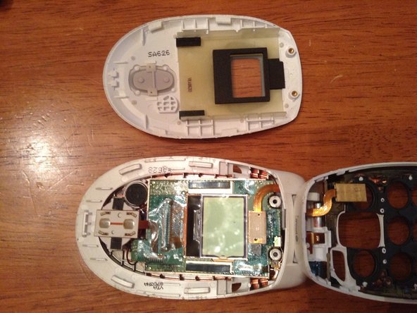

  2. Samsung Jitterbug Teardown: crwdns2935265:02crwdnd2935265:01crwdnd2935265:02crwdne2935265:0 Samsung Jitterbug Teardown: crwdns2935265:02crwdnd2935265:02crwdnd2935265:02crwdne2935265:0
    • Pop the six clips indicated in green and remove back. I removed the two on the sides first, but it was a huge pain to open the rest of the way. I suggest starting from the top four.
    • Blue is the connector to the screen and speaker board in the top of the phone.
    • Purple is the chip and orange is charging port.
    • The opposite side of the board (not pictured) has the microphone on it, it's a small black round bump on the bottom.

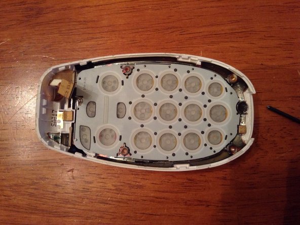

  3. Samsung Jitterbug Teardown: crwdns2935265:03crwdnd2935265:01crwdnd2935265:03crwdne2935265:0 Samsung Jitterbug Teardown: crwdns2935265:03crwdnd2935265:02crwdnd2935265:03crwdne2935265:0 Samsung Jitterbug Teardown: crwdns2935265:03crwdnd2935265:03crwdnd2935265:03crwdne2935265:0
    • Unhook screen connector and pop out board (just put a screwdriver under and pop).
    • Peel off button pad.

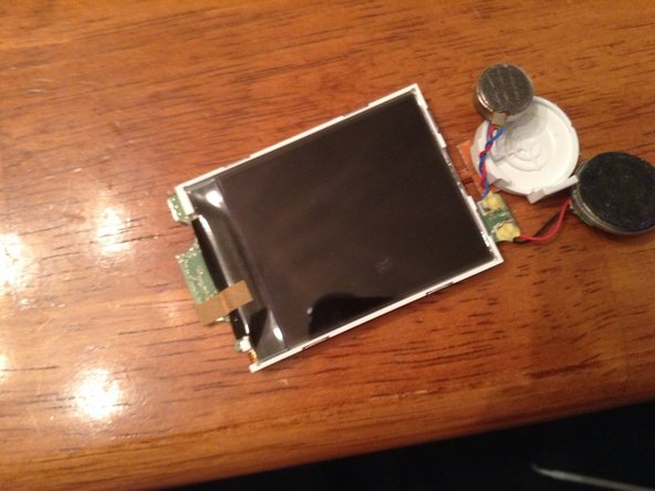

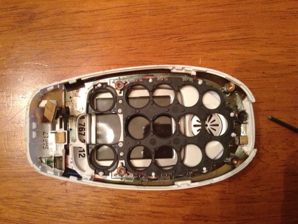

  4. Samsung Jitterbug Teardown: crwdns2935265:04crwdnd2935265:01crwdnd2935265:03crwdne2935265:0 Samsung Jitterbug Teardown: crwdns2935265:04crwdnd2935265:02crwdnd2935265:03crwdne2935265:0 Samsung Jitterbug Teardown: crwdns2935265:04crwdnd2935265:03crwdnd2935265:03crwdne2935265:0
    • Remove rubber front, then turn over.
    • Pop all five clips. Start at the top near the hinge and work down.
  5. Samsung Jitterbug Teardown: crwdns2935265:05crwdnd2935265:01crwdnd2935265:03crwdne2935265:0 Samsung Jitterbug Teardown: crwdns2935265:05crwdnd2935265:02crwdnd2935265:03crwdne2935265:0 Samsung Jitterbug Teardown: crwdns2935265:05crwdnd2935265:03crwdnd2935265:03crwdne2935265:0
    • Blue is main screen and mini screen board. Green is button and underneath is the main speaker. Purple is
    • Pop out all pieces. Be careful not to break the cabling connecting the outer bits to the board.
