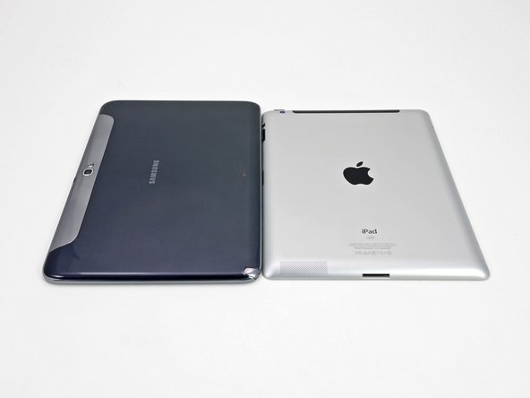

  4. Samsung Galaxy Note 10.1 Teardown: crwdns2935265:04crwdnd2935265:01crwdnd2935265:03crwdne2935265:0 Samsung Galaxy Note 10.1 Teardown: crwdns2935265:04crwdnd2935265:02crwdnd2935265:03crwdne2935265:0 Samsung Galaxy Note 10.1 Teardown: crwdns2935265:04crwdnd2935265:03crwdnd2935265:03crwdne2935265:0
    • The Note 10.1, with a thickness of 8.9 mm, is actually thinner than the third generation iPad, and almost the same thickness as the iPad 2.
    • As a reminder, a standard pencil measures in at 6.4 mm. So, if you're looking for the ultimate slimness in note taking, paper and pencil is still the way to go.
    • The 10.1" screen on the Note 10.1 is also larger than the 9.7" screen on the iPad.
    • But paper and pencil win again. The Note 10.1 and the iPad fall a few inches short of the 13.9" diagonal length of a standard piece of paper.

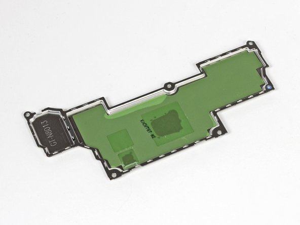

    • Sometimes EMI shields can be scary/tricky to remove, depending on which procedure a manufacturer uses to attach them to the motherboard. In some cases, the shields are soldered directly to the motherboard (the worst scenario), while in others the frames of the shields are soldered, but the top covers are removable.
    • …Unless EMI shields happen to be screwed in, as is the case here. We love screws, especially when they hold in components that typically require desoldering.
    • This is the first device we've seen with screwable EMI shields. Props to you, Samsung.
  13. Samsung Galaxy Note 10.1 Teardown: crwdns2935265:013crwdnd2935265:01crwdnd2935265:02crwdne2935265:0 Samsung Galaxy Note 10.1 Teardown: crwdns2935265:013crwdnd2935265:02crwdnd2935265:02crwdne2935265:0
    • In addition to protecting important components of the motherboard from electromagnetic interference, it appears that these EMI shields also serve as the Note's heat sinks.
    • The green film on the insides of the EMI shields holds thermal paste and thermal pads in place, which help move heat away from the motherboard through small holes in the tops of the shields.

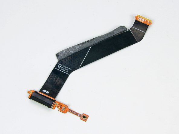

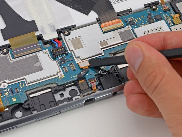

  15. Samsung Galaxy Note 10.1 Teardown: crwdns2935265:015crwdnd2935265:01crwdnd2935265:03crwdne2935265:0 Samsung Galaxy Note 10.1 Teardown: crwdns2935265:015crwdnd2935265:02crwdnd2935265:03crwdne2935265:0 Samsung Galaxy Note 10.1 Teardown: crwdns2935265:015crwdnd2935265:03crwdnd2935265:03crwdne2935265:0
    • Just like all of the components that we disconnected in the first few steps, the dock connector can be removed by simply detaching a connector and unscrewing a pair of screws. More points for repairability!
    • Samsung's dock connector cable shares a bit of copper with the lower microphone.
    • As a reminder, the Samsung dock connector is not the same as Apple's dock connector, as shown by this image.

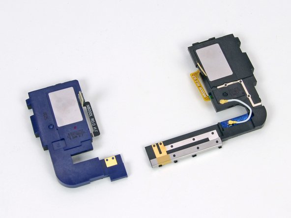

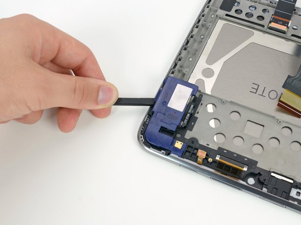

  16. Samsung Galaxy Note 10.1 Teardown: crwdns2935265:016crwdnd2935265:01crwdnd2935265:03crwdne2935265:0 Samsung Galaxy Note 10.1 Teardown: crwdns2935265:016crwdnd2935265:02crwdnd2935265:03crwdne2935265:0 Samsung Galaxy Note 10.1 Teardown: crwdns2935265:016crwdnd2935265:03crwdnd2935265:03crwdne2935265:0
    • At this point, it appears that there are no more screws left to remove from the device.
    • If you've been keeping score, you'll note that there are only five different size screws. This is a nice change from some devices that use nearly as many just to hold the lower case in place.
    • The speakers were held in place with some light adhesive, which we spudged right up!
    • The speakers in the Note 10.1 probably won't shatter any glasses, but they certainly do a good job of playing pleasant bubble noises as you navigate the Note's interface.

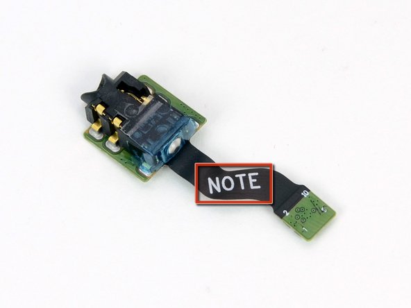

  19. Samsung Galaxy Note 10.1 Teardown: crwdns2935265:019crwdnd2935265:01crwdnd2935265:02crwdne2935265:0 Samsung Galaxy Note 10.1 Teardown: crwdns2935265:019crwdnd2935265:02crwdnd2935265:02crwdne2935265:0
    • Though many of the small components in this device are easily accessible without removing all the innards, the headphone jack has held strong this entire time.
    • The adhesive holding the headphone jack to the frame is not exceptionally strong, but we have not been able to get a good angle on it until now.
    • A quick flick of a plastic opening tool pops the headphone jack out.
    • Take note—this is the headphone jack.

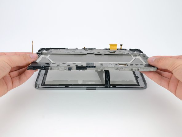

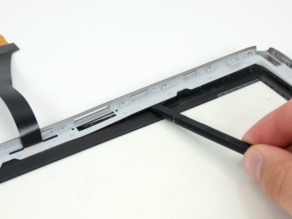

  20. Samsung Galaxy Note 10.1 Teardown: crwdns2935265:020crwdnd2935265:01crwdnd2935265:03crwdne2935265:0 Samsung Galaxy Note 10.1 Teardown: crwdns2935265:020crwdnd2935265:02crwdnd2935265:03crwdne2935265:0 Samsung Galaxy Note 10.1 Teardown: crwdns2935265:020crwdnd2935265:03crwdnd2935265:03crwdne2935265:0
    • Removing the frame and LCD from the front bezel presented a problem. The frame was held down by small plastic fasteners that protruded through holes in the frame, and were topped with small plastic rings. It seems that there is no way to remove the frame without snapping off the small rings.
    • As user Mark H. points out in the comments, this is a manufacturing procedure called heat staking.
    • Luckily, there are other clips and adhesive on the frame, so it should all hold together fine when we reassemble the device.
    • Some heavy prying with a spudger frees the front glass from the display bezel, confirming that the front glass and digitizer can be replaced.
