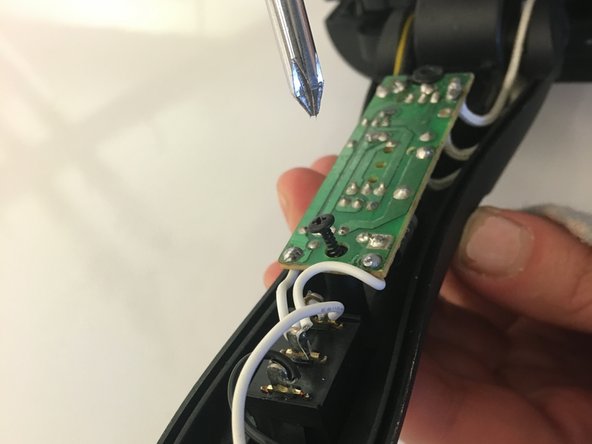

  4. Revlon Perfect Heat Jumbo 3 Barrel Waver Teardown, Circuit Securing Screw: crwdns2935265:04crwdnd2935265:01crwdnd2935265:02crwdne2935265:0 Revlon Perfect Heat Jumbo 3 Barrel Waver Teardown, Circuit Securing Screw: crwdns2935265:04crwdnd2935265:02crwdnd2935265:02crwdne2935265:0
    • Remove the small black screw that is holding the circuit board in place.

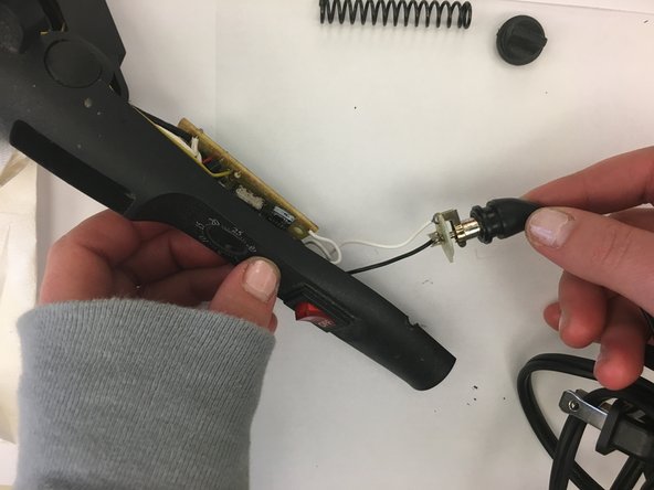

  5. Revlon Perfect Heat Jumbo 3 Barrel Waver Teardown, Power Cord: crwdns2935265:05crwdnd2935265:01crwdnd2935265:02crwdne2935265:0 Revlon Perfect Heat Jumbo 3 Barrel Waver Teardown, Power Cord: crwdns2935265:05crwdnd2935265:02crwdnd2935265:02crwdne2935265:0
    • Remove the power cord from the power port of the Waver by holding the port with one hand and pulling on the cord with the other hand.

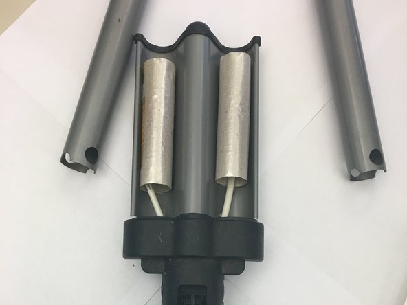

  6. Revlon Perfect Heat Jumbo 3 Barrel Waver Teardown, Metal Heating Cylinders: crwdns2935265:06crwdnd2935265:01crwdnd2935265:03crwdne2935265:0 Revlon Perfect Heat Jumbo 3 Barrel Waver Teardown, Metal Heating Cylinders: crwdns2935265:06crwdnd2935265:02crwdnd2935265:03crwdne2935265:0 Revlon Perfect Heat Jumbo 3 Barrel Waver Teardown, Metal Heating Cylinders: crwdns2935265:06crwdnd2935265:03crwdnd2935265:03crwdne2935265:0
    • Remove the two metal cylinders by sliding them down the length of the inner soft cylinders.
    • The internal ceramic cylinders are very soft and tear easily. Be careful not to damage them.

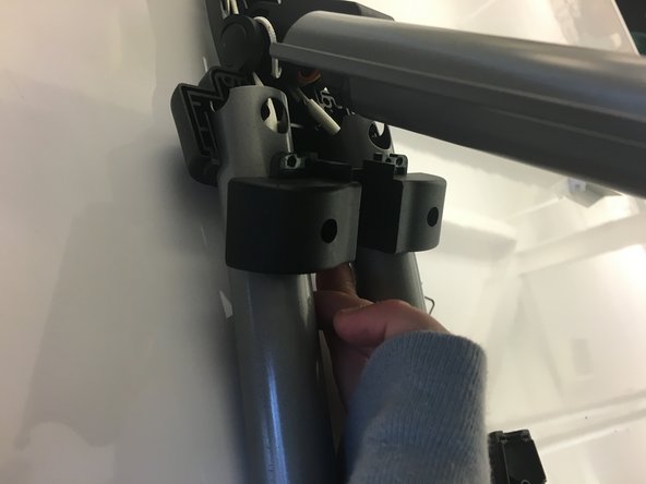

  7. Revlon Perfect Heat Jumbo 3 Barrel Waver Teardown, Cylinder Securing Fixtures: crwdns2935265:07crwdnd2935265:01crwdnd2935265:02crwdne2935265:0 Revlon Perfect Heat Jumbo 3 Barrel Waver Teardown, Cylinder Securing Fixtures: crwdns2935265:07crwdnd2935265:02crwdnd2935265:02crwdne2935265:0
    • Remove the plastic cylinder holders by lifting them up and along the length of the cylinder.

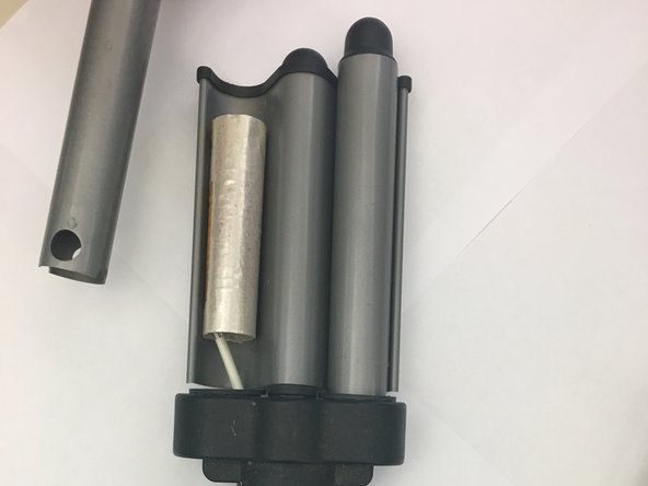

  8. Revlon Perfect Heat Jumbo 3 Barrel Waver Teardown, Rear Metal Plate: crwdns2935265:08crwdnd2935265:01crwdnd2935265:01crwdne2935265:0
    • Similar to step 4, remove the back metal plate by sliding down the length of the intern cylinder.
    • The internal cylinder is very soft and tears easily. Be careful not to damage it.
