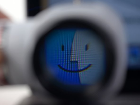

    • Those are pretty short keys. Bursting from its cocoon is Apple's newly-designed keyboard, equipped with a butterfly mechanism. Let's see if this keyboard will go twice as high as the traditional scissor-switch mechanism.
    • We zoom in on the Retina display, described by Apple as the thinnest, most energy-efficient Retina display ever on a Mac. The pixels themselves have a larger aperture, enabling more light to come through, resulting in greater energy efficiency without compromising brightness.

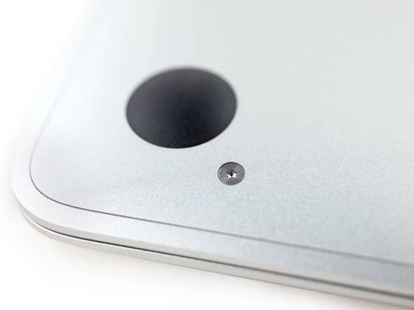

    • We make a quick note of the newly-minted model number—A1534—before moving forward.
    • This may be the future of laptops, but Apple has stuck to their tradition of using tamperproof 5-point pentalobe screws for the new MacBook. Le sigh.

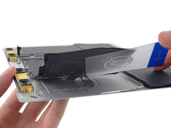

  15. Retina MacBook 2015 Teardown: crwdns2935265:015crwdnd2935265:01crwdnd2935265:03crwdne2935265:0 Retina MacBook 2015 Teardown: crwdns2935265:015crwdnd2935265:02crwdnd2935265:03crwdne2935265:0 Retina MacBook 2015 Teardown: crwdns2935265:015crwdnd2935265:03crwdnd2935265:03crwdne2935265:0

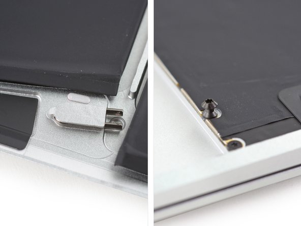

    • It was too much to hope that the battery would be secured with a few screws, MacBook Air-style. Time to break out the heat and the cards.
    • Apple's new terraced battery technology is supposed to provide 35% more battery cell capacity than would have been possible before.
    • We had hoped this would have provided room for a few screws, or some of those fancy little clips we saw on the case. Apparently not.
    • iOpener on a lower case? This just feels weird...
    • Scrape, peel, scrape, peel. Look at all that nasty adhesive.
  16. Retina MacBook 2015 Teardown: crwdns2935265:016crwdnd2935265:01crwdnd2935265:02crwdne2935265:0 Retina MacBook 2015 Teardown: crwdns2935265:016crwdnd2935265:02crwdnd2935265:02crwdne2935265:0
    • Ugh! Even the center cell of the battery is glued down, and we had hoped the sticky cells we found in the new 13" MacBook Pro wouldn't be a trend...
    • To complicate the procedure, the battery sits down in a well; the only safe place to pry is over this aluminum wall.
    • Apple says that they use photos from high-speed cameras to help align these batteries in their cases, accounting for variations at the microscopic level.
    • This level of precision works well for fitting the largest battery possible, but it doesn't bode well for the ideas of battery replacement.
    • Well, it's finally out—in all its multi-segmented glory.

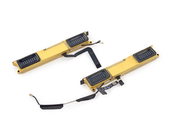

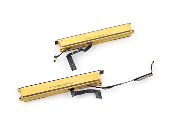

  18. Retina MacBook 2015 Teardown: crwdns2935265:018crwdnd2935265:01crwdnd2935265:03crwdne2935265:0 Retina MacBook 2015 Teardown: crwdns2935265:018crwdnd2935265:02crwdnd2935265:03crwdne2935265:0 Retina MacBook 2015 Teardown: crwdns2935265:018crwdnd2935265:03crwdnd2935265:03crwdne2935265:0
    • We've struck gold! ...Or maybe just a dielectric coating on aluminum.
    • The treasure antennas sit in channels routed into each speaker assembly.
    • If this is a dielectric coating, some of Apple's recent patents could suggest that Apple is using the speaker assemblies to form a compound antenna, helping maximize power efficiency in this smaller form factor.

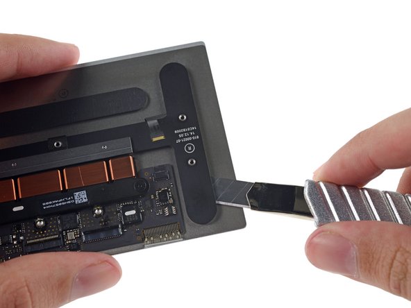

    • Finally, we reach one of the most talked-about trackpads in town. As we could expect, the Force Touch trackpad in the Retina MacBook looks like a slimmer, daintier version of the one we found in the 13" MacBook Pro.
    • Once we cut away the bracket, we get a clear view of the Taptic Engine.
  20. Retina MacBook 2015 Teardown: crwdns2935265:020crwdnd2935265:01crwdnd2935265:03crwdne2935265:0 Retina MacBook 2015 Teardown: crwdns2935265:020crwdnd2935265:02crwdnd2935265:03crwdne2935265:0 Retina MacBook 2015 Teardown: crwdns2935265:020crwdnd2935265:03crwdnd2935265:03crwdne2935265:0

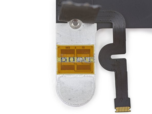

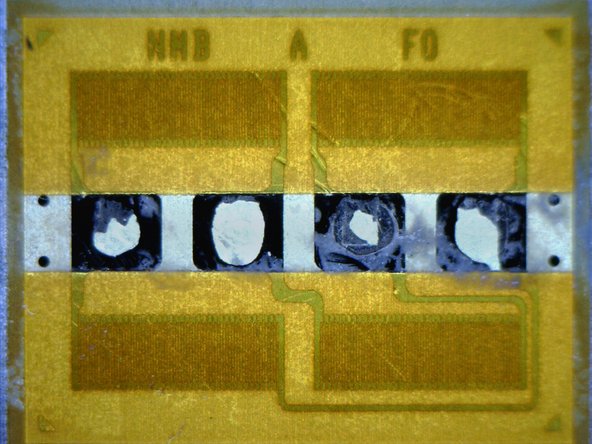

    • Only four strain gauges? Seems unlikely... Time to hunt around.
    • Ahah! Some strange rubbery glue was holding a cable over the second half of each strain gauge pair.
    • As we found previously in Apple's Force Touch, the strain gauges on this trackpad sense pressure from your fingers without really moving.
    • With the virtual feedback of the Taptic Engine, the new trackpad has essentially no moving parts, which usually makes for a more durable component.

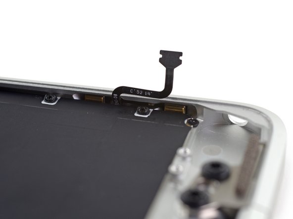

    • Another tri-wing bites the dust, and the USB-C port cable turns out to be an interconnect cable.
    • And the dang port is trapped by the display hinge! How rude.
    • Someone really doesn't want us to replace our sole everything-in-one port...
    • We'll come back for you later, USB-C.
    • Dang it! We should have said "USB-C you later."

    • To be fair, that screw you see in the corner is a pentalobe—a P2. That's an iPhone-sized screw. Apple doesn't really want to let us in.

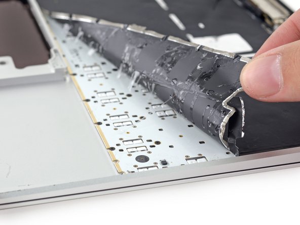

  24. Retina MacBook 2015 Teardown: crwdns2935265:024crwdnd2935265:01crwdnd2935265:03crwdne2935265:0 Retina MacBook 2015 Teardown: crwdns2935265:024crwdnd2935265:02crwdnd2935265:03crwdne2935265:0 Retina MacBook 2015 Teardown: crwdns2935265:024crwdnd2935265:03crwdnd2935265:03crwdne2935265:0
    • Three pentalobes later...
    • ...and 10 Phillips screws with weird sloping spacers, allowing them to secure the keyboard at an angle...
    • ...and finally two screws that fit into the case clips (throwback to step 6).

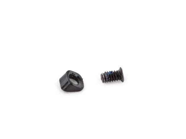

    • We can't complain too much, I mean screws are better than adhesive—oh my goodness.
    • The adhesive backing (a kind of layered tape) is stuck to the keyboard, and barely holds together upon peeling.
    • Under the blanket of tape is a field of disheartening stars. Two pentalobes per key, plus a row at the top and bottom, for a total of 83, plus the three from before.
    • "Look on my Macs, ye Mighty, and despair." — Jony Ive, probably.

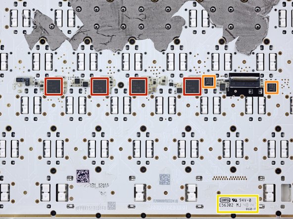

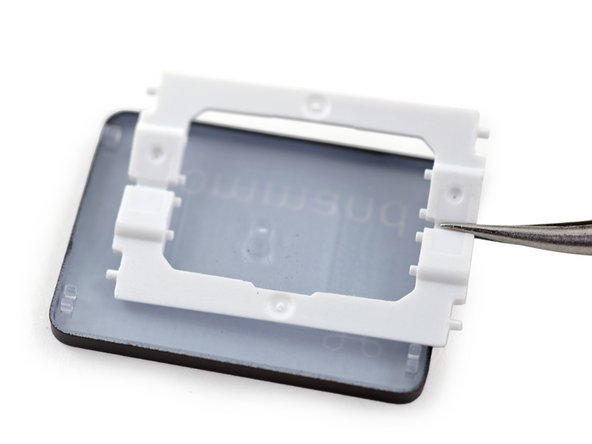

  25. Retina MacBook 2015 Teardown: crwdns2935265:025crwdnd2935265:01crwdnd2935265:03crwdne2935265:0 Retina MacBook 2015 Teardown: crwdns2935265:025crwdnd2935265:02crwdnd2935265:03crwdne2935265:0 Retina MacBook 2015 Teardown: crwdns2935265:025crwdnd2935265:03crwdnd2935265:03crwdne2935265:0
    • Daunted by the pentalobe-packed rear panel, we opt for frontal access. The keys pop off easily enough and seem to simply snap in place.
    • With very few moving parts inside, is it possible that this plastic butterfly mechanism might actually be a repair win?
    • Although we're a tiny bit worried about the plastic hinge fatiguing and breaking at its flex-point, we'll give Apple the benefit of the doubt and assume they've thought of that and designed for it.
    • The bracket is held in with tiny little clips; so cute.

    • Apple has opted to transition from using a row of LEDs with a light guide panel, to installing individual LEDs beneath each key.
    • And behind those keys, we find:
    • An array of four Texas Instruments TLC5951 PWM LED Drivers
    • A pair of NXP PCAL6416A I/O Expanders
    • They claim that this new keyboard design provides even lighting across the whole keyboard, while maintaining a higher level of power efficiency than previous designs.

    • The MacBook 2015 Repairability Score: 1 out of 10 (10 is easiest to repair)
    • Proprietary pentalobe screws continue to make opening the device unnecessarily difficult, and new cable routing makes the procedure even trickier.
    • The USB-C port is secured by tri-wing screws, and buried under the display brackets, complicating replacement. Also, being the only port, it will experience more use and wear than a typical single-purpose port.
    • The battery assembly is entirely, and very solidly, glued into the lower case.
    • The Retina display is still a fused unit with no separate, protective glass. If the display needs replacing, it'll cost a pretty penny.
    • The processor, RAM, and flash memory are soldered to the logic board.
