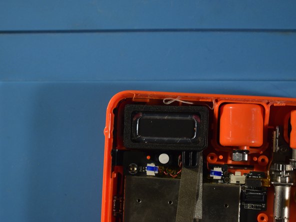

  8. Rabbit R1 Teardown, Removing the speaker: crwdns2935265:08crwdnd2935265:01crwdnd2935265:02crwdne2935265:0 Rabbit R1 Teardown, Removing the speaker: crwdns2935265:08crwdnd2935265:02crwdnd2935265:02crwdne2935265:0
    • The speaker is attached via clips and a screw. After removing the screw, slide the speaker toward the board and pull it up. Make sure to disconnect the speaker before removing it.
