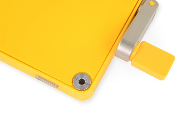

  3. Playdate Teardown: crwdns2935265:03crwdnd2935265:01crwdnd2935265:03crwdne2935265:0 Playdate Teardown: crwdns2935265:03crwdnd2935265:02crwdnd2935265:03crwdne2935265:0 Playdate Teardown: crwdns2935265:03crwdnd2935265:03crwdnd2935265:03crwdne2935265:0

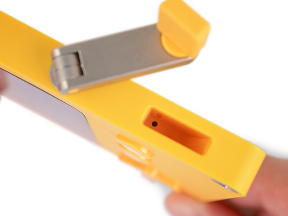

    • Inside the crank handle cavity: some secret intel.
    • Model number PDU1-Y—or is it PDU-Y-01? Either way, it's exactly what we expected.
    • Our serial number is 1255. Who got the first 1,254 units? No idea.
    • Hopefully they didn't think to take it apart and put it on the internet. Seriously, who would do that?
    • Answer: someone not intimidated by these donut-shaped flathead screws. Mmm... donuts.
    • Hang tight while we noodle on a strategy for opening this thing. If we have to eat a dozen donuts in the process, that's a sacrifice we're prepared to make. Will that help? Somehow yes.

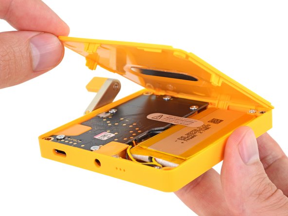

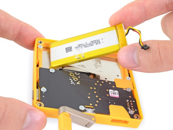

  5. Playdate Teardown: crwdns2935265:05crwdnd2935265:01crwdnd2935265:03crwdne2935265:0 Playdate Teardown: crwdns2935265:05crwdnd2935265:02crwdnd2935265:03crwdne2935265:0 Playdate Teardown: crwdns2935265:05crwdnd2935265:03crwdnd2935265:03crwdne2935265:0

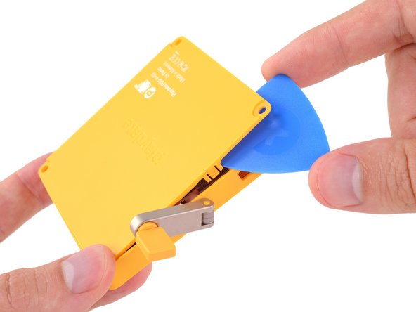

    • In we go! We grab our big flathead driver for this most diminutive console, and twist away some screws.
    • Next, a few plastic clips stand guard at the entry point. We're careful not to let any precious nostalgia escape while we wield our opening pick.
    • First look inside reveals: Tidiness. Yellowness. And an easily-accessible battery, a.k.a. repair happiness.

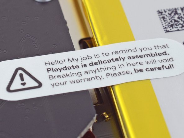

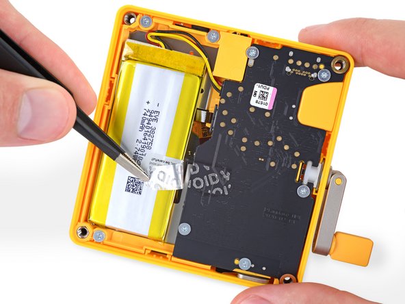

  6. Playdate Teardown: crwdns2935265:06crwdnd2935265:01crwdnd2935265:03crwdne2935265:0 Playdate Teardown: crwdns2935265:06crwdnd2935265:02crwdnd2935265:03crwdne2935265:0 Playdate Teardown: crwdns2935265:06crwdnd2935265:03crwdnd2935265:03crwdne2935265:0
    • Hold up—there's some sort of warranty sticker guarding this battery.
    • Zoom and enhance?
    • Oh, wait: breaking voids your warranty, not simply opening. A tip of the hat to the good sirs Magnuson and Moss, and we carry on—carefully.

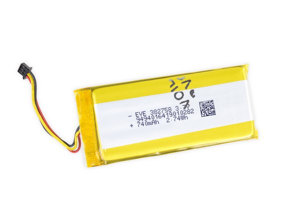

  7. Playdate Teardown: crwdns2935265:07crwdnd2935265:01crwdnd2935265:03crwdne2935265:0 Playdate Teardown: crwdns2935265:07crwdnd2935265:02crwdnd2935265:03crwdne2935265:0 Playdate Teardown: crwdns2935265:07crwdnd2935265:03crwdnd2935265:03crwdne2935265:0
    • Battery unpluggability: 8.5/10, mostly easy. Just make sure you don't poke anything flammable with your tweezers.
    • The battery itself is mildly glued down. Be persuasive, but don't make it angry.
    • Battery specs? It clocks in at 2.74 Wh (740 mAh @ 3.7V).
    • That's about 25% of the capacity of an iPhone 12, or:
    • 1.9% of a small car battery (kind of)
    • Inside the range of the sort of "general purpose" AA battery that Game Boys ate for sport
    • Close in performance to a 500-pound potato battery once driven around Portland, Ore.

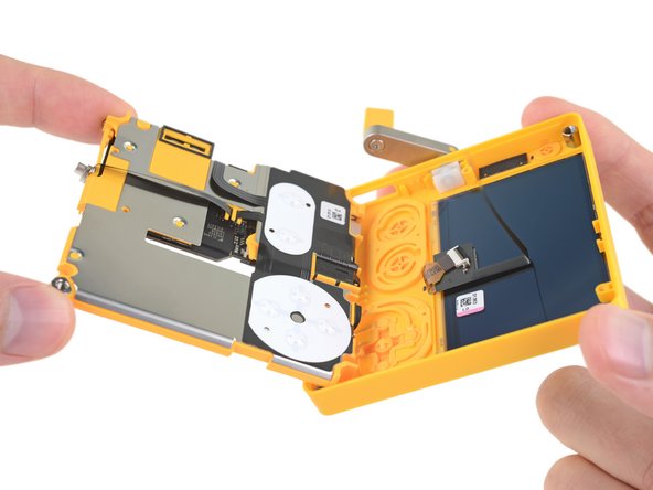

    Minnow Driver Kit
    $14.95
    • With our minimalist Minnow Driver Kit applied to a minimalist device, we separate pretty much everything from pretty much everything else.
    • Both the display and crank stay comfortably ensconced in the forward housing, along with some button covers.
    • Everything else just flips out, provided you're deft with a spudger and can persuade a few small ribbon cables to stand aside.
    • And here we get an early look at how the crank works. No gears! No funny business! Just a nice simple Hall-effect sensor and a ... thing ... enshrouded in white plastic. Important? We'll see.

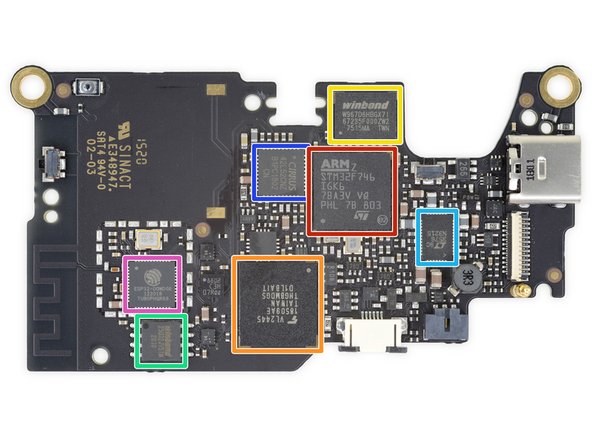

  9. Playdate Teardown: crwdns2935265:09crwdnd2935265:01crwdnd2935265:03crwdne2935265:0 Playdate Teardown: crwdns2935265:09crwdnd2935265:02crwdnd2935265:03crwdne2935265:0 Playdate Teardown: crwdns2935265:09crwdnd2935265:03crwdnd2935265:03crwdne2935265:0
    • More crank action in a minute, but first: Let's see what powers this pocketable piece of gaming goodness. The hidden side of the board contains:
    • STMicroelectronics STM32F746IGK6, an ARM Cortex-M7 based SoC
    • 4 GB of Kioxia (formerly Toshiba) THGBMDG5D1LBAIT eMMC NAND flash memory
    • 128 Mb of Winbond W967D6HBG low-power SRAM
    • 32 Mb of Winbond W25Q32JV serial NOR flash memory
    • Analog Devices (formerly Linear Techology) LTC3576 power management IC
    • Cirrus Logic CS42L52 audio codec w/ headphone/speaker amplifiers
    • Espressif Systems ESP32-D0WDQ6 Wi-Fi and Bluetooth SoC

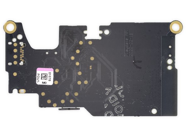

  10. Playdate Teardown: crwdns2935265:010crwdnd2935265:01crwdnd2935265:01crwdne2935265:0
    • This small board is packed full, so let's continue!
    • STMicroelectronics LIS3DH 3-axis MEMS accelerometer
    • Allegro MicroSystems A1266 Hall-effect switch
    • ON Semiconductor FUSB301TMX USB Type-C controller
    • Rohm BU4216FVE and BU4227FVE 1.6 V and 2.7 V voltage detector
    • Texas Instruments REG710NA-5 60 mA buck-boost charge pump
    • Microchip (formerly Micrel) MIC5365-3.3YC5 150 mA / 3.3 V LDO regulator
    • NXP Semiconductor NTB0104 voltage level translator

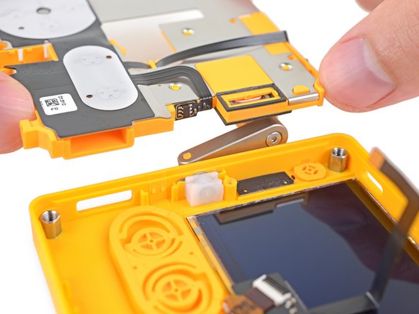

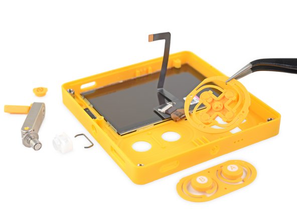

    • Time to pull the pin on this crank.
    • Out it comes. There's a cylindrical magnet embedded in the shaft. As it cranks, the rotating magnetic field hits the aforementioned Hall-effect sensor, which activates ... something, in your game.
    • One thing this crank won't do? Drift. There's no wiper or spring or sensor surface to wear out. The design is simplicity itself. You might even say there's ... no cranky-panky.
    • The Hall-effect sensor used here is an Infineon TLV493D-A1B6.

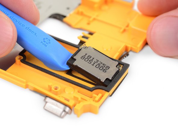

    • Elsewhere on the front side, the tiny mono speaker is adhered in place. Pretty easy to remove, but would be fussy to rework and replace.

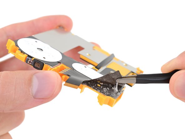

  12. Playdate Teardown: crwdns2935265:012crwdnd2935265:01crwdnd2935265:03crwdne2935265:0 Playdate Teardown: crwdns2935265:012crwdnd2935265:02crwdnd2935265:03crwdne2935265:0 Playdate Teardown: crwdns2935265:012crwdnd2935265:03crwdnd2935265:03crwdne2935265:0

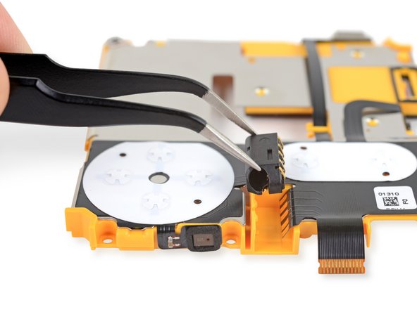

    • Here's where our disassembly efforts get gummed up.
    • The display—rumored to be a Sharp Memory LCD—seems firmly glued to the front half of the plastic enclosure. If you need to replace your display, you'll probably need a whole new plastic face—we were not confident we could separate the screen without destroying it. Probably not expensive, but not ideal.
    • Meanwhile, the buttons and other various I/O live on this sprawling flexible printed circuit, which is glued to the midframe. We started to un-glue it before realizing this wasn't a good, or reversible, idea.
    • One huge bright spot, though, is this 100% modular headphone jack. Is that considered retro now? Whatever the case, we're big fans.
    • A Knowles SPH1642HT5H-1 MEMS microphone can be found near the headphone jack, too!
