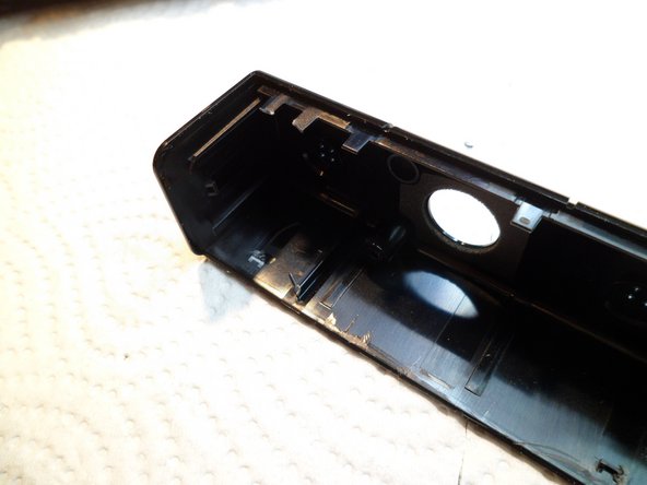

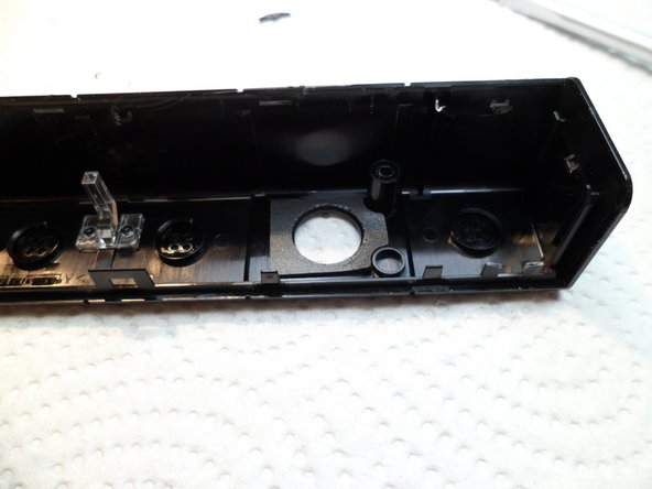

  4. PlayStation 4 Camera Teardown: crwdns2935265:04crwdnd2935265:01crwdnd2935265:03crwdne2935265:0 PlayStation 4 Camera Teardown: crwdns2935265:04crwdnd2935265:02crwdnd2935265:03crwdne2935265:0 PlayStation 4 Camera Teardown: crwdns2935265:04crwdnd2935265:03crwdnd2935265:03crwdne2935265:0
    • There are many clips in there.
  5. PlayStation 4 Camera Teardown: crwdns2935265:05crwdnd2935265:01crwdnd2935265:02crwdne2935265:0 PlayStation 4 Camera Teardown: crwdns2935265:05crwdnd2935265:02crwdnd2935265:02crwdne2935265:0
    • Encore two photos where to locate these nasty clips

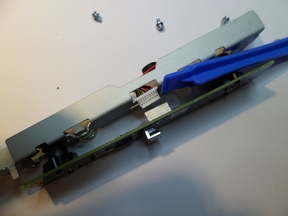

  6. PlayStation 4 Camera Teardown: crwdns2935265:06crwdnd2935265:01crwdnd2935265:03crwdne2935265:0 PlayStation 4 Camera Teardown: crwdns2935265:06crwdnd2935265:02crwdnd2935265:03crwdne2935265:0 PlayStation 4 Camera Teardown: crwdns2935265:06crwdnd2935265:03crwdnd2935265:03crwdne2935265:0
    • The other half of the housing is attached to a solid U-Frame with the electronics.
    • There are four silver screws, PH0.
    • Four microphones, two with black/yellow cables and two with black/red wiring.
  7. PlayStation 4 Camera Teardown: crwdns2935265:07crwdnd2935265:01crwdnd2935265:02crwdne2935265:0 PlayStation 4 Camera Teardown: crwdns2935265:07crwdnd2935265:02crwdnd2935265:02crwdne2935265:0
    • The backside of the U-frame. The cable is not soldered, there is a plug.
    • Detail of the plug.
  8. PlayStation 4 Camera Teardown: crwdns2935265:08crwdnd2935265:01crwdnd2935265:02crwdne2935265:0 PlayStation 4 Camera Teardown: crwdns2935265:08crwdnd2935265:02crwdnd2935265:02crwdne2935265:0
    • 6 PH1 screws. Take a small magnet to hold them.

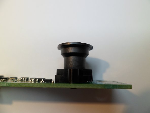

  10. PlayStation 4 Camera Teardown: crwdns2935265:010crwdnd2935265:01crwdnd2935265:03crwdne2935265:0 PlayStation 4 Camera Teardown: crwdns2935265:010crwdnd2935265:02crwdnd2935265:03crwdne2935265:0 PlayStation 4 Camera Teardown: crwdns2935265:010crwdnd2935265:03crwdnd2935265:03crwdne2935265:0
    • The lenses, plastic, glued tight.
    • NOT ADJUSTABLE.
  11. PlayStation 4 Camera Teardown: crwdns2935265:011crwdnd2935265:01crwdnd2935265:02crwdne2935265:0 PlayStation 4 Camera Teardown: crwdns2935265:011crwdnd2935265:02crwdnd2935265:02crwdne2935265:0
    • Backside, two small PH0 at each CCD. But the Cameramodules are clued to the board,too - without destruction, you can not open it.
    • I want to save it as spare-part, so i don't want to open it. So here is finito capito. :) Thanks for watching...

Only 7 steps? Where is the rest of the teardown? I wanted to see detailed images of the optics.
Alexandru Voda - crwdns2934203:0crwdne2934203:0
Ja, okay, i made some pictures for you. The optics are in Step 10.
Enjoy.
