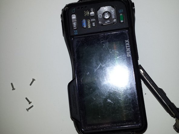

  2. Pentax Optio WG-1 GPS Teardown: crwdns2935265:02crwdnd2935265:01crwdnd2935265:03crwdne2935265:0 Pentax Optio WG-1 GPS Teardown: crwdns2935265:02crwdnd2935265:02crwdnd2935265:03crwdne2935265:0 Pentax Optio WG-1 GPS Teardown: crwdns2935265:02crwdnd2935265:03crwdnd2935265:03crwdne2935265:0
    • Remove 4 Phillips 1/4 inch 00 screws around the border of the display with the screwdriver.
  3. Pentax Optio WG-1 GPS Teardown: crwdns2935265:03crwdnd2935265:01crwdnd2935265:03crwdne2935265:0 Pentax Optio WG-1 GPS Teardown: crwdns2935265:03crwdnd2935265:02crwdnd2935265:03crwdne2935265:0 Pentax Optio WG-1 GPS Teardown: crwdns2935265:03crwdnd2935265:03crwdnd2935265:03crwdne2935265:0

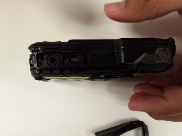

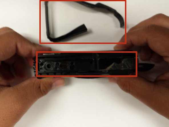

    • Remove the black rubber adhesive around the border of the device by peeling slowly.

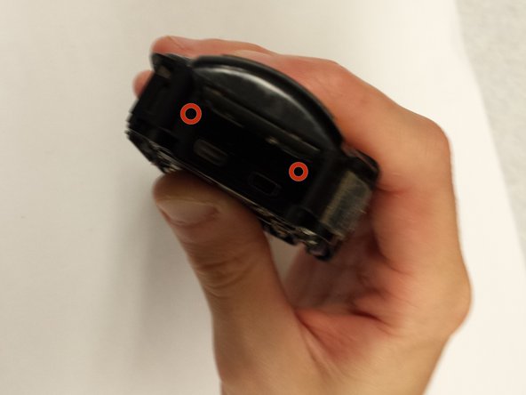

  4. Pentax Optio WG-1 GPS Teardown: crwdns2935265:04crwdnd2935265:01crwdnd2935265:02crwdne2935265:0 Pentax Optio WG-1 GPS Teardown: crwdns2935265:04crwdnd2935265:02crwdnd2935265:02crwdne2935265:0
    • Remove 2 Phillips 00 1/4 inch rubber sealed screws off the top of the camera.

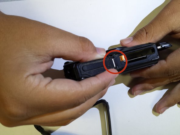

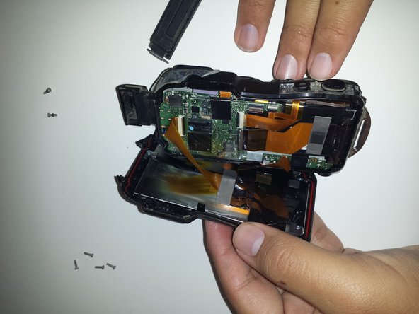

    • Remove the display screen from the casing. When opening, the micro USB cover and the battery cover will fall out with a pin.
  6. Pentax Optio WG-1 GPS Teardown: crwdns2935265:06crwdnd2935265:01crwdnd2935265:03crwdne2935265:0 Pentax Optio WG-1 GPS Teardown: crwdns2935265:06crwdnd2935265:02crwdnd2935265:03crwdne2935265:0 Pentax Optio WG-1 GPS Teardown: crwdns2935265:06crwdnd2935265:03crwdnd2935265:03crwdne2935265:0

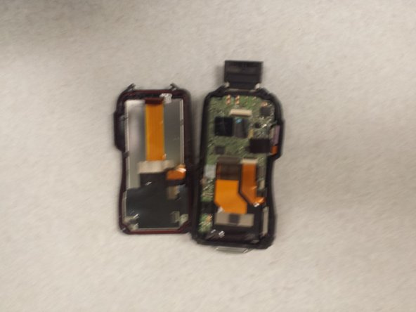

    • Remove all orange strips located on the motherboard and the LCD screen.
    • Lift black latches before removing the strips.

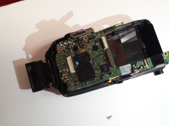

    • Remove 3 Phillips 00 screws from the motherboard.

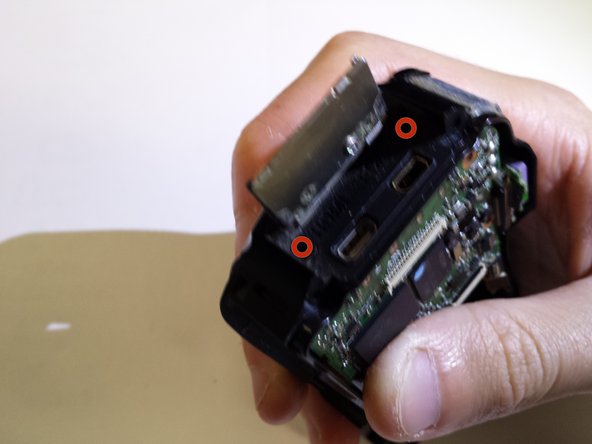

  9. Pentax Optio WG-1 GPS Teardown: crwdns2935265:09crwdnd2935265:01crwdnd2935265:03crwdne2935265:0 Pentax Optio WG-1 GPS Teardown: crwdns2935265:09crwdnd2935265:02crwdnd2935265:03crwdne2935265:0 Pentax Optio WG-1 GPS Teardown: crwdns2935265:09crwdnd2935265:03crwdnd2935265:03crwdne2935265:0
    • Remove 2 Phillips 00 screws from the mini USB bay.

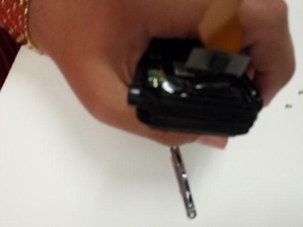

  10. Pentax Optio WG-1 GPS Teardown: crwdns2935265:010crwdnd2935265:01crwdnd2935265:01crwdne2935265:0
    • Remove 2 Phillips 00 screws from the silver handle on the side of the camera.

  13. Pentax Optio WG-1 GPS Teardown: crwdns2935265:013crwdnd2935265:01crwdnd2935265:03crwdne2935265:0 Pentax Optio WG-1 GPS Teardown: crwdns2935265:013crwdnd2935265:02crwdnd2935265:03crwdne2935265:0 Pentax Optio WG-1 GPS Teardown: crwdns2935265:013crwdnd2935265:03crwdnd2935265:03crwdne2935265:0
    • Remove the motherboard from the housing.
