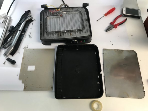

  1. Panini Iron Teardown, Side handles: crwdns2935265:01crwdnd2935265:01crwdnd2935265:02crwdne2935265:0 Panini Iron Teardown, Side handles: crwdns2935265:01crwdnd2935265:02crwdnd2935265:02crwdne2935265:0
    • Start by taking off the handle bar with the side handles by removing the screws on the side of the product.
  2. Panini Iron Teardown, Handle bar: crwdns2935265:02crwdnd2935265:01crwdnd2935265:03crwdne2935265:0 Panini Iron Teardown, Handle bar: crwdns2935265:02crwdnd2935265:02crwdnd2935265:03crwdne2935265:0 Panini Iron Teardown, Handle bar: crwdns2935265:02crwdnd2935265:03crwdnd2935265:03crwdne2935265:0
    • Next, seperate the handle bar from the side bars by unscrewing the screws on the inside of the handle bar.

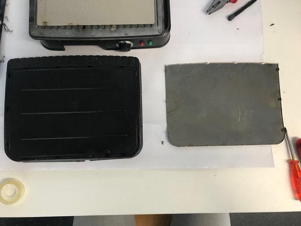

  3. Panini Iron Teardown, Top cover: crwdns2935265:03crwdnd2935265:01crwdnd2935265:02crwdne2935265:0 Panini Iron Teardown, Top cover: crwdns2935265:03crwdnd2935265:02crwdnd2935265:02crwdne2935265:0
    • Now, take the top cover off. It should come off automatically, as the screws that held the side handles also held the top off the panini iron. Then, we can take of the metal top cover, by bending the pieces of iron that keep it together.

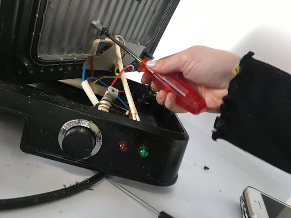

  4. Panini Iron Teardown, Upper heating plate: crwdns2935265:04crwdnd2935265:01crwdnd2935265:03crwdne2935265:0 Panini Iron Teardown, Upper heating plate: crwdns2935265:04crwdnd2935265:02crwdnd2935265:03crwdne2935265:0 Panini Iron Teardown, Upper heating plate: crwdns2935265:04crwdnd2935265:03crwdnd2935265:03crwdne2935265:0
    • After that, we can disconnect the wires and take the heat shield of the upper heating plate. The upper heating plate should be free now.

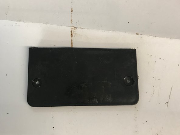

  5. Panini Iron Teardown, Bottom cover: crwdns2935265:05crwdnd2935265:01crwdnd2935265:02crwdne2935265:0 Panini Iron Teardown, Bottom cover: crwdns2935265:05crwdnd2935265:02crwdnd2935265:02crwdne2935265:0
    • Now that the top is entirely dismantled, we can continue with the bottom. Turn the product around and remove all the screws from the bottom cover (this is where you'll need the Tamper Proof Spanner). The cover of the electronics will fall off automatically.

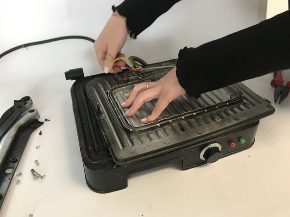

  6. Panini Iron Teardown, Lower heating plate: crwdns2935265:06crwdnd2935265:01crwdnd2935265:02crwdne2935265:0 Panini Iron Teardown, Lower heating plate: crwdns2935265:06crwdnd2935265:02crwdnd2935265:02crwdne2935265:0
    • Next, the lower heating plate can be unscrewed. There are some wires attached that can be seen when lifting it up from the bottom cover.

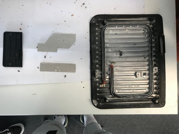

  7. Panini Iron Teardown, Heat shields: crwdns2935265:07crwdnd2935265:01crwdnd2935265:02crwdne2935265:0 Panini Iron Teardown, Heat shields: crwdns2935265:07crwdnd2935265:02crwdnd2935265:02crwdne2935265:0
    • From the heating plate, we are now able to unscrew the heat shields.
    • Take the rest of the screws out of the inside of the bottom cover. This allows for the heat shield to come out.
    • Now grab the iOpener and melt the glue around the wiring of the LEDs. This allows for the LEDs to come out.
    • What’s left now is the wiring in the bottom and the last heat shield. The wiring can be disconnected outside of the cover. There is little plastic parts attached, that can be taken off, after which the wires can be disconnected.

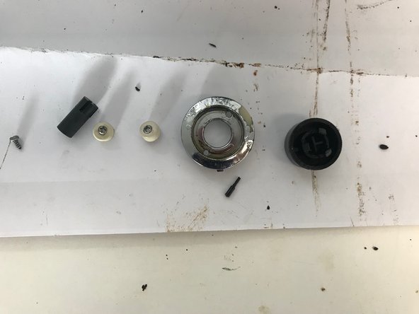

  8. Panini Iron Teardown, Buttons: crwdns2935265:011crwdnd2935265:01crwdnd2935265:02crwdne2935265:0 Panini Iron Teardown, Buttons: crwdns2935265:011crwdnd2935265:02crwdnd2935265:02crwdne2935265:0
    • The last step is to take out the button and the covers of the neon indicator's. They are attached with snapfits, so can be pushed out.
