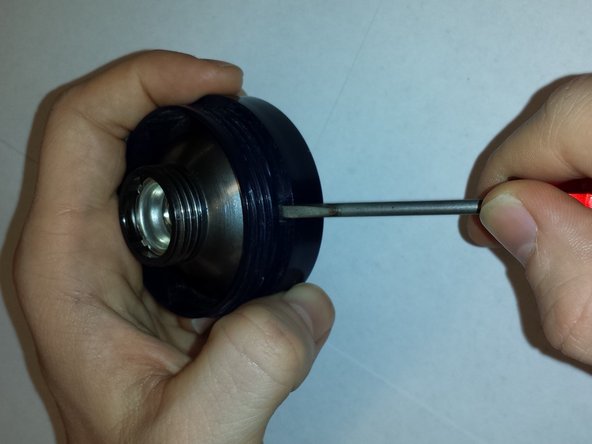

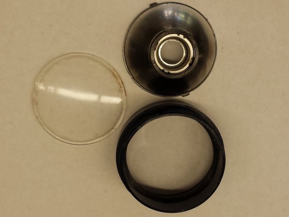

  4. Panasonic Super Lite Flashlight Teardown: crwdns2935265:04crwdnd2935265:01crwdnd2935265:03crwdne2935265:0 Panasonic Super Lite Flashlight Teardown: crwdns2935265:04crwdnd2935265:02crwdnd2935265:03crwdne2935265:0 Panasonic Super Lite Flashlight Teardown: crwdns2935265:04crwdnd2935265:03crwdnd2935265:03crwdne2935265:0
    • Remove the reflector by applying pressure to one of the two protruding plastic tabs using a small flathead screwdriver while pulling on the reflector.
    • The reflector should pop out; pull gently but firmly to avoid scattering the pieces. Remove the lens.
