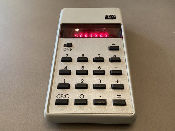

    • My Novus 750 was made in 1976 by National Semiconductor under the “Novus” brand name. It features a 6 character bubble LED screen, and the ability to do basic four function calculations. It also takes a standard 9 volt battery as well.

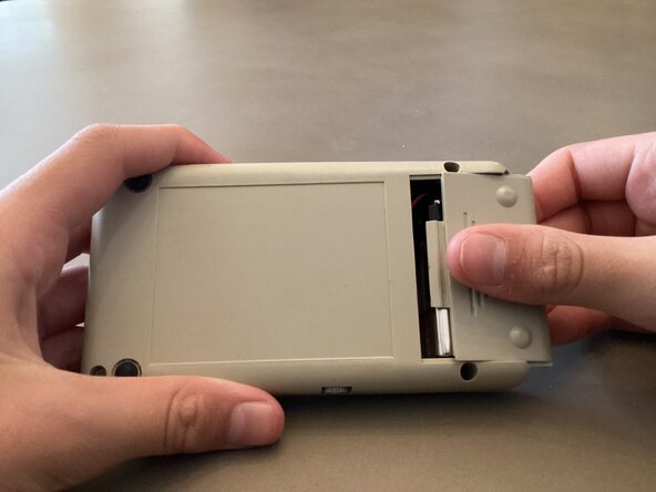

    • To begin disassembly, open the battery cover on the backside of the calculator. Next, disconnect the 9V battery from the connector.
