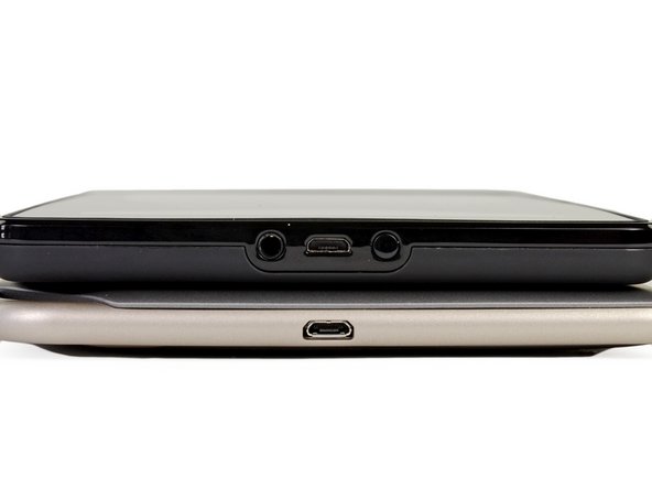

    • The Nook opted to have its micro-USB port fly solo on the bottom, unlike the Fire, which also placed its catch-all button and head phone jack alongside the port.
    • Hold that pose, fellas. Yep, just what we thought: the rounded sides of the Nook are deceptive. Even though it looks skinnier than the Fire, it's actually a hair pudgier. The Fire measures in at .45", but the Nook is .03 inches thicker, at a mind-blowing .48"!

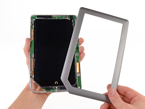

    • Removal of those sneaky screws and a little prying allow the case halves to be separated, revealing the battery and a large EMI shield.
    • A few twist of our Torx T5 and a bit more prying free the front bezel from a sticky situation.

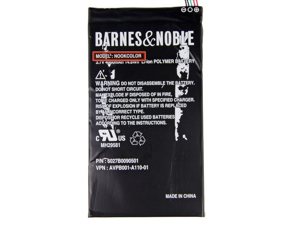

    • A pair of adhesive strips refuse to let the battery go. Fortunately, we at iFixit are masters of removal.
    • The 3.7 V, 4000 mAh battery provides an advertised 11.5 hours of reading time, which easily beats the Kindle Fire's 8 hours.
    • Even though the battery says the model is "NOOKCOLOR," the Nook Tablet's battery life is 3.5 hours longer than that of the Nook Color.

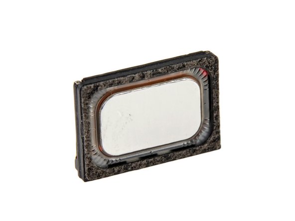

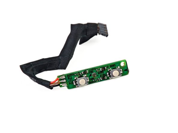

    • A bit more digging and we were able to unearth the following components:
    • Power button assembly
    • Volume buttons assembly
    • A lonely speaker assembly

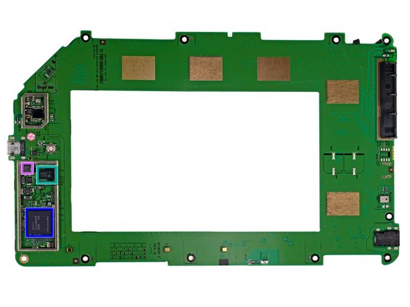

    • A little wiggling and out comes the picture frame motherboard. Let's see who we're dealing with:
    • SanDisk SDIN5C1-16G 16 GB Flash Memory
    • Texas Instruments 6030B107 Fully Integrated Power Management IC
    • Texas Instruments AIC3100 Low-Power Audio Codec With 1.3 W Stereo Class-D Speaker Amplifier
    • Texas Instruments LVDS83B FlatLink 10-135 MHz Transmitter
    • Hynix H9TKNNN8P 1 GB DDR2 RAM
    • This chip likely covers the Texas Instruments OMAP4 1 GHz dual-core processor, just like the Kindle Fire.
    • Kionix KXTF9 Tri-Axis Accelerometer

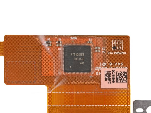

    • The display in all its squid-like glory. Only one of its appendages catches our eyes though.
    • A closer look at one of the ribbon cables reveals a FocalTech FT5406EE8 Capacitive Touch Panel Controller.

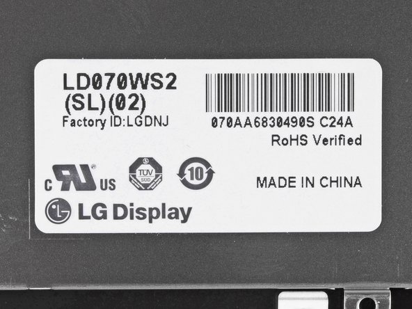

  10. Nook Tablet Teardown: crwdns2935265:010crwdnd2935265:01crwdnd2935265:02crwdne2935265:0 Nook Tablet Teardown: crwdns2935265:010crwdnd2935265:02crwdnd2935265:02crwdne2935265:0
    • The label on the display ribbon cables and on the back of the display indicate that it was manufactured by LG.
    • The Nook Tablet's 7" IPS display runs at a resolution of 1024 x 600 pixels and produces 16 million colors, just like the Kindle Fire.

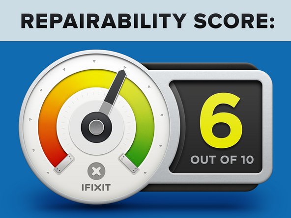

    • Nook Tablet Repairability Score: 6 out of 10 (10 is easiest to repair).
    • The LCD is not fused to the front panel assembly, making replacement easy, if necessary.
    • Hidden screws prevent removal of rear panel.
    • Excessive amount of adhesive and adhesive strips make disassembly a painfully tedious process.
    • Replacing the battery requires removing the motherboard as well as some serious prying.
    • Components such as the headphone jack, microSD slot, etc. are soldered to the motherboard.
