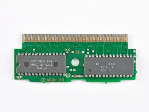

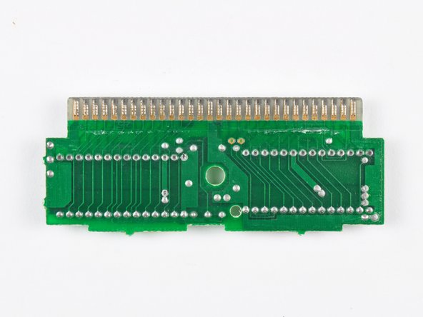

  11. Nintendo Family Computer (Famicom) Teardown: crwdns2935265:011crwdnd2935265:01crwdnd2935265:03crwdne2935265:0 Nintendo Family Computer (Famicom) Teardown: crwdns2935265:011crwdnd2935265:02crwdnd2935265:03crwdne2935265:0 Nintendo Family Computer (Famicom) Teardown: crwdns2935265:011crwdnd2935265:03crwdnd2935265:03crwdne2935265:0
    • Breaking Gently releasing the retaining clips holding the cartridge together reveals a 60 pin printed circuit board.
    • Front and back sides of the Famicom cartridges:
    • This PCB from a Tennis cartridge has two ROM packages -- totaling 24 KB -- soldered to one side.
    • For comparison, a single layer Blu-ray disc has a 25,000,000 KB capacity.
