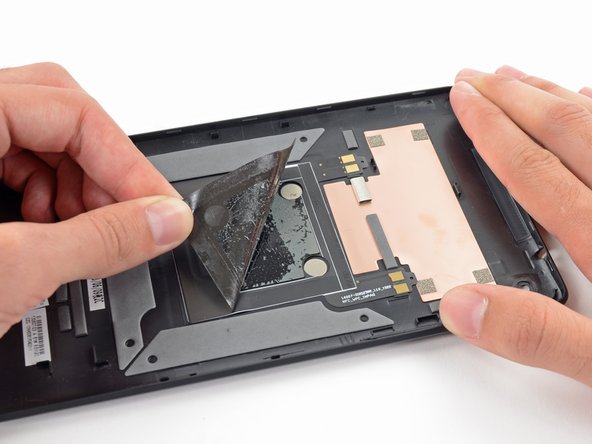

    • But wait! There's more? An inductive charging coil?
    • Hats off to the great Tesla, forefather of wireless charging.
    • Although inductive charging has been around for a while, this is the first time we've seen it in a tablet since the HP TouchPad. We're pleased with the trend, as it may help eliminate wires as a source of e-waste in the future. Now, if we could only make batteries infinitely rechargable...
    • The NFC Module is layered on top of the inductive charging coil.

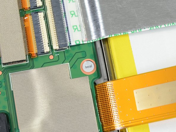

    • Time to set our trusty connector-seeking spudger loose to free the battery from its bonds.
    • Seals cover two of the screws in the Nexus 7—one on each of the main boards—so replacing either board will likely void your warranty.
    • We consulted Seal seal, our seal expert, and gave us the seal of approval to proceed. He concluded that our teardown was more important than our warranty.

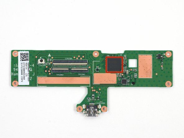

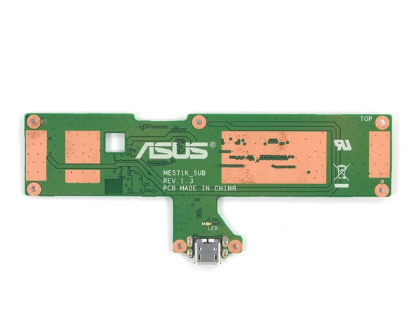

    • It's time for the daughterboard to leave the nest; seals can't hold her captive forever. The board houses a single IC nested among the connectors.
    • ELAN eKTH325BAWS, which we guess to be the capacitive touchpad controller from ELAN's eKT line.

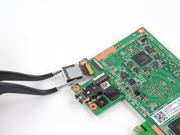

    • Flushed with teardown fever, we pluck the motherboard from the casing, as well.
    • The front- and rear-facing cameras are easy pickings.
    • Alas, consumers will still be able to take awkward tablet photos. Will it ever end?
    • If you happen to see bigfoot and need to take a picture with your new Nexus 7, you'll be getting a 5 MP image.
    • For selfies, you only get 1.2 MP.

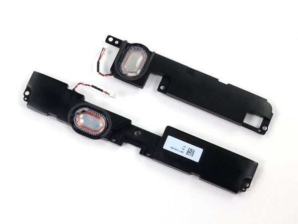

    • The updated speakers come out next.
    • What do we know about these speakers?
    • They're stereo.
    • They sound cool.
    • They are labeled DN17128L000.
