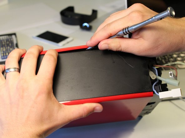

    • The CitiZ is a compact coffee-making gizmo. Opening it requires a proprietary tool that Nespresso doesn't sell. But iFixit has the answer: just use our oval head bit! They want to keep us out of our own machines!
    • You can even create your own specialty tool.
    • You can get into it with a pair of needle-nose pliers. The pliers I used aren't ideal — you want something that can get into the recessed slots.

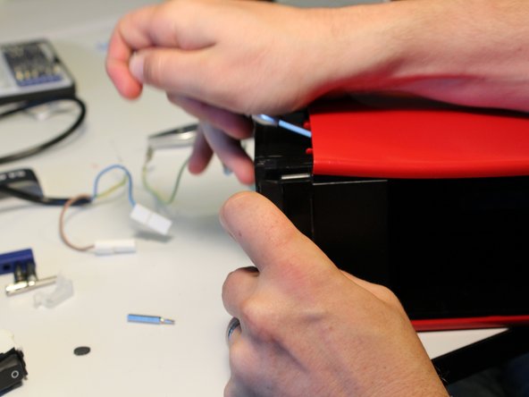

    • Now that the screws are removed, use a screwdriver or a spudger to pry the tabs holding the bottom case on.
    • The easiest place to get in is the power plug. Be careful not to nick it. (And make sure you're unplugged from the wall!)

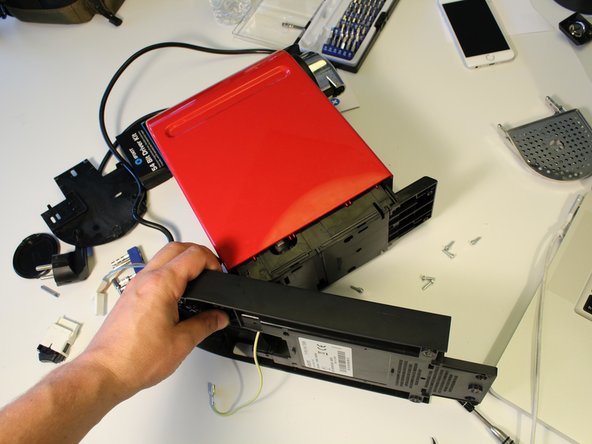

  4. Nespresso CitiZ Teardown: crwdns2935265:04crwdnd2935265:01crwdnd2935265:01crwdne2935265:0
    • Carefully open the lower case and set the machine on its side.
  5. Nespresso CitiZ Teardown: crwdns2935265:05crwdnd2935265:01crwdnd2935265:01crwdne2935265:0

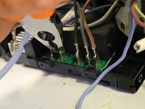

    • Nespresso makes heavy use of spade connectors inside this machine.
    • Grab one side firmly with your pliers and pull on the other side of the connector with your fingers. Do not pull on the cable, because you can pull it free from the spade connector.

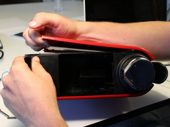

    • Removing the outer shell requires some force.
    • There are a series of tabs on all four sides of the shell.
    • Start by using a flathead screwdriver or spudger to pop the first tab.
    • Work your way around the case, freeing tabs as you go.
  12. Nespresso CitiZ Teardown: crwdns2935265:012crwdnd2935265:01crwdnd2935265:03crwdne2935265:0 Nespresso CitiZ Teardown: crwdns2935265:012crwdnd2935265:02crwdnd2935265:03crwdne2935265:0 Nespresso CitiZ Teardown: crwdns2935265:012crwdnd2935265:03crwdnd2935265:03crwdne2935265:0
    • Keep prying!

  23. Nespresso CitiZ Teardown: crwdns2935265:023crwdnd2935265:01crwdnd2935265:02crwdne2935265:0 Nespresso CitiZ Teardown: crwdns2935265:023crwdnd2935265:02crwdnd2935265:02crwdne2935265:0
    • Power cables, from left to right: heat (white), neutral (blue), pump (dark grey), pump ground? (light grey), line (brown).
    • Disconnect each cable with your pliers.

A tool or a bit for those oval-head screws can often be bought at suppliers for coffee automates e.g. branded "Jura", "AEG", "Siemens", "Krups"
