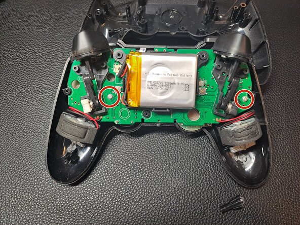

  3. Nacon Asymmetric Wireless PS4 Controller Teardown, Remove screws holding board to shell: crwdns2935265:03crwdnd2935265:01crwdnd2935265:01crwdne2935265:0
    • There are 2 screws securing the board to the top shell cover. Again, you’ll need the J00 screw bit for these.
    • Be careful when lifting, as there are ribbon cables and rumble electric motors attached.

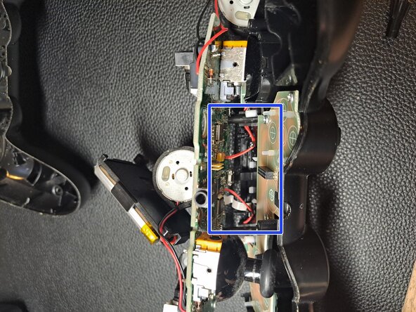

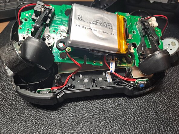

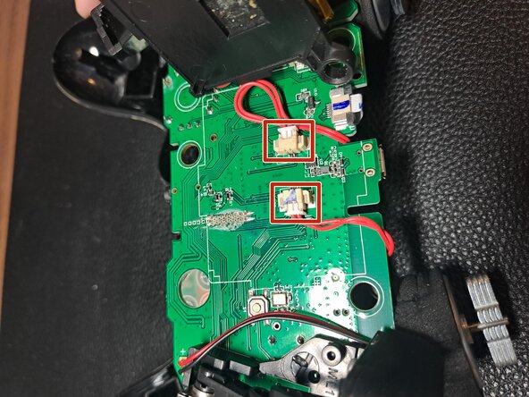

  4. Nacon Asymmetric Wireless PS4 Controller Teardown, Remove the bumper ribbons: crwdns2935265:04crwdnd2935265:01crwdnd2935265:03crwdne2935265:0 Nacon Asymmetric Wireless PS4 Controller Teardown, Remove the bumper ribbons: crwdns2935265:04crwdnd2935265:02crwdnd2935265:03crwdne2935265:0 Nacon Asymmetric Wireless PS4 Controller Teardown, Remove the bumper ribbons: crwdns2935265:04crwdnd2935265:03crwdnd2935265:03crwdne2935265:0
    • Before lifting the board off the top of the shell, remove the ribbon cables. They are tucked into plastic clips and plugged into the main board.
    • Lift and move the battery to access and disconnect the left and right bumper button ribbon cables from the main board.
    • Be careful, as these cables can easily break.

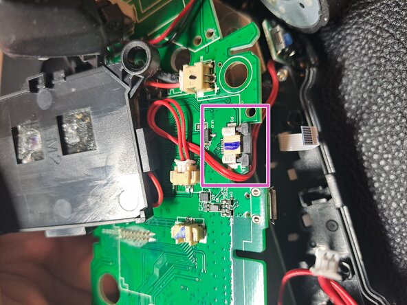

  5. Nacon Asymmetric Wireless PS4 Controller Teardown, Remove the second ribbon cable: crwdns2935265:05crwdnd2935265:01crwdnd2935265:01crwdne2935265:0
    • To remove the last ribbon cable, pull the black plastic tab outward (towards you) to release the ribbon cable.

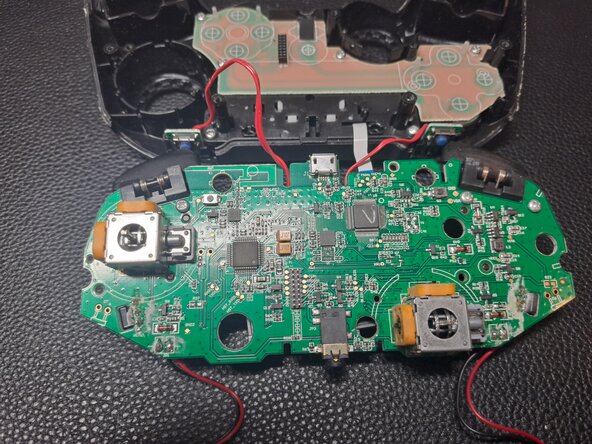

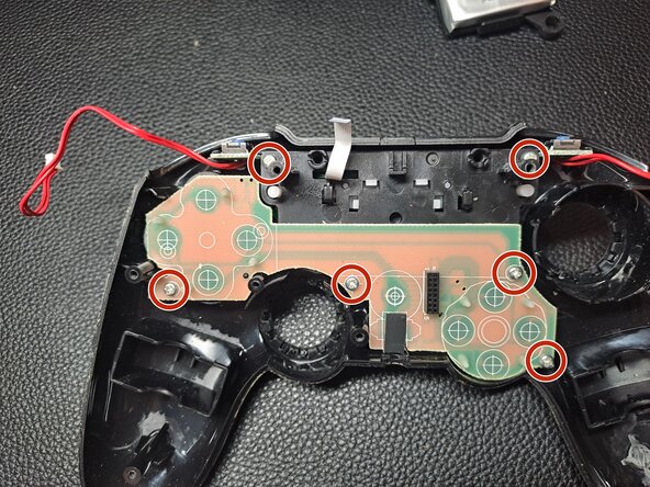

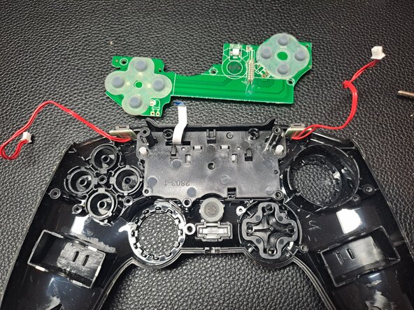

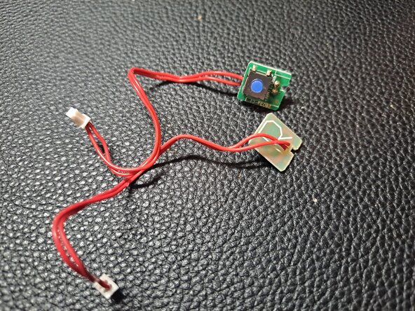

  6. Nacon Asymmetric Wireless PS4 Controller Teardown, Unscrew the board holding the buttons: crwdns2935265:06crwdnd2935265:01crwdnd2935265:03crwdne2935265:0 Nacon Asymmetric Wireless PS4 Controller Teardown, Unscrew the board holding the buttons: crwdns2935265:06crwdnd2935265:02crwdnd2935265:03crwdne2935265:0 Nacon Asymmetric Wireless PS4 Controller Teardown, Unscrew the board holding the buttons: crwdns2935265:06crwdnd2935265:03crwdnd2935265:03crwdne2935265:0
    • There are 4 screws on the board that need to be removed to access the buttons. There are also 2 screws securing the touchpad in the controller. Again, you can use the J00 screw bit.
    • To remove the smaller bumper boards, simply pull them off.

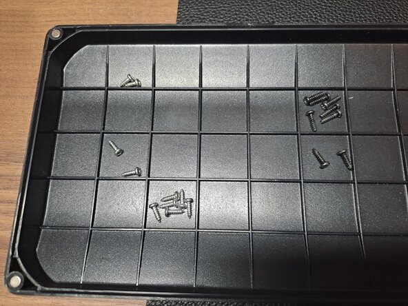

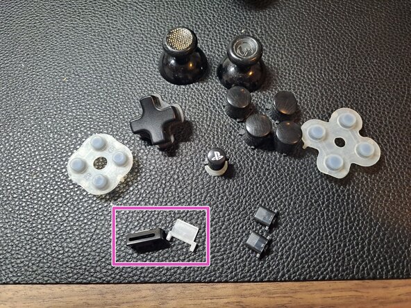

  7. Nacon Asymmetric Wireless PS4 Controller Teardown, The screws and buttons: crwdns2935265:07crwdnd2935265:01crwdnd2935265:02crwdne2935265:0 Nacon Asymmetric Wireless PS4 Controller Teardown, The screws and buttons: crwdns2935265:07crwdnd2935265:02crwdnd2935265:02crwdne2935265:0
    • These are all the buttons and button membranes.
    • The parts inside the pink square are the light and its housing.
    • And the screws that belong to the device.
