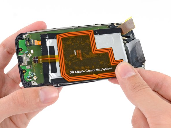

  8. Motorola Moto X Teardown: crwdns2935265:08crwdnd2935265:01crwdnd2935265:03crwdne2935265:0 Motorola Moto X Teardown: crwdns2935265:08crwdnd2935265:02crwdnd2935265:03crwdne2935265:0 Motorola Moto X Teardown: crwdns2935265:08crwdnd2935265:03crwdnd2935265:03crwdne2935265:0
    • "We'll just wrestle this battery off here…Or not."
    • Time to chase down the end of the NFC antenna ribbon cable.
    • We interrogate the antenna assembly about the whereabouts of the cable's end. Nothing like a 54 Bit Driver Kit to encourage stubborn hardware.
    • Eureka! Adios, battery!

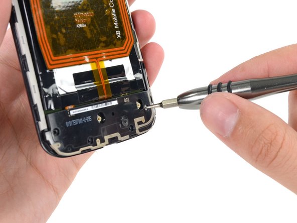

  10. Motorola Moto X Teardown: crwdns2935265:010crwdnd2935265:01crwdnd2935265:03crwdne2935265:0 Motorola Moto X Teardown: crwdns2935265:010crwdnd2935265:02crwdnd2935265:03crwdne2935265:0 Motorola Moto X Teardown: crwdns2935265:010crwdnd2935265:03crwdnd2935265:03crwdne2935265:0
    • Out comes the upper midframe panel, housing the speaker, headphone jack, more antennas, and pressure contacts.
    • Yay, pressure contacts! We like spring pressure contacts because they don't require any work to disconnect.
    • This is possibly the most modular headphone jack we've ever seen. It pops right out of the upper midframe panel, spring contacts and all.

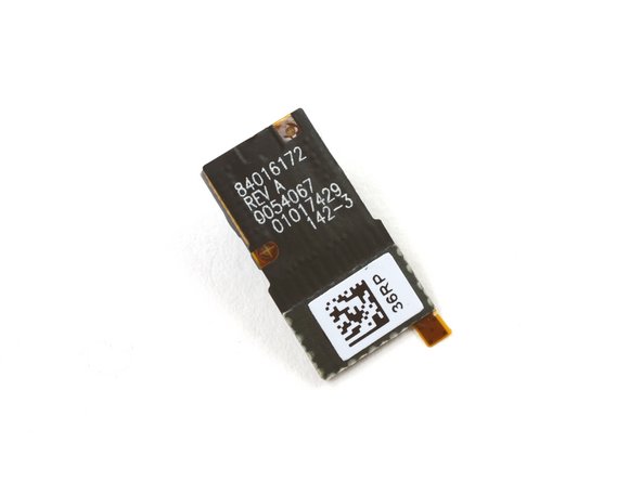

  12. Motorola Moto X Teardown: crwdns2935265:012crwdnd2935265:01crwdnd2935265:03crwdne2935265:0 Motorola Moto X Teardown: crwdns2935265:012crwdnd2935265:02crwdnd2935265:03crwdne2935265:0 Motorola Moto X Teardown: crwdns2935265:012crwdnd2935265:03crwdnd2935265:03crwdne2935265:0
    Precision Tweezers Set
    $9.95
    • After selecting our favorite pair of precision tweezers, we remove the 2 MP front-facing camera from the Moto X.
    • The front-facing camera is labeled as 84016172 REV A 0054067 01017429 142-3.

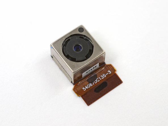

    • Before we can fully examine the motherboard, though, we must remove the 10 megapixel rear-facing camera.
    • 10 MP is 25% more pixels than the camera in the iPhone 5, but isn't quite on the Lumia 1020's level, though we can hardly fault it for that.

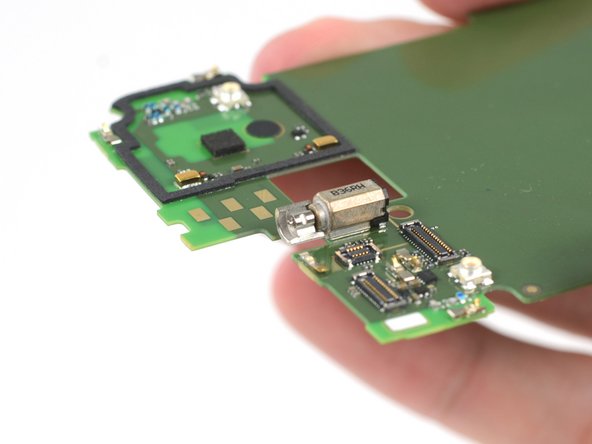

    • The back of the motherboard may look bare, but upon closer inspection we found two microphones:
    • Wolfson Microelectronics WM7121 Top Port Analogue Silicon Microphone
    • Wolfson Microelectronics WM7132 Bottom Port Analogue Silicon Microphone
    • Motoroogle again shows off its novelty; the X's vibrator motor is soldered right to the motherboard. The wonders never cease.

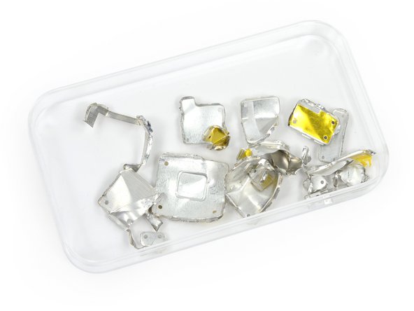

    • Like any good warrior, we hold onto the ears EMI shields of our enemies.
