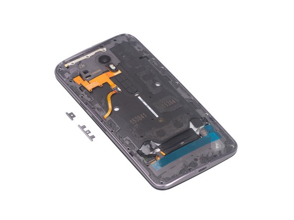

    • Remove metal bar securing side buttons, careful of the extremely tiny springs that provide pressure from the frame to the buttons, then be free to remove side buttons.
    • Remove middle frame bezel.

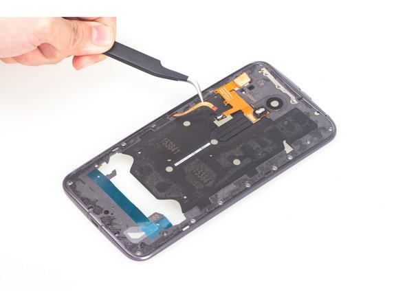

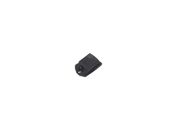

    • There is no adhesive sticking headphone jack, just use tweezers to remove it.
    • Then peel off the NFC antenna.

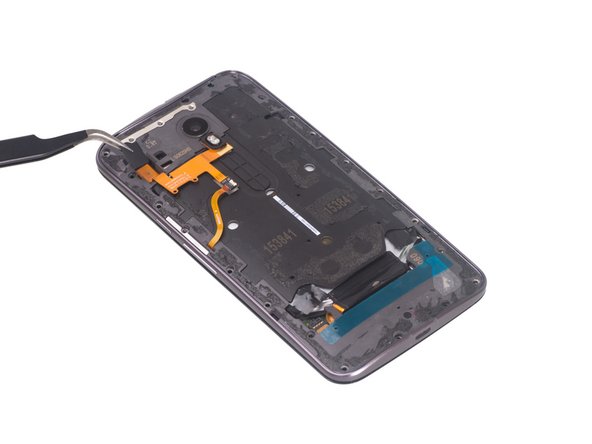

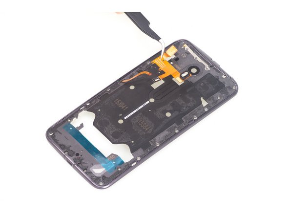

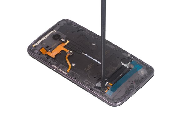

    • Release flashlight flex connector connecting side button flex.
    • Take away flashlight flex.
  9. Motorola Moto X Style (Moto X Pure Edition) Teardown: crwdns2935265:09crwdnd2935265:01crwdnd2935265:02crwdne2935265:0 Motorola Moto X Style (Moto X Pure Edition) Teardown: crwdns2935265:09crwdnd2935265:02crwdnd2935265:02crwdne2935265:0

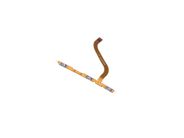

    • Pry up and remove power&volume button flex.

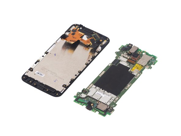

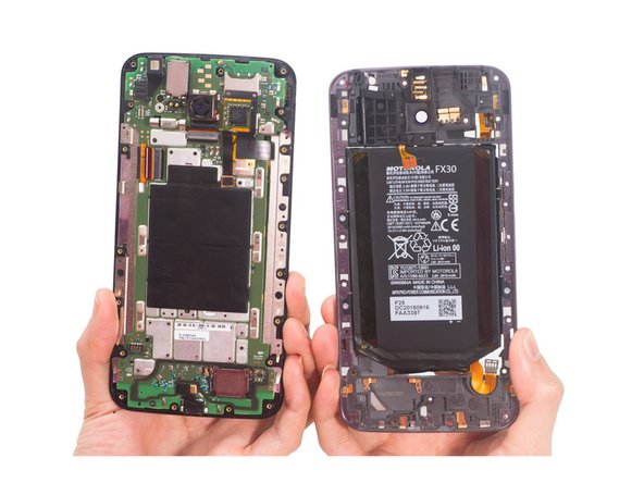

    • Twist off one Torx T3 screw securing motherboard.
    • Release the LCD screen connector here.
  11. Motorola Moto X Style (Moto X Pure Edition) Teardown: crwdns2935265:011crwdnd2935265:01crwdnd2935265:02crwdne2935265:0 Motorola Moto X Style (Moto X Pure Edition) Teardown: crwdns2935265:011crwdnd2935265:02crwdnd2935265:02crwdne2935265:0
    • Release this connector.
    • Separate motherboard assembly from LCD screen assembly.

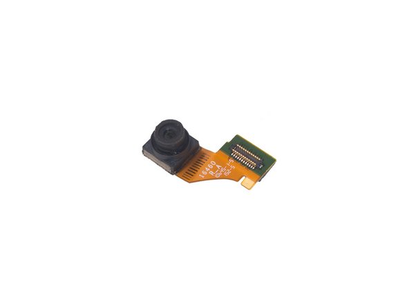

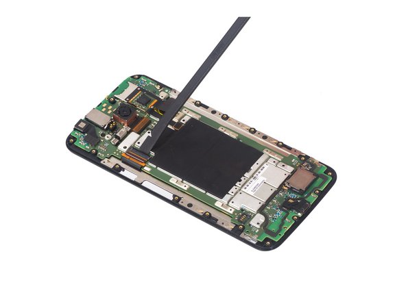

    • Release front camera flex and remove it.
  13. Motorola Moto X Style (Moto X Pure Edition) Teardown: crwdns2935265:013crwdnd2935265:01crwdnd2935265:02crwdne2935265:0 Motorola Moto X Style (Moto X Pure Edition) Teardown: crwdns2935265:013crwdnd2935265:02crwdnd2935265:02crwdne2935265:0

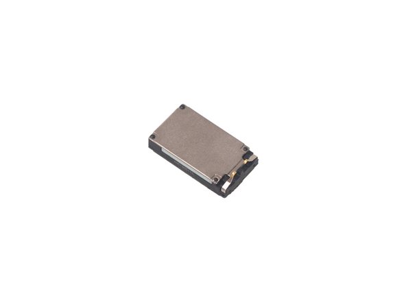

    • There is adhesive underneath. Pry up and then remove top speaker.

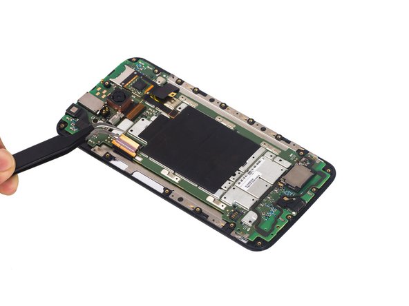

    • Peel off protective tape on the rear camera.
    • Release rear camera flex and then remove the camera.

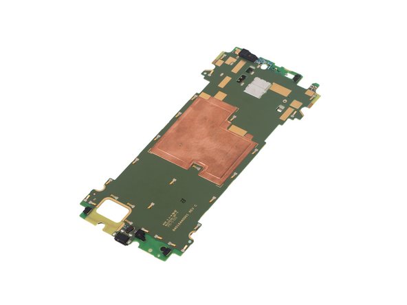

    • Pry up and remove loudspeaker.
    • Now it leaves the motherboard assembly with some parts like charing port and vibration motor.

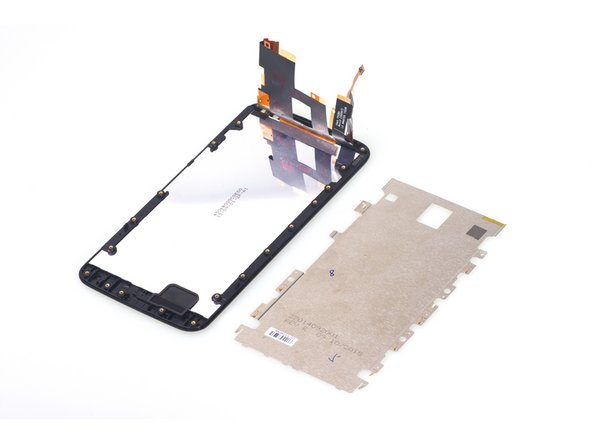

    • Remove the LCD shield easily.
    • Finally it leaves the LCD screen with digitizer and front housing.
    • It is better to replace Moto X Style LCD screen and digitizer assembly and front housing together, if you have no confidence to remove it without breaking the screen during the repair work.
