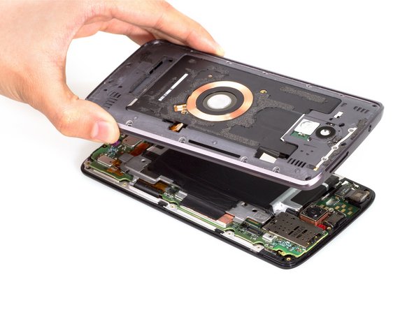

  4. Motorola Moto X Force Teardown, Remove middle frame.: crwdns2935265:04crwdnd2935265:01crwdnd2935265:03crwdne2935265:0 Motorola Moto X Force Teardown, Remove middle frame.: crwdns2935265:04crwdnd2935265:02crwdnd2935265:03crwdne2935265:0 Motorola Moto X Force Teardown, Remove middle frame.: crwdns2935265:04crwdnd2935265:03crwdnd2935265:03crwdne2935265:0
    • Twist off 17 screws by T3 Torx screwdriver.
    • Take away rubber bracket securing NFC antenna and release NFC antenna connector.

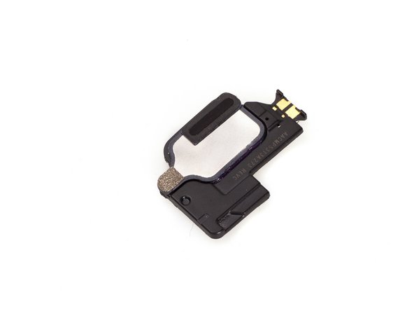

  11. Motorola Moto X Force Teardown, Remove loudspeaker.: crwdns2935265:011crwdnd2935265:01crwdnd2935265:02crwdne2935265:0 Motorola Moto X Force Teardown, Remove loudspeaker.: crwdns2935265:011crwdnd2935265:02crwdnd2935265:02crwdne2935265:0
    • Pry this part up.

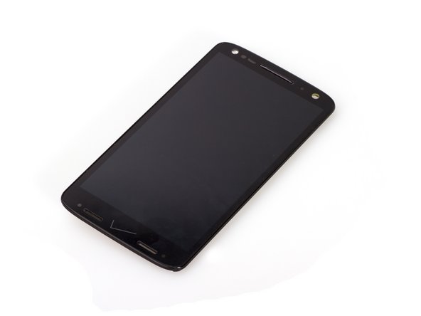

  24. Motorola Moto X Force Teardown: crwdns2935265:024crwdnd2935265:01crwdnd2935265:02crwdne2935265:0 Motorola Moto X Force Teardown: crwdns2935265:024crwdnd2935265:02crwdnd2935265:02crwdne2935265:0
    • Here is LCD screen with LCD supporting frame. They are attached tightly, so we haven't separate them.
