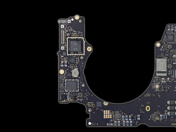

  9. MacBook Pro 15" Touch Bar Teardown: crwdns2935265:09crwdnd2935265:01crwdnd2935265:01crwdne2935265:0
    • Other chips jockeying for position on this side of the board:
    • Samsung K4E4E324EE-PGCF 512 MB LPDDR3 DRAM, likely with a custom Apple-made SSD controller layered beneath
    • Samsung K9PHGY8S7E-1CK0 flash storage (two 64 GB chips for 128 GB on this side)
    • Renesas R4F2113XLG H8S/2113 family microcontroller
    • Texas Instruments TM4EA23I ? system management controller
    • Texas Instruments SN650839 Power Management
    • NXP Semiconductor PN66V NFC controller
    • Texas Instruments TMP442 dual remote/local temperature sensor

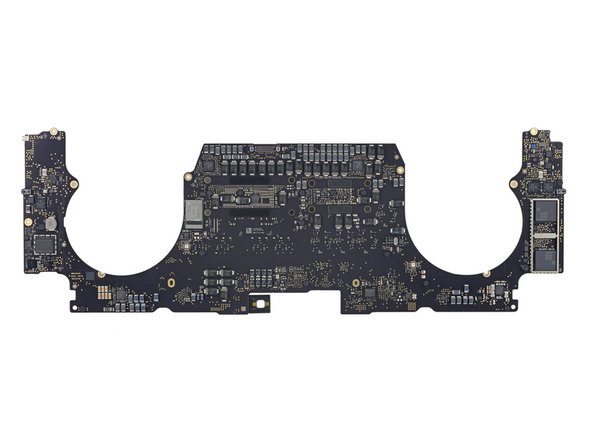

  10. MacBook Pro 15" Touch Bar Teardown: crwdns2935265:010crwdnd2935265:01crwdnd2935265:02crwdne2935265:0 MacBook Pro 15" Touch Bar Teardown: crwdns2935265:010crwdnd2935265:02crwdnd2935265:02crwdne2935265:0
    • Taking a look at the flip-side of the logic board, we find:
    • Samsung K9PHGY8S7E-1CK0 flash storage (two more 64 GB chips for 128 GB on this side and 256 GB total)
    • Texas Instruments CD3215C00 USB type-C power delivery controller
    • Winbond SpiFlash W25Q64FVIQ 64 Mb serial flash memory
    • Texas Instruments TPS51980A synchronous buck controller
    • Renesas (formerly Intersil) ISL95828HRTZ CPU PWM controller
    • Intersil ISL6277 AMD CPU PWM controller
    • Apple APL1023 343S00137 (the same chip appeared in our teardown of the MBP 13" Touch Bar, and is very likely the T1 controller that runs the Touch Bar)

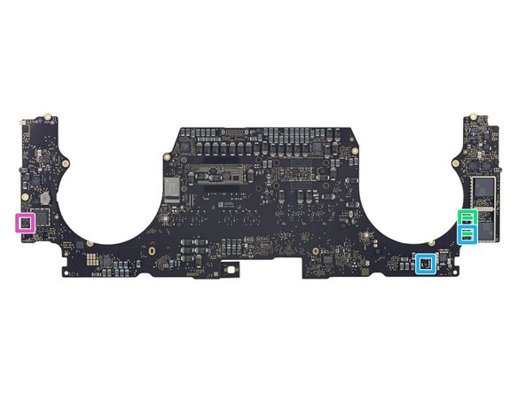

  12. MacBook Pro 15" Touch Bar Teardown: crwdns2935265:012crwdnd2935265:01crwdnd2935265:02crwdne2935265:0 MacBook Pro 15" Touch Bar Teardown: crwdns2935265:012crwdnd2935265:02crwdnd2935265:02crwdne2935265:0
    • IC Identification, continued pt. 1:
    • Cirrus Logic audio codec (CS42Lxx) and audio amplifier (likely)
    • Maxim Integrated MAXxxxx ? audio amplifier (likely)
    • NXP Semiconductor CBTL06142E DisplayPort/PCI Express multiplexer (likely)
    • Vishay SIC635 power stage
    • Vishay SIC535 power stage
    • Diodes Incorporated IRF3575 60 A power block
    • Other power stages/MOSFETs mostly by Texas Instruments

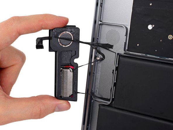

  17. MacBook Pro 15" Touch Bar Teardown: crwdns2935265:017crwdnd2935265:01crwdnd2935265:03crwdne2935265:0 MacBook Pro 15" Touch Bar Teardown: crwdns2935265:017crwdnd2935265:02crwdnd2935265:03crwdne2935265:0 MacBook Pro 15" Touch Bar Teardown: crwdns2935265:017crwdnd2935265:03crwdnd2935265:03crwdne2935265:0
    • After recently struggling to free the strongly adhered battery in the 13" MacBook Pro with Touch Bar, we decided to let this battery remain glued in its home.
    • Does that make us lazy? Maybe... But we were still able to determine that this six cell battery offers a total of 11.40 V, and has a power rating of 76.0 Wh.
    • This 15" MacBook Pro has a similar speaker grille when compared to its smaller 13" counterpart. Most of the grille doesn't include full through-holes, prompting us to question why the dimples, Apple?
    • Survey says: weight savers so it goes faster when you put wheels on it.
