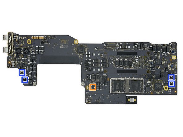

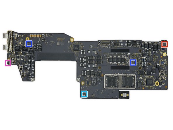

  16. MacBook Pro 13" Function Keys Late 2016 Teardown: crwdns2935265:017crwdnd2935265:01crwdnd2935265:02crwdne2935265:0 MacBook Pro 13" Function Keys Late 2016 Teardown: crwdns2935265:017crwdnd2935265:02crwdnd2935265:02crwdne2935265:0
    • IC identification, pt. 2:
    • Texas Instruments TPS51980A 2-phase step-down controller
    • Renesas (formerly Intersil) ISL9239 battery charger
    • Texas Instruments TPS51916 DDR memory power management
    • Vishay SiC635 power stage
    • Vishay SiC532 30 A power stage
    • Analog Devices SSM3515B 31 W Class-D audio amplifier
    • Texas Instruments (formerly National Semiconductor) LP8548B1 backlight driver
  17. MacBook Pro 13" Function Keys Late 2016 Teardown: crwdns2935265:018crwdnd2935265:01crwdnd2935265:02crwdne2935265:0 MacBook Pro 13" Function Keys Late 2016 Teardown: crwdns2935265:018crwdnd2935265:02crwdnd2935265:02crwdne2935265:0
    • IC identification, pt. 3:
    • Texas Instruments TMP513A triple remote/local temperature sensor
    • Winbond W25Q80DVUXIE 8 Mb serial NOR flash memory
    • Winbond W25X20CLUXIG 2 Mb serial NOR flash memory
    • Microchip (formerly Atmel) AT93C66B 4 Kb serial EEPROM memory
    • Maxim Integrated MAX77596 300 mA buck converter
    • Texas Instruments TPS22966 6 A load switch
    • Likely hall sensor

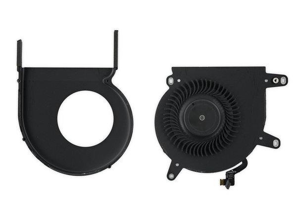

    • Before we hit Retina, we scrape out a fancy fan. These blades are supposedly super quiet due to their asymmetrically spaced blades.
    • Interestingly enough, while Jony Ive was jazzed about "thinner, variably spaced fan blades," this tech has been included in certain MacBook Pro models since 2012.
    • There's also a significant amount of space not taken up by blades—that's probably another sick thermal system feature. Plus it looks nice in the video.
    • Likely a Texas Instruments motor controller on the fan flex cable

So, no dual-fan thermal architecture for the non-touchbar version
ant0225 - crwdns2934203:0crwdne2934203:0
This version (non touchbar) is also using TDP 15W CPUs. The 13" one with touchbar is using TDP 28W CPUs (and has probably two fans).
therealmarv -
@chenyu apple's press renders and product site show the 13 inch mb pro with 2 fans
friendsrock80 -
Dual fan is found on the 13" MacBook pro with a touch bar becuase the TDP on the CPU is much higher. (28W). It's also in the 15" MacBook Pro with an 80W TDP, and bigger heat pipes.
Finally, It's a bit sad that you guys didn't compare this year's heat sinks to last years. Do some flow rate testing on the fans, and give us dimensions and weight of the heat sinks from last year to this year. Without making any proper measurements, you cannot make *any* claims about the thermal system being "advanced" or not.
