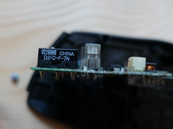

  7. Logitech VX Revolution Teardown, The PCB Board: crwdns2935265:07crwdnd2935265:01crwdnd2935265:02crwdne2935265:0 Logitech VX Revolution Teardown, The PCB Board: crwdns2935265:07crwdnd2935265:02crwdnd2935265:02crwdne2935265:0
    • Backside of the PCB. The markings illustrate the positions of the mouse buttons (type D2FC-F-7N).
    • Contacts for the right mouse button. Desolder if neccessary.
    • Contacts for the left mouse button. Desolder if neccessary.
