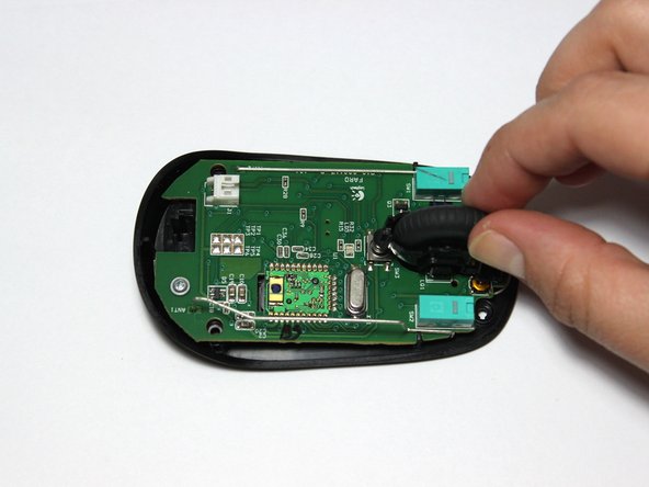

  6. Logitech V220 - Cordless Optical Mouse Teardown, Removing the Scroll Wheel: crwdns2935265:06crwdnd2935265:01crwdnd2935265:03crwdne2935265:0 Logitech V220 - Cordless Optical Mouse Teardown, Removing the Scroll Wheel: crwdns2935265:06crwdnd2935265:02crwdnd2935265:03crwdne2935265:0 Logitech V220 - Cordless Optical Mouse Teardown, Removing the Scroll Wheel: crwdns2935265:06crwdnd2935265:03crwdnd2935265:03crwdne2935265:0
    • Locate the one, scroll wheel, #0 Phillips screw near the very front edge of the mouse.
    • Turn the mouse 90 degrees clockwise.
    • While supporting the rear of the mouse base, unscrew the #0 Phillips scroll wheel screw.
    • Once the scroll wheel screw is fully removed, manually extract the scroll wheel and spring assembly.

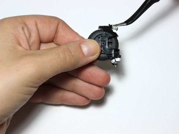

  7. Logitech V220 - Cordless Optical Mouse Teardown, Removing the Scroll Wheel Spring: crwdns2935265:07crwdnd2935265:01crwdnd2935265:02crwdne2935265:0 Logitech V220 - Cordless Optical Mouse Teardown, Removing the Scroll Wheel Spring: crwdns2935265:07crwdnd2935265:02crwdnd2935265:02crwdne2935265:0
    • Locate the scroll wheel spring.
    • Use the tweezers to gently remove the spring by slowly tugging the spring away from the scroll wheel assembly.
  8. Logitech V220 - Cordless Optical Mouse Teardown, Removing the Circuit Board: crwdns2935265:08crwdnd2935265:01crwdnd2935265:03crwdne2935265:0 Logitech V220 - Cordless Optical Mouse Teardown, Removing the Circuit Board: crwdns2935265:08crwdnd2935265:02crwdnd2935265:03crwdne2935265:0 Logitech V220 - Cordless Optical Mouse Teardown, Removing the Circuit Board: crwdns2935265:08crwdnd2935265:03crwdnd2935265:03crwdne2935265:0
    • Locate and remove the circuit board screw.
    • Grip the edges of the circuit board.
    • Manually remove the circuit board from the base of the mold housing.
