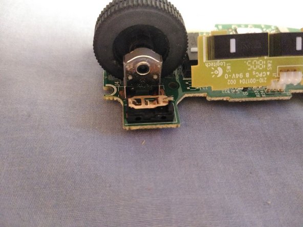

  4. Logitech G Pro Gaming Mouse Teardown/Solve double clicking issue, Working on the click button: crwdns2935265:04crwdnd2935265:01crwdnd2935265:03crwdne2935265:0 Logitech G Pro Gaming Mouse Teardown/Solve double clicking issue, Working on the click button: crwdns2935265:04crwdnd2935265:02crwdnd2935265:03crwdne2935265:0 Logitech G Pro Gaming Mouse Teardown/Solve double clicking issue, Working on the click button: crwdns2935265:04crwdnd2935265:03crwdnd2935265:03crwdne2935265:0
    • Now we focus on the malfunctioning button. Either the right or left click although the method works properly for any button which uses the same Omron switches

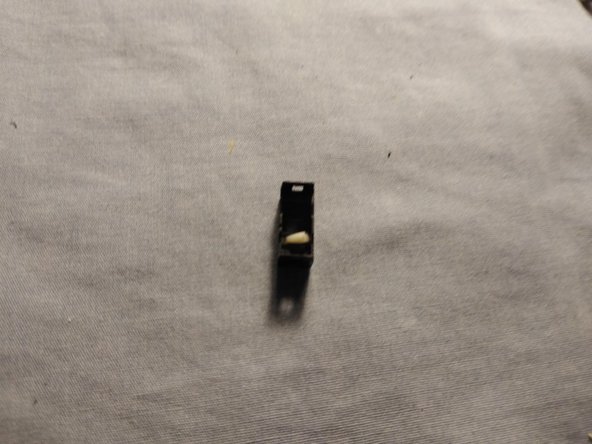

    • These have a plastic cap which covers the metal mechanical mechanism. We have to take it of and leave the bronze metal piece uncovered. I used a thin blade to perform the latter.
    • Be careful not to brake the plastic cap while doing this step and be aware of the small white piece which is vital to complete the clicking process.

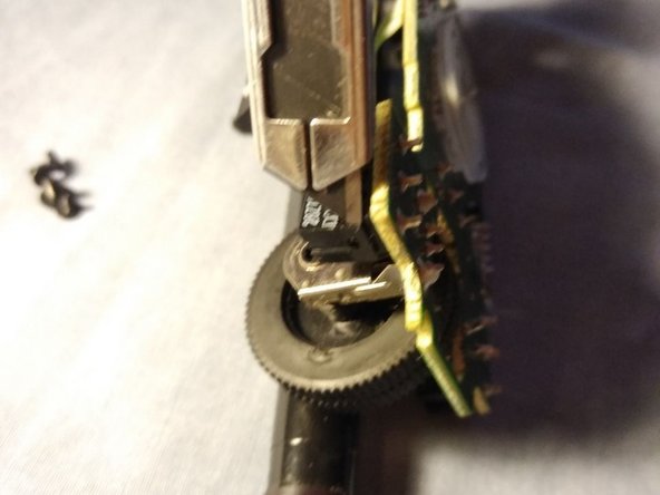

  5. Logitech G Pro Gaming Mouse Teardown/Solve double clicking issue, Fixing the plate: crwdns2935265:05crwdnd2935265:01crwdnd2935265:01crwdne2935265:0
    • The issue is often caused due to having an overflattened metal plate. Push the small bending in the plate until you leave it as the one in the image.
    • Now we have to install back the metal plate. A small twissers become handy for this although you can do it without ones
