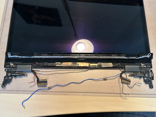

  1. Lenovo ThinkPad X1 Yoga Display Assembly Teardown, Introduction: crwdns2935265:01crwdnd2935265:01crwdnd2935265:03crwdne2935265:0 Lenovo ThinkPad X1 Yoga Display Assembly Teardown, Introduction: crwdns2935265:01crwdnd2935265:02crwdnd2935265:03crwdne2935265:0 Lenovo ThinkPad X1 Yoga Display Assembly Teardown, Introduction: crwdns2935265:01crwdnd2935265:03crwdnd2935265:03crwdne2935265:0
    • Here we have the screen as just removed from our Thinkpad.
    • In the lower corners you will find two rubber caps with hidden screws.
    • Remove the caps and unscrew the first screw.
  2. Lenovo ThinkPad X1 Yoga Display Assembly Teardown, Display screws: crwdns2935265:02crwdnd2935265:01crwdnd2935265:03crwdne2935265:0 Lenovo ThinkPad X1 Yoga Display Assembly Teardown, Display screws: crwdns2935265:02crwdnd2935265:02crwdnd2935265:03crwdne2935265:0 Lenovo ThinkPad X1 Yoga Display Assembly Teardown, Display screws: crwdns2935265:02crwdnd2935265:03crwdnd2935265:03crwdne2935265:0
    • You have to remove the screws on the right and left side to proceed.

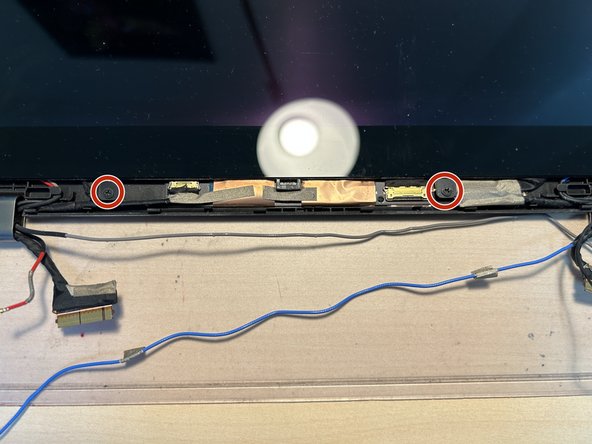

  3. Lenovo ThinkPad X1 Yoga Display Assembly Teardown, Screen cover: crwdns2935265:03crwdnd2935265:01crwdnd2935265:03crwdne2935265:0 Lenovo ThinkPad X1 Yoga Display Assembly Teardown, Screen cover: crwdns2935265:03crwdnd2935265:02crwdnd2935265:03crwdne2935265:0 Lenovo ThinkPad X1 Yoga Display Assembly Teardown, Screen cover: crwdns2935265:03crwdnd2935265:03crwdnd2935265:03crwdne2935265:0
    • The screws secured this rubbery, bendy cover which is removed easily by using your fingernails or a spudger.
    • When you have removed the cover store it away somewhere safe.
    • Remove the two PH1 screws marked with red circles.

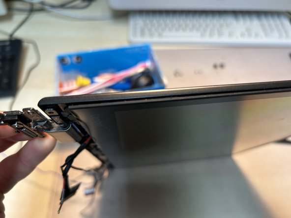

  4. Lenovo ThinkPad X1 Yoga Display Assembly Teardown, Hinges and wiring: crwdns2935265:04crwdnd2935265:01crwdnd2935265:03crwdne2935265:0 Lenovo ThinkPad X1 Yoga Display Assembly Teardown, Hinges and wiring: crwdns2935265:04crwdnd2935265:02crwdnd2935265:03crwdne2935265:0 Lenovo ThinkPad X1 Yoga Display Assembly Teardown, Hinges and wiring: crwdns2935265:04crwdnd2935265:03crwdnd2935265:03crwdne2935265:0
    • Flip the display on the side. This way it is easier to pull out the plastic caps holding the display wires in place.
    • Use some tweezers to lever out the plastic cap and store it somewhere safe.
    • Gently pull out the cables from the hinge.

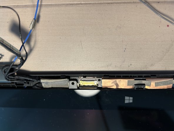

  5. Lenovo ThinkPad X1 Yoga Display Assembly Teardown, Right display hinge: crwdns2935265:05crwdnd2935265:01crwdnd2935265:03crwdne2935265:0 Lenovo ThinkPad X1 Yoga Display Assembly Teardown, Right display hinge: crwdns2935265:05crwdnd2935265:02crwdnd2935265:03crwdne2935265:0 Lenovo ThinkPad X1 Yoga Display Assembly Teardown, Right display hinge: crwdns2935265:05crwdnd2935265:03crwdnd2935265:03crwdne2935265:0
    • To the right you'll have to repeat the steps.
    • Free the cables from their prison in the hinge.

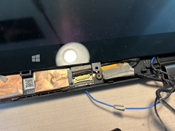

  6. Lenovo ThinkPad X1 Yoga Display Assembly Teardown, Rubber frame: crwdns2935265:06crwdnd2935265:01crwdnd2935265:02crwdne2935265:0 Lenovo ThinkPad X1 Yoga Display Assembly Teardown, Rubber frame: crwdns2935265:06crwdnd2935265:02crwdnd2935265:02crwdne2935265:0
    • The screen is secured by a rubber frame which is glued onto the display cover.
    • Use a guitar pick or a spuder to lift it off. In my case the glue was not really strong and required no heat.

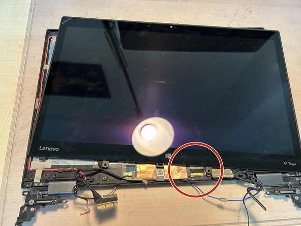

  7. Lenovo ThinkPad X1 Yoga Display Assembly Teardown, Flex connector and removal: crwdns2935265:07crwdnd2935265:01crwdnd2935265:03crwdne2935265:0 Lenovo ThinkPad X1 Yoga Display Assembly Teardown, Flex connector and removal: crwdns2935265:07crwdnd2935265:02crwdnd2935265:03crwdne2935265:0 Lenovo ThinkPad X1 Yoga Display Assembly Teardown, Flex connector and removal: crwdns2935265:07crwdnd2935265:03crwdnd2935265:03crwdne2935265:0
    • One flex connector is reachable for us. Lift up the brass clip.
    • With the screws removed and the clip detached the display is now free
    • Be careful not to rip the other flex connector, we have to detach in the next steps.

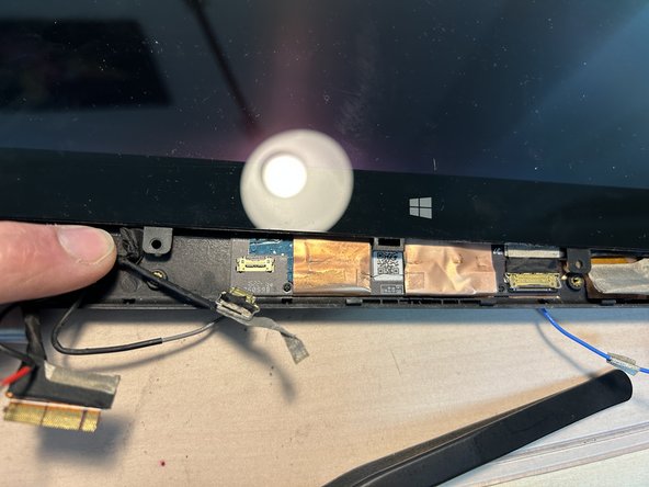

  8. Lenovo ThinkPad X1 Yoga Display Assembly Teardown, Disconnecting the display: crwdns2935265:08crwdnd2935265:01crwdnd2935265:03crwdne2935265:0 Lenovo ThinkPad X1 Yoga Display Assembly Teardown, Disconnecting the display: crwdns2935265:08crwdnd2935265:02crwdnd2935265:03crwdne2935265:0 Lenovo ThinkPad X1 Yoga Display Assembly Teardown, Disconnecting the display: crwdns2935265:08crwdnd2935265:03crwdnd2935265:03crwdne2935265:0
    • Pull the display up about an inch just so that you can detach the flex cables with the levers / clips.
  9. Lenovo ThinkPad X1 Yoga Display Assembly Teardown, Disconnect pt.2: crwdns2935265:09crwdnd2935265:01crwdnd2935265:03crwdne2935265:0 Lenovo ThinkPad X1 Yoga Display Assembly Teardown, Disconnect pt.2: crwdns2935265:09crwdnd2935265:02crwdnd2935265:03crwdne2935265:0 Lenovo ThinkPad X1 Yoga Display Assembly Teardown, Disconnect pt.2: crwdns2935265:09crwdnd2935265:03crwdnd2935265:03crwdne2935265:0
    • With all reachable connectors detached you can now lift up the screen from the cover but we're not quite there yet.
    • Flip over the screen like seen in the second picture.
    • Detach the last connector between cover and screen.
  10. Lenovo ThinkPad X1 Yoga Display Assembly Teardown, Done!: crwdns2935265:010crwdnd2935265:01crwdnd2935265:02crwdne2935265:0 Lenovo ThinkPad X1 Yoga Display Assembly Teardown, Done!: crwdns2935265:010crwdnd2935265:02crwdnd2935265:02crwdne2935265:0
    • With the last connector removed you're done!
    • You could now replace the screen or continue the disassambly.
