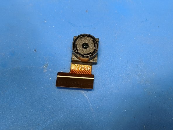

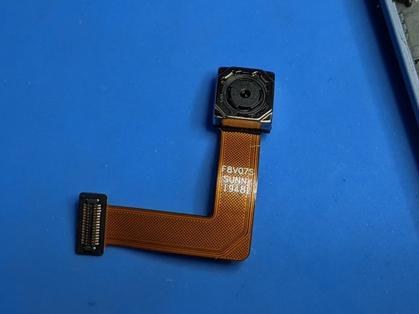

  11. Lenovo Chromebook Duet Teardown, Cameras: crwdns2935265:011crwdnd2935265:01crwdnd2935265:03crwdne2935265:0 Lenovo Chromebook Duet Teardown, Cameras: crwdns2935265:011crwdnd2935265:02crwdnd2935265:03crwdne2935265:0 Lenovo Chromebook Duet Teardown, Cameras: crwdns2935265:011crwdnd2935265:03crwdnd2935265:03crwdne2935265:0
    • Rear camera reads F8V07S SUNNY I9482
    • Front facing camera reads D2V05P

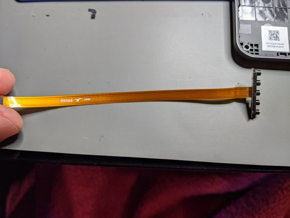

  17. Lenovo Chromebook Duet Teardown, 5-point pogo pins: crwdns2935265:017crwdnd2935265:01crwdnd2935265:02crwdne2935265:0 Lenovo Chromebook Duet Teardown, 5-point pogo pins: crwdns2935265:017crwdnd2935265:02crwdnd2935265:02crwdne2935265:0
    • The little pins the keyboard connects too is held by 3 little screws and looks pretty easy to replace.
