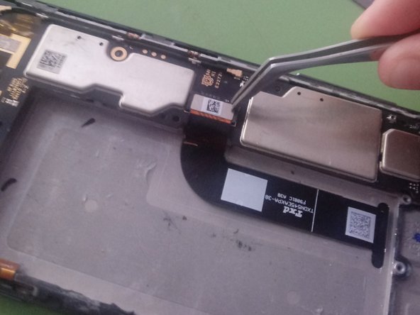

  4. LG Tribute Royal Teardown, Remove battery: crwdns2935265:04crwdnd2935265:01crwdnd2935265:03crwdne2935265:0 LG Tribute Royal Teardown, Remove battery: crwdns2935265:04crwdnd2935265:02crwdnd2935265:03crwdne2935265:0 LG Tribute Royal Teardown, Remove battery: crwdns2935265:04crwdnd2935265:03crwdnd2935265:03crwdne2935265:0
    • Disconnect the ribbon cable that connects the battery to the motherboard. I suggest you heat up the battery first because of the glue and not do what i did. Use spudger to pry up the battery from the device.
  5. LG Tribute Royal Teardown, Remove back camera: crwdns2935265:05crwdnd2935265:01crwdnd2935265:02crwdne2935265:0 LG Tribute Royal Teardown, Remove back camera: crwdns2935265:05crwdnd2935265:02crwdnd2935265:02crwdne2935265:0
    • Disconnect the back camera from the motherboard by disconnecting the connector from the motherboard
