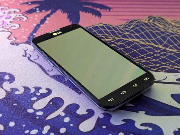

    • Alrighty, what specs did LG provide for a budget phone like this in 2014?
    • 4.7" 960x540 display at 234ppi
    • Quad-core, 1.2 GHz Snapdragon 400 processor and 450 MHz Adreno 305 GPU
    • 1 GB RAM
    • 8 MP/1080p rear camera with autofocus, and 0.3 MP front-facing camera
    • 3G wireless support, 802.11 b/g/n (2.4GHz) Wi-Fi 4, and Bluetooth 4.0
    • 8 GB built-in memory
    • Android 4.4.2 KitKat, up to Android 5.0.2 Lollipop

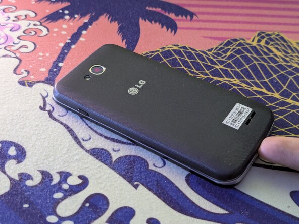

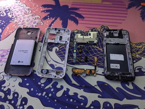

  2. LG Optimus L90 Dual Teardown: crwdns2935265:02crwdnd2935265:01crwdnd2935265:03crwdne2935265:0 LG Optimus L90 Dual Teardown: crwdns2935265:02crwdnd2935265:02crwdnd2935265:03crwdne2935265:0 LG Optimus L90 Dual Teardown: crwdns2935265:02crwdnd2935265:03crwdnd2935265:03crwdne2935265:0

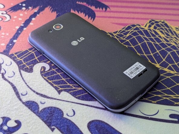

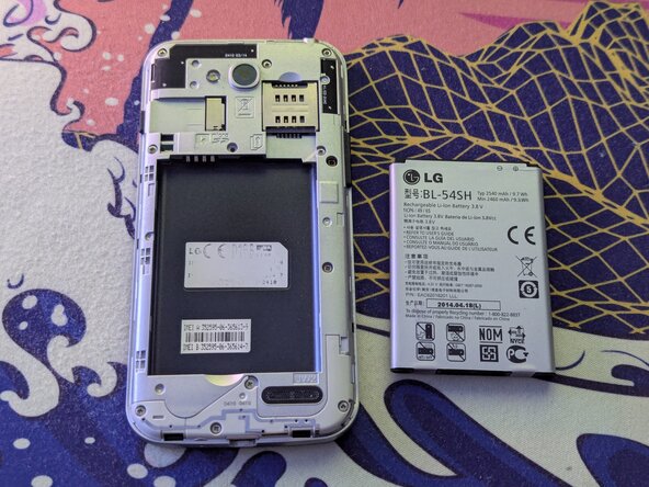

    • Those specs were quite fine for that time. This phone even had enough storage to download basic apps, unlike its smaller brother, LG Optimus L70. I mean, come on, it had only 1.5 GB available out of given 4 GB for apps, and two thirds of that space were already taken by preloaded apps! That is quite harsh.

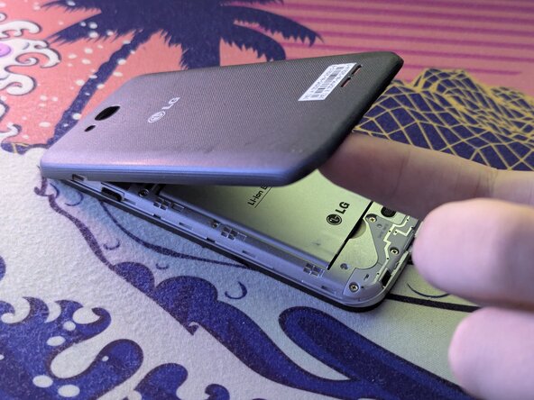

    • Anyways. The plastic back cover is held by plastic clips and is easy to remove. Underneath it lies a LG's 3.8V 2540mAh BL-54SH battery.
    • And it still has a warning icon, indicating that it's unsafe to let pets smaller than this battery anywhere near it. Just like its bigger and beefier brother.

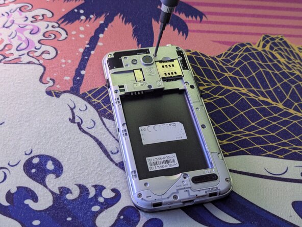

  3. LG Optimus L90 Dual Teardown: crwdns2935265:03crwdnd2935265:01crwdnd2935265:02crwdne2935265:0 LG Optimus L90 Dual Teardown: crwdns2935265:03crwdnd2935265:02crwdnd2935265:02crwdne2935265:0

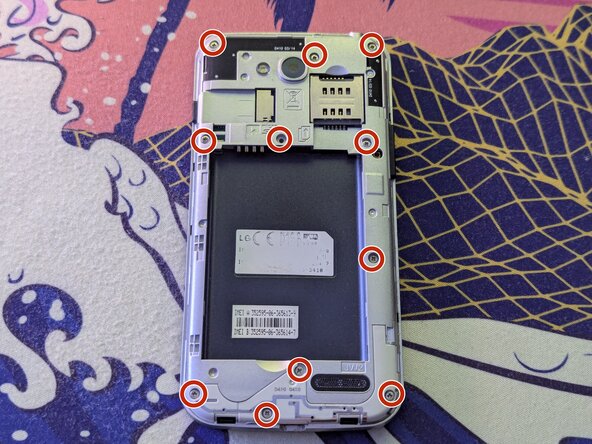

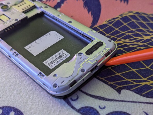

    • Time to pull out the PH00 screwdriver! The midframe is held by eleven 4mm screws. For some reason, my unit lacks one screw. Did somebody steal it while I was sleeping?

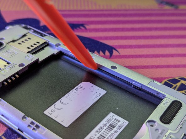

  4. LG Optimus L90 Dual Teardown: crwdns2935265:04crwdnd2935265:01crwdnd2935265:03crwdne2935265:0 LG Optimus L90 Dual Teardown: crwdns2935265:04crwdnd2935265:02crwdnd2935265:03crwdne2935265:0 LG Optimus L90 Dual Teardown: crwdns2935265:04crwdnd2935265:03crwdnd2935265:03crwdne2935265:0
    • But we're not done here yet, as the midframe is also held by plastic clips. Time to break it off with a spudger!

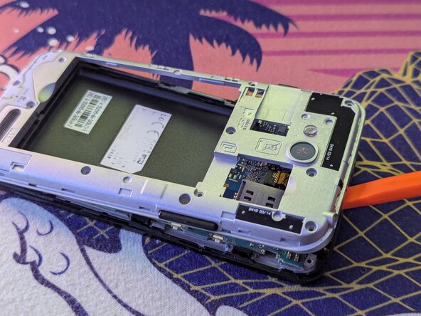

  5. LG Optimus L90 Dual Teardown: crwdns2935265:05crwdnd2935265:01crwdnd2935265:01crwdne2935265:0

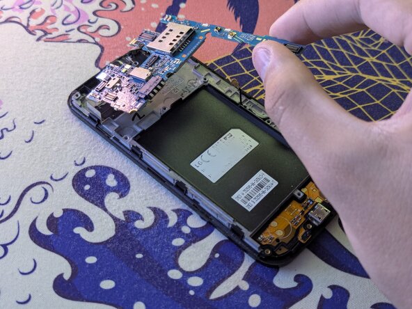

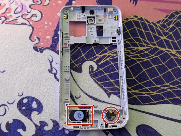

    • As I'm flipping the midframe, we can see some antennas, a vibration motor and a speaker. Nothing interesting here, sadly.
  6. LG Optimus L90 Dual Teardown: crwdns2935265:06crwdnd2935265:01crwdnd2935265:03crwdne2935265:0 LG Optimus L90 Dual Teardown: crwdns2935265:06crwdnd2935265:02crwdnd2935265:03crwdne2935265:0 LG Optimus L90 Dual Teardown: crwdns2935265:06crwdnd2935265:03crwdnd2935265:03crwdne2935265:0

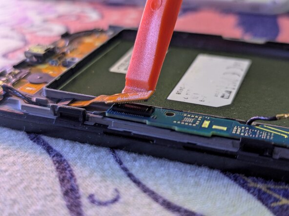

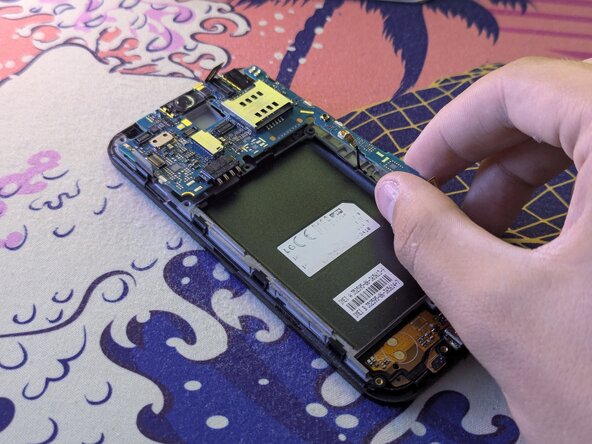

    • We're getting closer to that yummy teal bowl that's full of chips now! Time to unplug the flex cables.

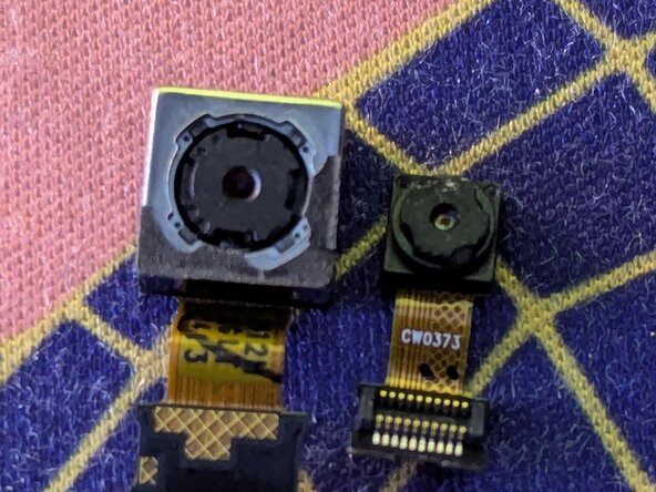

  7. LG Optimus L90 Dual Teardown: crwdns2935265:07crwdnd2935265:01crwdnd2935265:02crwdne2935265:0 LG Optimus L90 Dual Teardown: crwdns2935265:07crwdnd2935265:02crwdnd2935265:02crwdne2935265:0

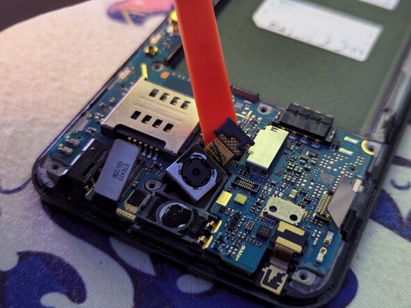

    • Time to take a small look at the cameras. Look how tiny the 0.3 MP front camera looks compared to the 8 MP rear camera!

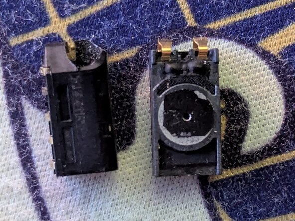

    • And don't forget about the headphone jack and the earpiece speaker! Just like the camera modules, they're modular and easy to pop off.

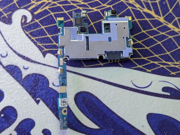

  8. LG Optimus L90 Dual Teardown: crwdns2935265:08crwdnd2935265:01crwdnd2935265:03crwdne2935265:0 LG Optimus L90 Dual Teardown: crwdns2935265:08crwdnd2935265:02crwdnd2935265:03crwdne2935265:0 LG Optimus L90 Dual Teardown: crwdns2935265:08crwdnd2935265:03crwdnd2935265:03crwdne2935265:0

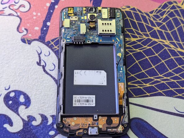

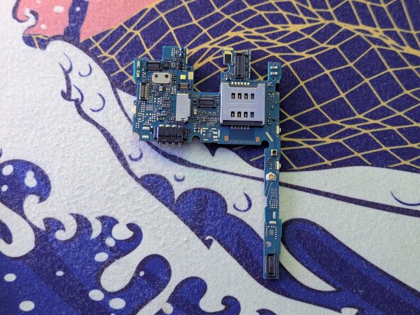

    • Time for the grand reveal! The front side doesn't have any interesting chips.
  9. LG Optimus L90 Dual Teardown: crwdns2935265:09crwdnd2935265:01crwdnd2935265:02crwdne2935265:0 LG Optimus L90 Dual Teardown: crwdns2935265:09crwdnd2935265:02crwdnd2935265:02crwdne2935265:0

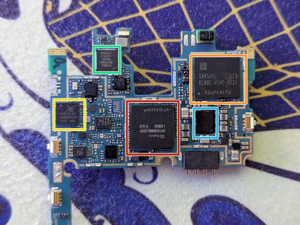

    • However, if we flip the motherboard and take the EMI shield off, we can finally take a look at these beautiful silicon chips!
    • SK Hynix H9TKNNN8JDAPLR-NGH 1GB LPDDR2-1066 RAM
    • The Quad-core, 1.2 GHz Snapdragon 400 SoC is layered beneath the RAM
    • Samsung KLM8G1WEMB-8031 8 GB eMMC 5.0 NAND flash
    • Skyworks SKY77573-31 Tx-Rx Front-end Module for GSM/GPRS/EDGE
    • Atmel mXT336S-AT
    • Qualcomm PM8226 power management IC
    • Because of that obnoxious camera zoom, I wasn't able to identify other chips. Maybe I should buy a proper camera instead of shooting everything on my Pixel...

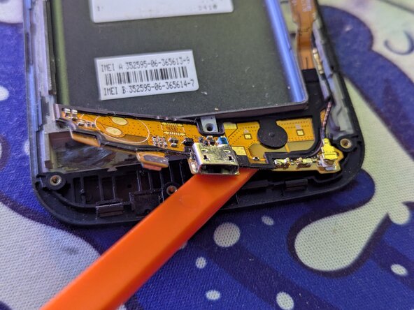

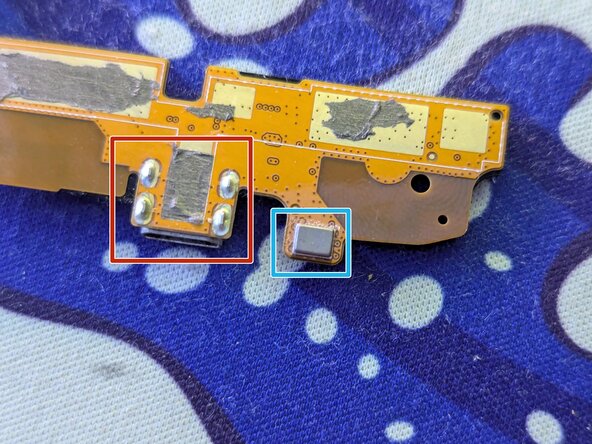

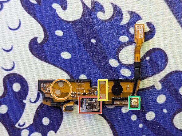

    • The daughterboard, on the other hand, doesn't have anything interesting on it. Just some regular stuff that you'll see on other daughterboards.
    • Micro-USB 2.0 port
    • Vibration motor spring contacts
    • Speaker spring contacts
    • Coax connector
    • Microphone
