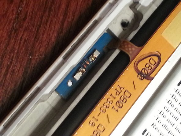

  11. LG G2 Teardown: crwdns2935265:011crwdnd2935265:01crwdnd2935265:02crwdne2935265:0 LG G2 Teardown: crwdns2935265:011crwdnd2935265:02crwdnd2935265:02crwdne2935265:0
    • At the bottom of the phone is another very small board almost like a piece of metal tape. It's held down by a small screw. Remove the screw, and peel up the piece. I'm 99% sure it's strictly for grounding purposes, but none the less is still important.
    • TIP: When prying up circuit, logic boards, or small pieces like this it's best to start where a screw was removed, because often the area is reinforced and protected.

Which part controls the speaker? Mine has stopped working
Yvette LaMar - crwdns2934203:0crwdne2934203:0
Speaker's on the mobo and fairly exposed to water damage if it so occurs - other than cleaning the goldfingers/contact pads and tightening the ~6 screws on the upper plastic shield (the plastic shield is required to be in-place for sound to work), you might be out of luck.
Tai -
Hi there.
I´m, having also Problems with Speaker. After Replace the Screen Speaker doesn´t work. I had changed the Flex Cable and Speaker (lower Plastic Part). But it doesn´t work :(
Why must be the upper Plastic Part installed to work speaker?
Mike Miller -
Hi Yvette,
I had the same problem you have. It turns out that the speaker is in the lower cover. Not the upper cover mentioned elsewhere. Here's a picture to help me explain: http://imgur.com/akIB9Cy The upper piece in the photo contains the speaker. You'll notice the contacts on the thin portion. The lower piece is the ribbon cable that goes up the left side of the battery. Notice the contacts on the piece that hangs off of the cable. Apparently a lot of us end up compressing those contacts in the process of removing the cover that contains the speaker. What you need to do is use some tool to carefully uncompress the contacts on the ribbon cable. That should let them make contact with the speaker contacts and fix your sound problem.
