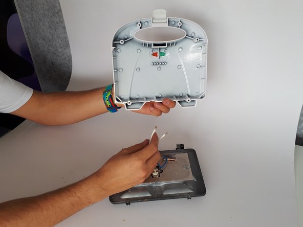

  3. Home Essentials Sandwich Press Teardown: crwdns2935265:03crwdnd2935265:01crwdnd2935265:03crwdne2935265:0 Home Essentials Sandwich Press Teardown: crwdns2935265:03crwdnd2935265:02crwdnd2935265:03crwdne2935265:0 Home Essentials Sandwich Press Teardown: crwdns2935265:03crwdnd2935265:03crwdnd2935265:03crwdne2935265:0

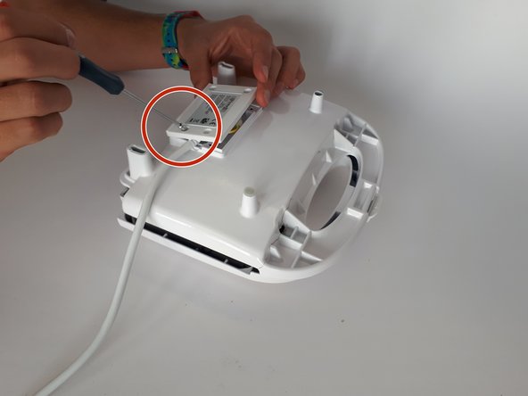

    • Unscrew the plastic handle cover using a Special Key Tri-wing.
    • One screw was very hard to unscrew, so grip paste had to be used.
    • The screws are 9 mm long.

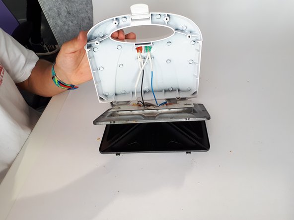

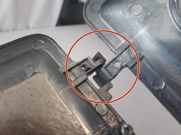

  5. Home Essentials Sandwich Press Teardown: crwdns2935265:05crwdnd2935265:01crwdnd2935265:03crwdne2935265:0 Home Essentials Sandwich Press Teardown: crwdns2935265:05crwdnd2935265:02crwdnd2935265:03crwdne2935265:0 Home Essentials Sandwich Press Teardown: crwdns2935265:05crwdnd2935265:03crwdnd2935265:03crwdne2935265:0
    • Now the metal plates are loose from the plastic cover. The plates need to be moved until the end of their hinge slots to slide them apart.
    • The hinges are very easy to take apart, once it is loose from the plastic cover.

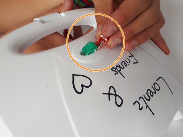

  6. Home Essentials Sandwich Press Teardown: crwdns2935265:06crwdnd2935265:01crwdnd2935265:03crwdne2935265:0 Home Essentials Sandwich Press Teardown: crwdns2935265:06crwdnd2935265:02crwdnd2935265:03crwdne2935265:0 Home Essentials Sandwich Press Teardown: crwdns2935265:06crwdnd2935265:03crwdnd2935265:03crwdne2935265:0
    • Separate the snap fit and remove the light covers.
    • Remove the cords of the lights by pulling them out of their snap fit.
    • Remove the light covers by pushing them out of the plastic cover.
    • The lights are being taken out very easily with not much pressure.

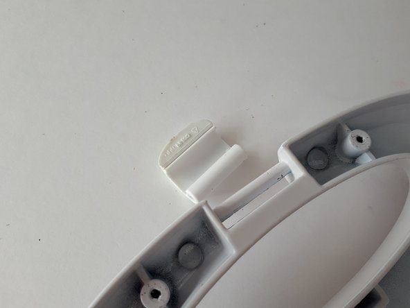

  7. Home Essentials Sandwich Press Teardown: crwdns2935265:07crwdnd2935265:01crwdnd2935265:02crwdne2935265:0 Home Essentials Sandwich Press Teardown: crwdns2935265:07crwdnd2935265:02crwdnd2935265:02crwdne2935265:0
    • Remove the press latch by using a screwdriver; add some pressure to it to get the latch loose.
    • Removing the press latch is hard and requires extra effort.

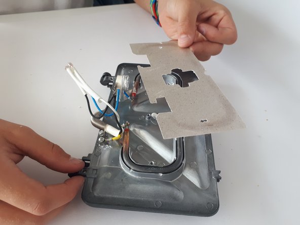

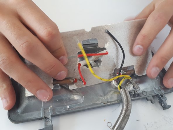

  8. Home Essentials Sandwich Press Teardown: crwdns2935265:08crwdnd2935265:01crwdnd2935265:03crwdne2935265:0 Home Essentials Sandwich Press Teardown: crwdns2935265:08crwdnd2935265:02crwdnd2935265:03crwdne2935265:0 Home Essentials Sandwich Press Teardown: crwdns2935265:08crwdnd2935265:03crwdnd2935265:03crwdne2935265:0
    • Unscrew the heating element covers using a size PH1 screwdriver.
    • Remove the heating element covers from the plates.
    • These screws are very loose and easy to remove
    • The screws are 5 mm long.

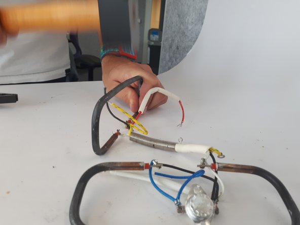

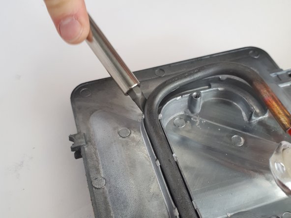

  9. Home Essentials Sandwich Press Teardown: crwdns2935265:09crwdnd2935265:01crwdnd2935265:03crwdne2935265:0 Home Essentials Sandwich Press Teardown: crwdns2935265:09crwdnd2935265:02crwdnd2935265:03crwdne2935265:0 Home Essentials Sandwich Press Teardown: crwdns2935265:09crwdnd2935265:03crwdnd2935265:03crwdne2935265:0
    • Unscrew the heating element wires from the hot plates using a PH1 screwdriver. The screws are 5 mm long.
    • Remove the heating elements using a Phillips head screwdriver, and put this screwdriver under the heating elements.
    • Removing the heating elements requires some more pressure because they are put in with a tight snap fit. The heating element will also deform when removed.
