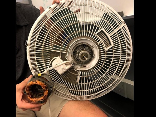

  1. Holmes 16 Inch 4-in-1 Fan Teardown, Remove Frame: crwdns2935265:01crwdnd2935265:01crwdnd2935265:02crwdne2935265:0 Holmes 16 Inch 4-in-1 Fan Teardown, Remove Frame: crwdns2935265:01crwdnd2935265:02crwdnd2935265:02crwdne2935265:0
    • Remove holding pin on outer part of fan
    • Pull apart front frame from back frame
  2. Holmes 16 Inch 4-in-1 Fan Teardown, Detach Motor Housing  from Downrod: crwdns2935265:02crwdnd2935265:01crwdnd2935265:03crwdne2935265:0 Holmes 16 Inch 4-in-1 Fan Teardown, Detach Motor Housing  from Downrod: crwdns2935265:02crwdnd2935265:02crwdnd2935265:03crwdne2935265:0 Holmes 16 Inch 4-in-1 Fan Teardown, Detach Motor Housing  from Downrod: crwdns2935265:02crwdnd2935265:03crwdnd2935265:03crwdne2935265:0
    • Remove screws connecting the motor housing to the downrod
    • Detach housing from downrod
    • Note: Oscillation Control will no longer function
  3. Holmes 16 Inch 4-in-1 Fan Teardown, Remove Motor Casing: crwdns2935265:03crwdnd2935265:01crwdnd2935265:03crwdne2935265:0 Holmes 16 Inch 4-in-1 Fan Teardown, Remove Motor Casing: crwdns2935265:03crwdnd2935265:02crwdnd2935265:03crwdne2935265:0 Holmes 16 Inch 4-in-1 Fan Teardown, Remove Motor Casing: crwdns2935265:03crwdnd2935265:03crwdnd2935265:03crwdne2935265:0
    • Remove Oscillation Control pin
    • Remove back screw
    • Remove Motor Casing
  4. Holmes 16 Inch 4-in-1 Fan Teardown, Disconnect Stator from Rotor: crwdns2935265:04crwdnd2935265:01crwdnd2935265:02crwdne2935265:0 Holmes 16 Inch 4-in-1 Fan Teardown, Disconnect Stator from Rotor: crwdns2935265:04crwdnd2935265:02crwdnd2935265:02crwdne2935265:0
    • Remove the four screws connecting the stator to the rotor. The top two are displayed.
    • Detach the stator from the rotor.
    • Note: the fan will no longer operate.
