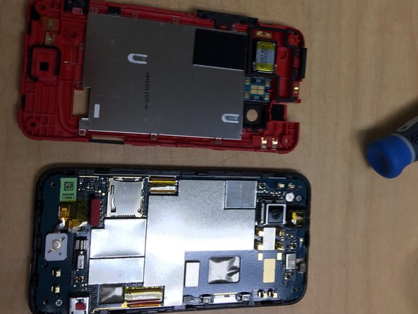

  4. HTC Droid Incredible Teardown, Removing Back: crwdns2935265:04crwdnd2935265:01crwdnd2935265:01crwdne2935265:0
    • Then carefully start to spit the phone from any corner.

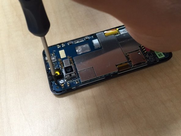

  5. HTC Droid Incredible Teardown, Unscrewing Motherboard: crwdns2935265:05crwdnd2935265:01crwdnd2935265:03crwdne2935265:0 HTC Droid Incredible Teardown, Unscrewing Motherboard: crwdns2935265:05crwdnd2935265:02crwdnd2935265:03crwdne2935265:0 HTC Droid Incredible Teardown, Unscrewing Motherboard: crwdns2935265:05crwdnd2935265:03crwdnd2935265:03crwdne2935265:0
    • Then remove the three screws. one at the top and the other two at the bottom.

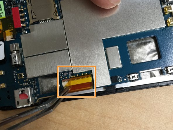

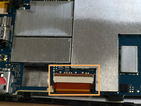

  6. HTC Droid Incredible Teardown, Removing Strips and Motherboard: crwdns2935265:06crwdnd2935265:01crwdnd2935265:03crwdne2935265:0 HTC Droid Incredible Teardown, Removing Strips and Motherboard: crwdns2935265:06crwdnd2935265:02crwdnd2935265:03crwdne2935265:0 HTC Droid Incredible Teardown, Removing Strips and Motherboard: crwdns2935265:06crwdnd2935265:03crwdnd2935265:03crwdne2935265:0
    • After removing the screw you also have to remove the orange strip by lifting up the top of the container. Then pull the strip out of it.

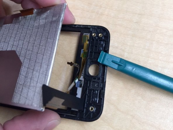

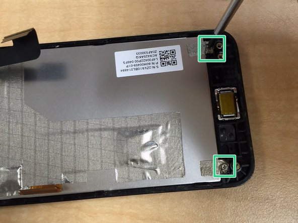

  7. HTC Droid Incredible Teardown, Removing Screen: crwdns2935265:07crwdnd2935265:01crwdnd2935265:03crwdne2935265:0 HTC Droid Incredible Teardown, Removing Screen: crwdns2935265:07crwdnd2935265:02crwdnd2935265:03crwdne2935265:0 HTC Droid Incredible Teardown, Removing Screen: crwdns2935265:07crwdnd2935265:03crwdnd2935265:03crwdne2935265:0
    • Remove the top two screws on the pone that will be encased in tape, and then pull the screen out using Blue Opening tool or other.

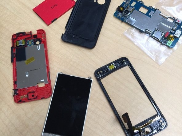

  8. HTC Droid Incredible Teardown, Screen Is Removed: crwdns2935265:08crwdnd2935265:01crwdnd2935265:02crwdne2935265:0 HTC Droid Incredible Teardown, Screen Is Removed: crwdns2935265:08crwdnd2935265:02crwdnd2935265:02crwdne2935265:0
    • That is how you take apart the HTC
