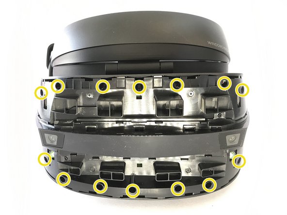

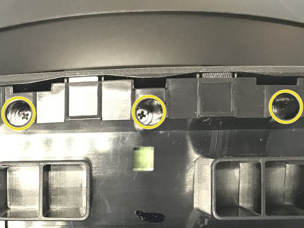

  3. HP Windows Mixed Reality Headset Developer Edition Teardown, Remove interior plastic and screws: crwdns2935265:03crwdnd2935265:01crwdnd2935265:03crwdne2935265:0 HP Windows Mixed Reality Headset Developer Edition Teardown, Remove interior plastic and screws: crwdns2935265:03crwdnd2935265:02crwdnd2935265:03crwdne2935265:0 HP Windows Mixed Reality Headset Developer Edition Teardown, Remove interior plastic and screws: crwdns2935265:03crwdnd2935265:03crwdnd2935265:03crwdne2935265:0
    • To remove the next layer of protective plastic, you'll need to remove 16 screws
    • 1 on each side
    • and 14 on the front

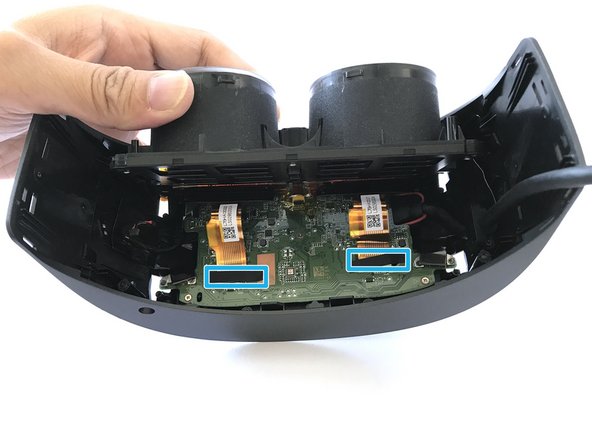

  7. HP Windows Mixed Reality Headset Developer Edition Teardown, Remove metallic tape: crwdns2935265:07crwdnd2935265:01crwdnd2935265:03crwdne2935265:0 HP Windows Mixed Reality Headset Developer Edition Teardown, Remove metallic tape: crwdns2935265:07crwdnd2935265:02crwdnd2935265:03crwdne2935265:0 HP Windows Mixed Reality Headset Developer Edition Teardown, Remove metallic tape: crwdns2935265:07crwdnd2935265:03crwdnd2935265:03crwdne2935265:0
    • With the lenses removed, you can begin separating the PCB from whats left of the HMD.
    • USE TWEEZERS to peel back the two pieces of metallic tape on the PCB (this tape is SHARP — do not use your hands).

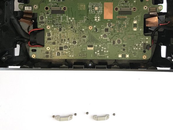

    • Remove the four screws to remove the two metal clips on each side of the PCB.

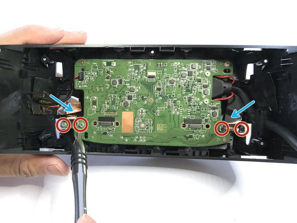

  8. HP Windows Mixed Reality Headset Developer Edition Teardown: crwdns2935265:08crwdnd2935265:01crwdnd2935265:03crwdne2935265:0 HP Windows Mixed Reality Headset Developer Edition Teardown: crwdns2935265:08crwdnd2935265:02crwdnd2935265:03crwdne2935265:0 HP Windows Mixed Reality Headset Developer Edition Teardown: crwdns2935265:08crwdnd2935265:03crwdnd2935265:03crwdne2935265:0
    • After removed the PCB, you can see the front camera sensor compartment.
    • Peel off the copper tape on both side before the next step. (SHARP EDGES -TWEEZERS recommend).
    • Remove 4 screws to disassemble the front camera sensor on each side.
    • Cameras were not easily identifiable, however, they looked identical to the cameras we found in our Acer MR HMD teardown. Also had similar part numbers to the the Microsoft Surface 3 rear camera.

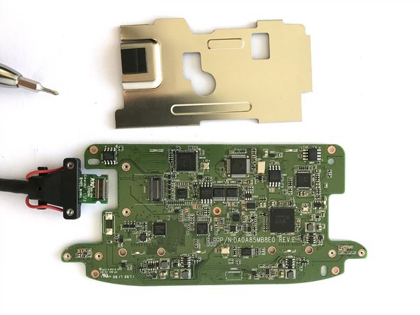

  9. HP Windows Mixed Reality Headset Developer Edition Teardown, Separate metal and cable from PCB: crwdns2935265:09crwdnd2935265:01crwdnd2935265:03crwdne2935265:0 HP Windows Mixed Reality Headset Developer Edition Teardown, Separate metal and cable from PCB: crwdns2935265:09crwdnd2935265:02crwdnd2935265:03crwdne2935265:0 HP Windows Mixed Reality Headset Developer Edition Teardown, Separate metal and cable from PCB: crwdns2935265:09crwdnd2935265:03crwdnd2935265:03crwdne2935265:0
    • The metal cover to the PCB can be easily pried apart with a flat head screwdriver.
    • After doing this, the two screws connecting the cable to the PCB is revealed.
    • Remove the two screws, then pop off the connector straight up, not at an angle.
  10. HP Windows Mixed Reality Headset Developer Edition Teardown, PCB and Components: crwdns2935265:010crwdnd2935265:01crwdnd2935265:02crwdne2935265:0 HP Windows Mixed Reality Headset Developer Edition Teardown, PCB and Components: crwdns2935265:010crwdnd2935265:02crwdnd2935265:02crwdne2935265:0

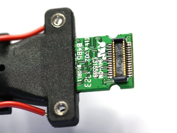

  11. HP Windows Mixed Reality Headset Developer Edition Teardown, Cabling: crwdns2935265:011crwdnd2935265:01crwdnd2935265:03crwdne2935265:0 HP Windows Mixed Reality Headset Developer Edition Teardown, Cabling: crwdns2935265:011crwdnd2935265:02crwdnd2935265:03crwdne2935265:0 HP Windows Mixed Reality Headset Developer Edition Teardown, Cabling: crwdns2935265:011crwdnd2935265:03crwdnd2935265:03crwdne2935265:0
    • The main cable is a USB and HDMI to a proprietary connector.
    • Instead of plugging directly into the HMD, the proprietary connector plugs into a receptacle which is attached to an embedded connector (shown on the PCB in steps nine and ten).
  12. HP Windows Mixed Reality Headset Developer Edition Teardown, Active cable module: crwdns2935265:012crwdnd2935265:01crwdnd2935265:03crwdne2935265:0 HP Windows Mixed Reality Headset Developer Edition Teardown, Active cable module: crwdns2935265:012crwdnd2935265:02crwdnd2935265:03crwdne2935265:0 HP Windows Mixed Reality Headset Developer Edition Teardown, Active cable module: crwdns2935265:012crwdnd2935265:03crwdnd2935265:03crwdne2935265:0
    • After finding an active cable module within the Acer headset, we were curious as to why the HP headset had no chips on their cable. So we opened up the proprietary connector on the cable (Do not do this. You won't be able to easily put it back together)
    • Under the plastic shell, we found a similar Spectra7 cable module similar to that of the Acer Windows HMD
    • Spectra7 VR8050 USB 3.0 Cable Equalizer
    • Spectra7 HT8181 HDMI 2.0 Cable Equalizer

Hi there,
I am wondering if anyone knows the components I have highlighted.
[IMG]http://i63.tinypic.com/2hxsz1f.jpg[/IMG]
[IMG]http://i66.tinypic.com/2mm5zyu.jpg[/IMG]
[IMG]http://i63.tinypic.com/33w8hop.jpg[/IMG]
My HP WMR unit had a power surge and has burnt out most of these components.
A good electrical engineer friend of mine has cast a close eye over all the other components on the board, showing no physical damage (which I know doesn’t mean that they all ok).
I live in hope that I will be able to repair my WMR headset, as I have myself had plenty of experience with SM components.
Just identifying the values of these components is proving to be mighty tricky!
I believe (A) 6 pin “EDVGA” are voltage regulators - SOT23-6?
(B) Transistor? - “NA ID9” ?
Appreciate any help :)
Paul
