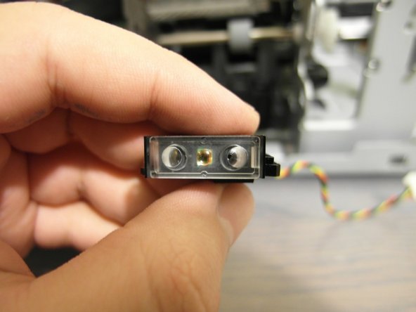

  2. HP Officejet Pro L7580 Teardown: crwdns2935265:02crwdnd2935265:01crwdnd2935265:03crwdne2935265:0 HP Officejet Pro L7580 Teardown: crwdns2935265:02crwdnd2935265:02crwdnd2935265:03crwdne2935265:0 HP Officejet Pro L7580 Teardown: crwdns2935265:02crwdnd2935265:03crwdnd2935265:03crwdne2935265:0
    • After removing the paper feeder, you will notice the slotted opto switch.
    • Remove the back cover to demount cable jacks.
    • Pull and detach the paper feeder mechanism.

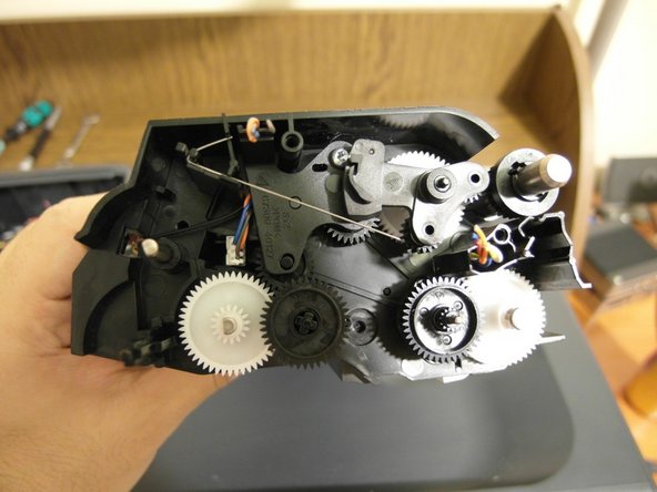

  3. HP Officejet Pro L7580 Teardown: crwdns2935265:03crwdnd2935265:01crwdnd2935265:03crwdne2935265:0 HP Officejet Pro L7580 Teardown: crwdns2935265:03crwdnd2935265:02crwdnd2935265:03crwdne2935265:0 HP Officejet Pro L7580 Teardown: crwdns2935265:03crwdnd2935265:03crwdnd2935265:03crwdne2935265:0

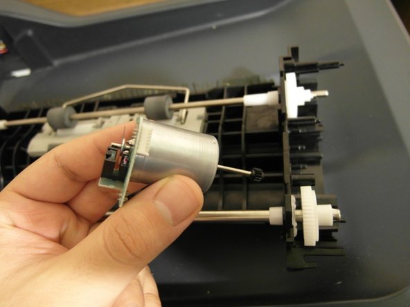

    • Remove the T8 Torx screws from the right cover.
    • You will see the feeder's mechanics after removing the cover.
    • Remove the top cover, and here is the first DC motor and its encoder.

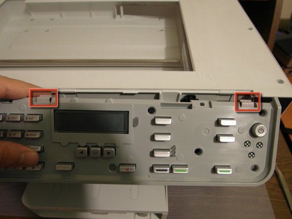

  4. HP Officejet Pro L7580 Teardown: crwdns2935265:04crwdnd2935265:01crwdnd2935265:03crwdne2935265:0 HP Officejet Pro L7580 Teardown: crwdns2935265:04crwdnd2935265:02crwdnd2935265:03crwdne2935265:0 HP Officejet Pro L7580 Teardown: crwdns2935265:04crwdnd2935265:03crwdnd2935265:03crwdne2935265:0
    • Pull the scanner cover up to detach it from the main body. Then, remove the T8 Torx screws around the scanner window.
    • Remove the control panel by pulling it.
    • Finally, remove the inner layer of the control panel by forcing the notches.

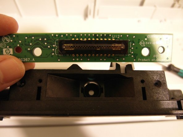

  7. HP Officejet Pro L7580 Teardown: crwdns2935265:07crwdnd2935265:01crwdnd2935265:03crwdne2935265:0 HP Officejet Pro L7580 Teardown: crwdns2935265:07crwdnd2935265:02crwdnd2935265:03crwdne2935265:0 HP Officejet Pro L7580 Teardown: crwdns2935265:07crwdnd2935265:03crwdnd2935265:03crwdne2935265:0
    • Remove the scan head's top cover by pressing the two notches on the back.
    • Remove the T8 screws of the circuit board.
    • Here is the scanner sensor and the objective.

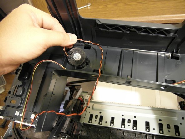

  10. HP Officejet Pro L7580 Teardown: crwdns2935265:010crwdnd2935265:01crwdnd2935265:03crwdne2935265:0 HP Officejet Pro L7580 Teardown: crwdns2935265:010crwdnd2935265:02crwdnd2935265:03crwdne2935265:0 HP Officejet Pro L7580 Teardown: crwdns2935265:010crwdnd2935265:03crwdnd2935265:03crwdne2935265:0
    • Remove the screws of the cover.
    • You will notice the speaker below the cover.
    • Remove the screws of cartridge door. There is another slotted opto switch here.

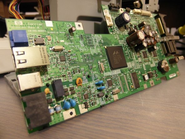

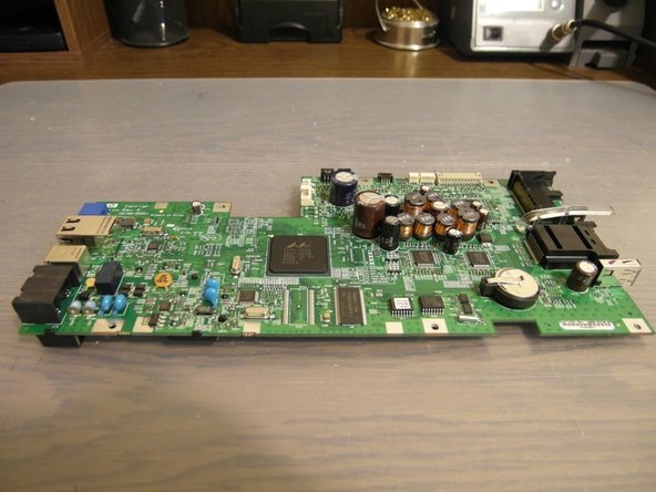

    • Remove the screws to detach the mainboard of the printer.
    • The board has a power input, an Ethernet connector, a USB device port, phone line input and outputs, memory card slots, a USB host port, various internal connectors and a CR2032 RTC battery.

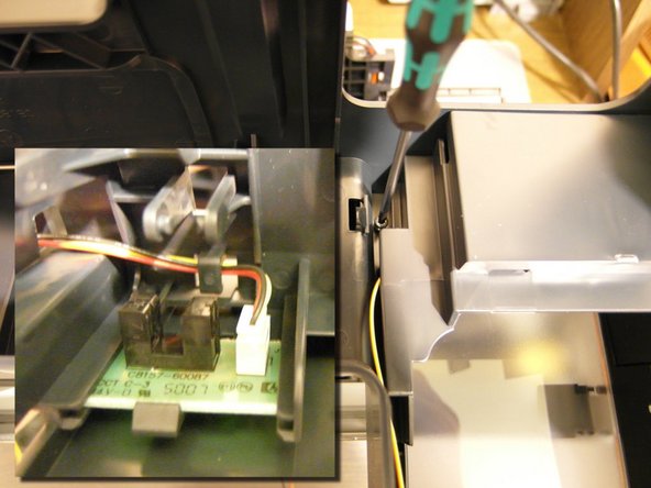

  15. HP Officejet Pro L7580 Teardown: crwdns2935265:015crwdnd2935265:01crwdnd2935265:02crwdne2935265:0 HP Officejet Pro L7580 Teardown: crwdns2935265:015crwdnd2935265:02crwdnd2935265:02crwdne2935265:0

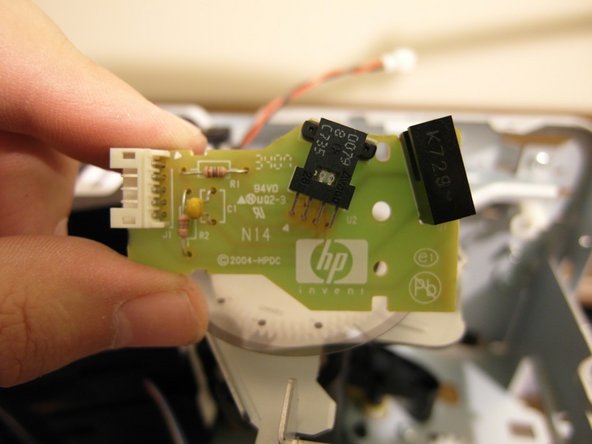

    • Remove the screw to get slotted opto switches.

    • This is the ink cartridge pumping mechanism. The last DC motor we detached controls this mechanism.
    • The opto switch reports the mechanism's position.
