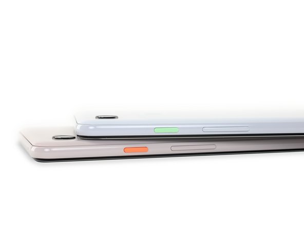

  3. Google Pixel 3 XL Teardown: crwdns2935265:03crwdnd2935265:01crwdnd2935265:03crwdne2935265:0 Google Pixel 3 XL Teardown: crwdns2935265:03crwdnd2935265:02crwdnd2935265:03crwdne2935265:0 Google Pixel 3 XL Teardown: crwdns2935265:03crwdnd2935265:03crwdnd2935265:03crwdne2935265:0
    • The front-firing speakers on both Pixel 3's leave the aluminum frame devoid of any speaker grilles.
    • Stacked together, it's obvious that one of these phones is a little more XL than the other, but there's not much difference otherwise.
    • USB-C charging port, SIM card slot, and 80's themed power buttons are present and accounted for on both phones.

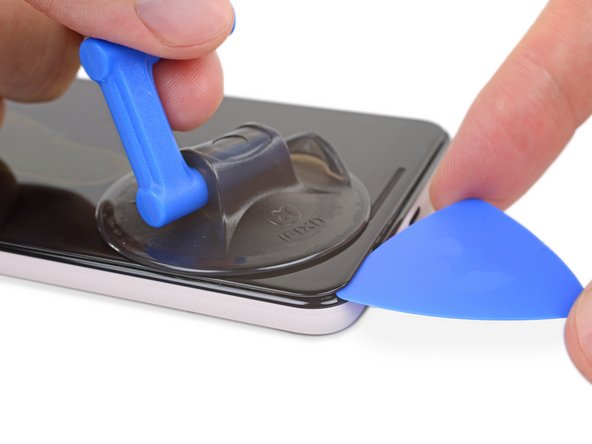

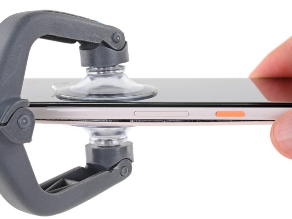

  4. Google Pixel 3 XL Teardown: crwdns2935265:04crwdnd2935265:01crwdnd2935265:03crwdne2935265:0 Google Pixel 3 XL Teardown: crwdns2935265:04crwdnd2935265:02crwdnd2935265:03crwdne2935265:0 Google Pixel 3 XL Teardown: crwdns2935265:04crwdnd2935265:03crwdnd2935265:03crwdne2935265:0
    iSclack
    $24.99
    • Now that we've worked our way around the exterior, it's time to head inside.
    • Experience tells us that a little suction and cutting is all that's required to coax the display open, but when that doesn't work we bring out the big (heat) guns.
    • It looks like the Pixel 3 XL still uses foam adhesive, but it's far more tenacious than the repair-friendly stuff we saw last year.
    • We pull out the trusty iSclack, expecting to separate the display assembly, but the rear cover yields first!
    • This whole thing is starting to remind us less of the Pixel 3's predecessor, and more of its notoriously sticky contemporary.

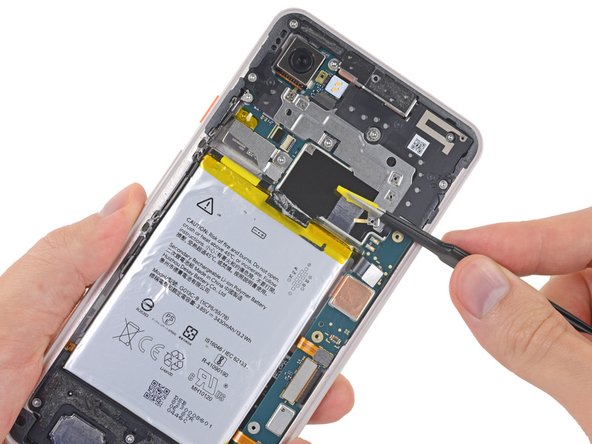

  6. Google Pixel 3 XL Teardown: crwdns2935265:06crwdnd2935265:01crwdnd2935265:03crwdne2935265:0 Google Pixel 3 XL Teardown: crwdns2935265:06crwdnd2935265:02crwdnd2935265:03crwdne2935265:0 Google Pixel 3 XL Teardown: crwdns2935265:06crwdnd2935265:03crwdnd2935265:03crwdne2935265:0
    • The tough adhesive trend continues, holding the wireless charging coil to the Pixel's powerhouse. But we spy some respite!
    • The battery is secured with relatively repair-friendly stretch-release adhesive. So you get at least one chance at easy removal, if your technique is right!
    • These strips didn't actually help us much, but the Pixel 3 had better luck.
    • We resort to flossing out the battery and accidentally cut a fragile ribbon cable hiding underneath! Forewarned is forearmed—a repair manual would have helped us in this arena.
    • Adhesive ordeals aside, the battery's out: the Pixel 3 XL is packing 13.2 Wh. That's actually down a smidge from the Pixel 2 XL's 13.6 Wh, and around the same as the original Pixel XL's 13.28 Wh.
    • The Pixel 3 XL still beats out the iPhone XS Max (12.08 Wh), and comes close to the Galaxy S9+ (13.48 Wh).

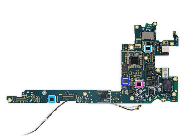

  9. Google Pixel 3 XL Teardown: crwdns2935265:09crwdnd2935265:01crwdnd2935265:02crwdne2935265:0 Google Pixel 3 XL Teardown: crwdns2935265:09crwdnd2935265:02crwdnd2935265:02crwdne2935265:0
    • All this glue has us tired—let's sit down for some chips:
    • Micron MT53D1024M32D4DT-046 AIT:D 4 GB LPDDR4X DRAM layered over Qualcomm Snapdragon 845
    • Skhynix H28S7Q302BMR 64 GB NAND flash (universal flash storage)
    • Google SR3HX Pixel Visual Core (as seen in the Pixel 2 XL)
    • Qualcomm SDR845 RF Transceiver
    • Qualcomm QPM2622 and QPM2642 low and high band power amplifier module (PAMiD)
    • Qualcomm QET4100 40MHz envelope tracker
    • Qualcomm PMI8998 PMIC

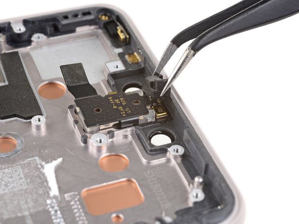

    • The daughterboard comes out without any fuss, taking the USB-C port, SIM tray, and some antenna hardware along with it.
    • The vibration motor is a little more reluctant to leave its home, but our Halberd Spudger can be very persuasive.
    • This vibration motor is said to be improved from last year, capable of providing more precise haptic feedback.
    • The strain gauges come out looking just as huggable as ever.

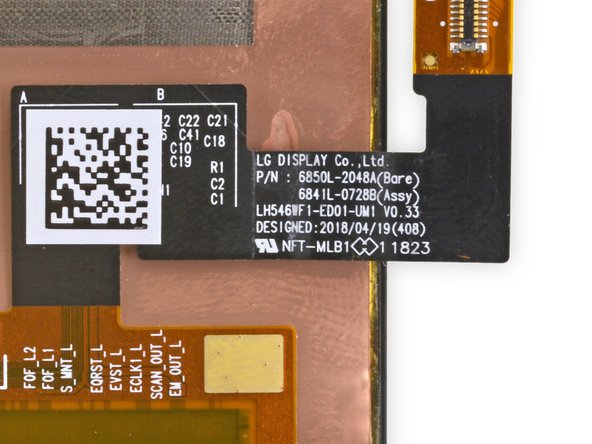

    • In the name of science, we opt to dismantle our display to learn from whence it came. Its defenses are strong, but no match for heat, patience, and a can-do attitude.
    • At first, the frame's black border tricks us into thinking the display curves down to the frame. Future pryers, beware!
    • Drumroll please.... it's a Samsung! Rumors were all over the place, but it looks like Google is going with Samsung's trusty AMOLED panels this year.
    • Samsung's panels should be a little more reliable than last year's, but unfortunately this one comes with a Samsung-esque repair process as well.
    • Replacing a Pixel 3 screen will be tricky, and will most likely require replacing the whole frame of the phone.
    • Last, but not least, a display chip sitting alone on the display cable:
    • Samsung S6SY761X touch controller (as seen on the S9+)
    • GigaDevice GD25LQ80 8 Mb serial flash memory
  15. Google Pixel 3 XL Teardown: crwdns2935265:015crwdnd2935265:01crwdnd2935265:02crwdne2935265:0 Google Pixel 3 XL Teardown: crwdns2935265:015crwdnd2935265:02crwdnd2935265:02crwdne2935265:0
    • Teardown Update: since you asked, we dissected the display in the smaller Pixel 3 as well. Guess what? This one's from LG Display!
    • So it's a full reversal from the situation last year, where the Pixel 2 got a Samsung panel and its bigger sibling had a display from LG.
    • Rumor has it LG has been working hard to improve its OLED mobile technology—we're curious to see how their new display fares this year.

To be clear, are BOTH the Pixel 3 and 3XL using Samsung screens? Please say yes.
Benoit Pronovost - crwdns2934203:0crwdne2934203:0
I came to ask the same question, so I'm subscribing to hear the answer!
David Jordan Nestor -
Surprise: it’s a LG panel! We’ve added step 14 to reflect this. Thank you for all your patience!
Arthur Shi -
