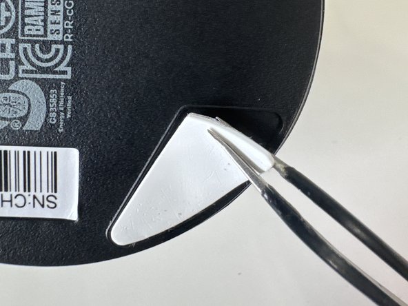

  2. Glorious Model O2 Pro Teardown, Remove feet: crwdns2935265:02crwdnd2935265:01crwdnd2935265:03crwdne2935265:0 Glorious Model O2 Pro Teardown, Remove feet: crwdns2935265:02crwdnd2935265:02crwdnd2935265:03crwdne2935265:0 Glorious Model O2 Pro Teardown, Remove feet: crwdns2935265:02crwdnd2935265:03crwdnd2935265:03crwdne2935265:0
    • Remove top and bottom feet
    • Make sure to keep these and don't loose then

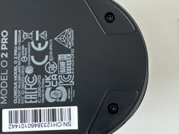

  3. Glorious Model O2 Pro Teardown, Remove Screws: crwdns2935265:03crwdnd2935265:01crwdnd2935265:03crwdne2935265:0 Glorious Model O2 Pro Teardown, Remove Screws: crwdns2935265:03crwdnd2935265:02crwdnd2935265:03crwdne2935265:0 Glorious Model O2 Pro Teardown, Remove Screws: crwdns2935265:03crwdnd2935265:03crwdnd2935265:03crwdne2935265:0
    • Use a PH001 Screwdriver to remove both screws

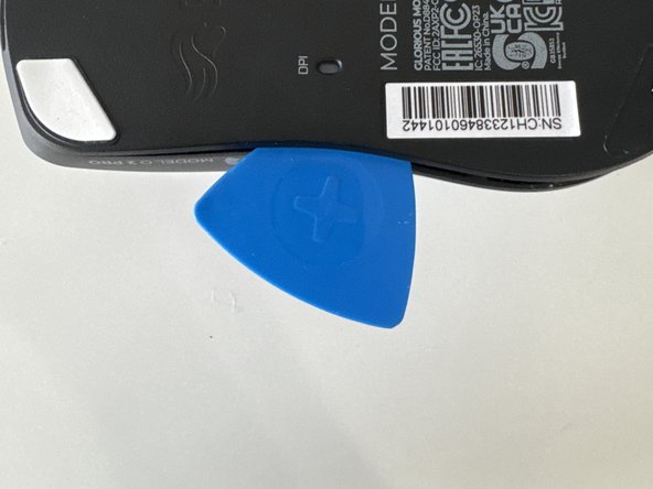

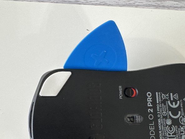

  4. Glorious Model O2 Pro Teardown, Unclip Plastic Piece: crwdns2935265:04crwdnd2935265:01crwdnd2935265:03crwdne2935265:0 Glorious Model O2 Pro Teardown, Unclip Plastic Piece: crwdns2935265:04crwdnd2935265:02crwdnd2935265:03crwdne2935265:0 Glorious Model O2 Pro Teardown, Unclip Plastic Piece: crwdns2935265:04crwdnd2935265:03crwdnd2935265:03crwdne2935265:0
    • (Ignore Bird Sticker)
    • Slide in an opening pick and gently wiggle across the plate
  5. Glorious Model O2 Pro Teardown, Same as step 4: crwdns2935265:05crwdnd2935265:01crwdnd2935265:01crwdne2935265:0
    • After undoing the last clip the playe should come off to reveal…. (Drum roll) More Clips!

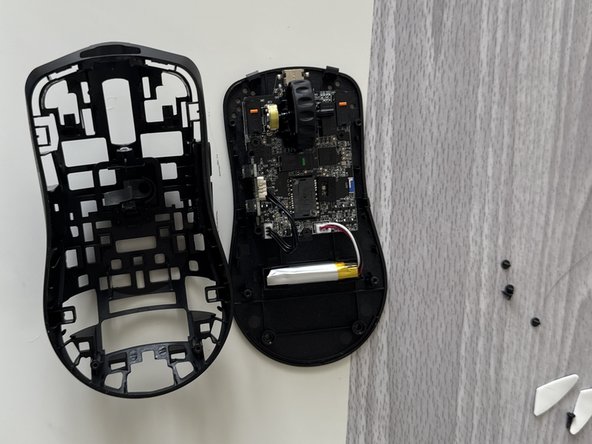

  8. Glorious Model O2 Pro Teardown, Remove Inner shell: crwdns2935265:08crwdnd2935265:01crwdnd2935265:03crwdne2935265:0 Glorious Model O2 Pro Teardown, Remove Inner shell: crwdns2935265:08crwdnd2935265:02crwdnd2935265:03crwdne2935265:0 Glorious Model O2 Pro Teardown, Remove Inner shell: crwdns2935265:08crwdnd2935265:03crwdnd2935265:03crwdne2935265:0
    • Do a combination of using the puck and prying with your hands use caution because the motherboard and battery cables can be damaged
  9. Glorious Model O2 Pro Teardown, Remove housing: crwdns2935265:09crwdnd2935265:01crwdnd2935265:02crwdne2935265:0 Glorious Model O2 Pro Teardown, Remove housing: crwdns2935265:09crwdnd2935265:02crwdnd2935265:02crwdne2935265:0
    • Lift it from the housing
  10. Glorious Model O2 Pro Teardown, Unplug battery: crwdns2935265:010crwdnd2935265:01crwdnd2935265:02crwdne2935265:0 Glorious Model O2 Pro Teardown, Unplug battery: crwdns2935265:010crwdnd2935265:02crwdnd2935265:02crwdne2935265:0
    • Unplug the JST connector from the lipo-cell battery
  11. Glorious Model O2 Pro Teardown, Remove mainboard: crwdns2935265:011crwdnd2935265:01crwdnd2935265:02crwdne2935265:0 Glorious Model O2 Pro Teardown, Remove mainboard: crwdns2935265:011crwdnd2935265:02crwdnd2935265:02crwdne2935265:0
    • Unscew the 3 smaller screws then remove mainboard from housing
    • Thanks for reading my first ifixit guide (R.I.P my prying puck)
