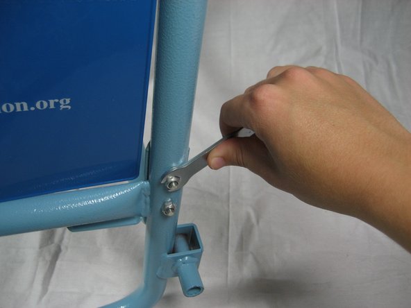

  2. GEN 2 Wheelchair Teardown: crwdns2935265:02crwdnd2935265:01crwdnd2935265:03crwdne2935265:0 GEN 2 Wheelchair Teardown: crwdns2935265:02crwdnd2935265:02crwdnd2935265:03crwdne2935265:0 GEN 2 Wheelchair Teardown: crwdns2935265:02crwdnd2935265:03crwdnd2935265:03crwdne2935265:0
    • Remove the footrest by unscrewing the lower bolt, using the 10 mm wrench.
    • Remove the upper bolt above the socket.
    • Slide out the footrest and unscrew the plate welded to the socket.
    • Slide the plate upward and off of the track to remove.
    • Untie the foot retention belt.

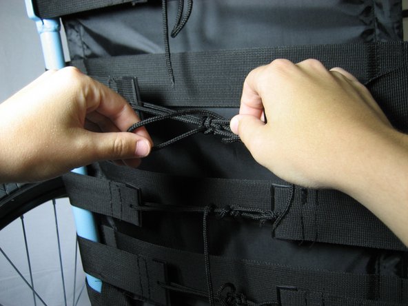

  3. GEN 2 Wheelchair Teardown: crwdns2935265:03crwdnd2935265:01crwdnd2935265:02crwdne2935265:0 GEN 2 Wheelchair Teardown: crwdns2935265:03crwdnd2935265:02crwdnd2935265:02crwdne2935265:0
    • Undo the seatbelt.
    • Remove the seat cushion by pulling it off of the velcro.
    • Remove the back padding by untieing the straps attached to the back pad.

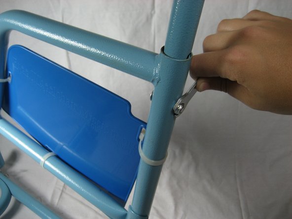

  4. GEN 2 Wheelchair Teardown: crwdns2935265:04crwdnd2935265:01crwdnd2935265:01crwdne2935265:0
    • Turn the wheelchair upside down and untie the plastic seat.
    • Remove the plastic seat support.

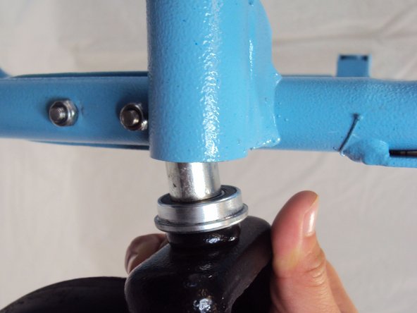

  6. GEN 2 Wheelchair Teardown: crwdns2935265:06crwdnd2935265:01crwdnd2935265:02crwdne2935265:0 GEN 2 Wheelchair Teardown: crwdns2935265:06crwdnd2935265:02crwdnd2935265:02crwdne2935265:0
    • Remove the caster wheels by unscrewing the bolt under the cap with a 19 mm wrench.
    • Lift the wheelchair up to pull the caster wheels off.
    • Use caution: The metal sheath and the bearing of the caster wheel is not attached and may fall off upon removal.

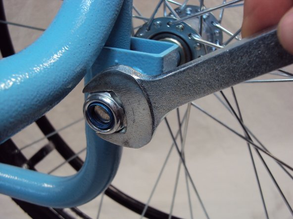

  8. GEN 2 Wheelchair Teardown: crwdns2935265:08crwdnd2935265:01crwdnd2935265:02crwdne2935265:0 GEN 2 Wheelchair Teardown: crwdns2935265:08crwdnd2935265:02crwdnd2935265:02crwdne2935265:0
    • Remove the wheels by placing a 19 mm socket wrench on the inside of the wheel and unscrew the bolt.
    • Unscrew the bolt on the outside of the wheel by using a 19 mm socket wrench.
