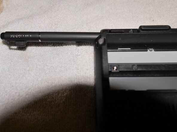

  3. Fujitsu T902 Teardown: crwdns2935265:03crwdnd2935265:01crwdnd2935265:02crwdne2935265:0 Fujitsu T902 Teardown: crwdns2935265:03crwdnd2935265:02crwdnd2935265:02crwdne2935265:0
    • Remove expansion bay device. (battery, disk drive, weight saver)
    • Remove stylus pen.

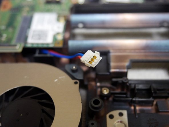

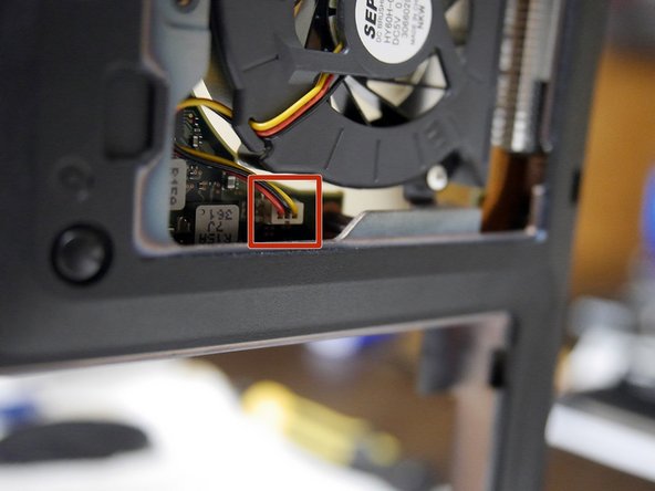

  5. Fujitsu T902 Teardown: crwdns2935265:05crwdnd2935265:01crwdnd2935265:02crwdne2935265:0 Fujitsu T902 Teardown: crwdns2935265:05crwdnd2935265:02crwdnd2935265:02crwdne2935265:0
    • Remove RAM.
    • Unplug system fan. (also indicated in picture two)

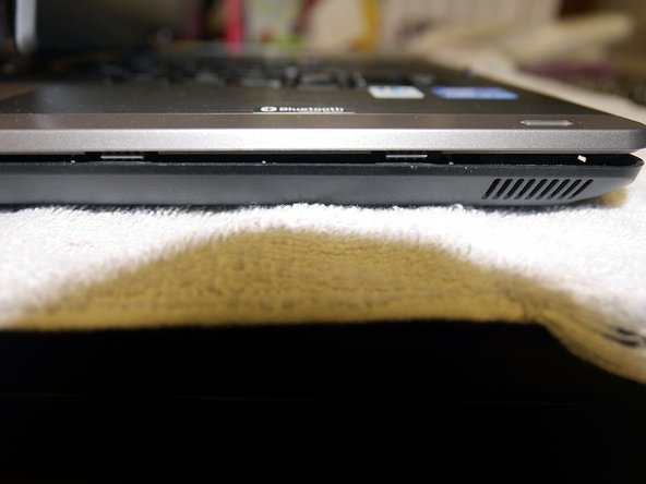

  7. Fujitsu T902 Teardown: crwdns2935265:07crwdnd2935265:01crwdnd2935265:03crwdne2935265:0 Fujitsu T902 Teardown: crwdns2935265:07crwdnd2935265:02crwdnd2935265:03crwdne2935265:0 Fujitsu T902 Teardown: crwdns2935265:07crwdnd2935265:03crwdnd2935265:03crwdne2935265:0

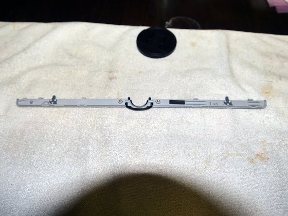

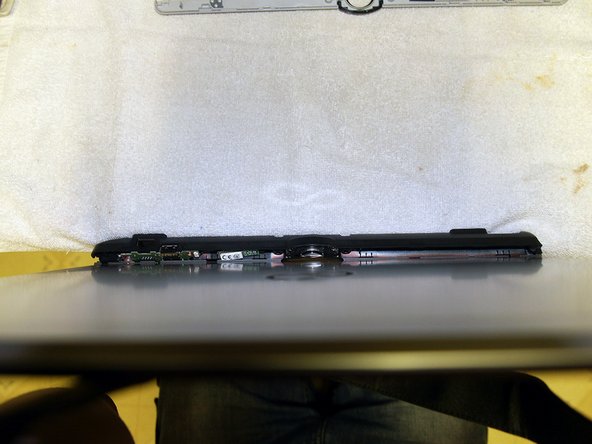

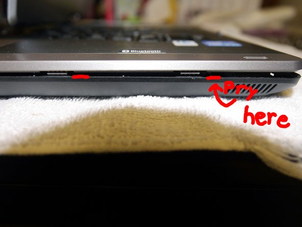

    • Next we are going to remove the keyboard top, this gives access to the inside of the laptop.
    • There are three tabs on the keyboard cover that keep it attached. (indicated by picture one)
    • Picture two you can see them disconnected, using a finger nail or electronic case opener gently release the tab by applying outward force on the black plastic part of the case.
  8. Fujitsu T902 Teardown: crwdns2935265:08crwdnd2935265:01crwdnd2935265:03crwdne2935265:0 Fujitsu T902 Teardown: crwdns2935265:08crwdnd2935265:02crwdnd2935265:03crwdne2935265:0 Fujitsu T902 Teardown: crwdns2935265:08crwdnd2935265:03crwdnd2935265:03crwdne2935265:0
    • After unlatching the three tabs from the last step you should be able to remove the keyboard trim underneath the screen.
    • Apply gentle force around the edges to unhook any tabs and it should come right out.

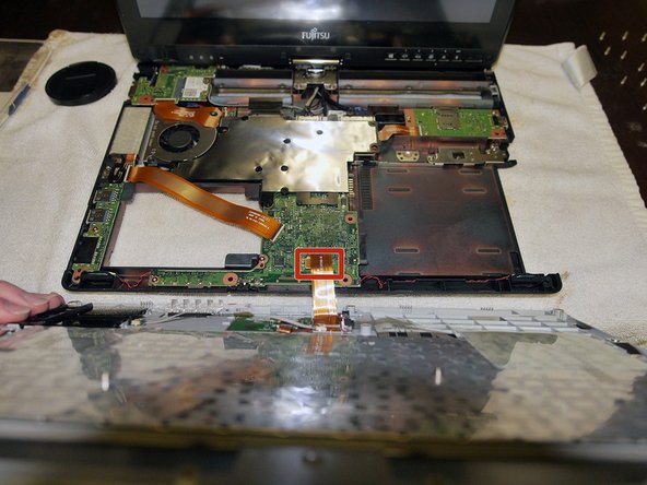

    • With the tabs unlatched and the keyboard trim removed you should be able to easily pivot the keyboard cover as shown.
    • Be careful not to pull on the data cable still tethered to the motherboard.
    • Using a fingernail or spudger disconnect the trackpad/keyboard data cable, then set aside the keyboard cover.
    • Same connector style as the HDD cable.

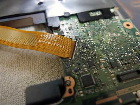

  10. Fujitsu T902 Teardown: crwdns2935265:010crwdnd2935265:01crwdnd2935265:03crwdne2935265:0 Fujitsu T902 Teardown: crwdns2935265:010crwdnd2935265:02crwdnd2935265:03crwdne2935265:0 Fujitsu T902 Teardown: crwdns2935265:010crwdnd2935265:03crwdnd2935265:03crwdne2935265:0
    • Remove the data ribbon cable indicated.
    • Very gently using a fingernail or small spudger lift up on the dark plastic part of the ZIF connectors. (illustrated in pictures two and three)
    • After unlatching both locks you can lift up on the cable and set it to the side.

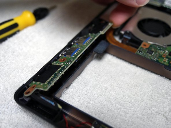

  13. Fujitsu T902 Teardown: crwdns2935265:013crwdnd2935265:01crwdnd2935265:03crwdne2935265:0 Fujitsu T902 Teardown: crwdns2935265:013crwdnd2935265:02crwdnd2935265:03crwdne2935265:0 Fujitsu T902 Teardown: crwdns2935265:013crwdnd2935265:03crwdnd2935265:03crwdne2935265:0
    • Next we are removing the USB and audio board. The blue circle is indicated where the only screw is, use your trust PH1 bit.
    • Use a fingernail or spudger to lift up the board as shown before pulling it out.

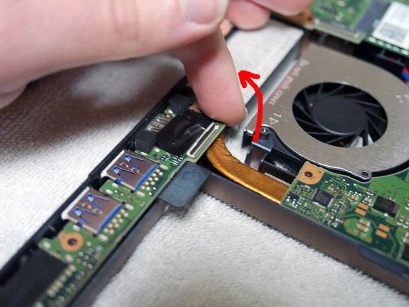

  14. Fujitsu T902 Teardown: crwdns2935265:014crwdnd2935265:01crwdnd2935265:01crwdne2935265:0
    • Disconnect the indicated side of the ribbon data cable.
    • Same connector as step 10.

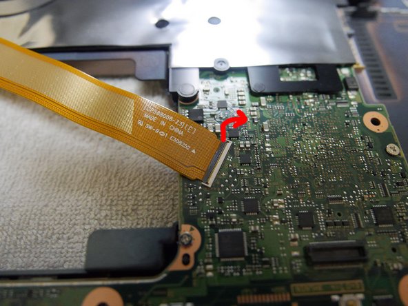

  15. Fujitsu T902 Teardown: crwdns2935265:015crwdnd2935265:01crwdnd2935265:01crwdne2935265:0
    • Same kind of connector as step 10 & 14.

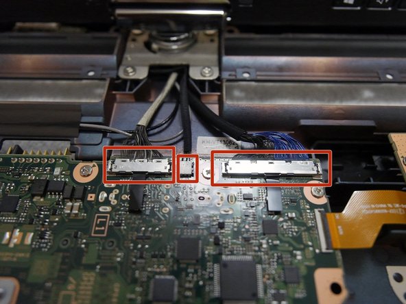

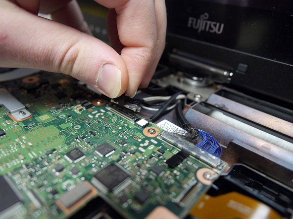

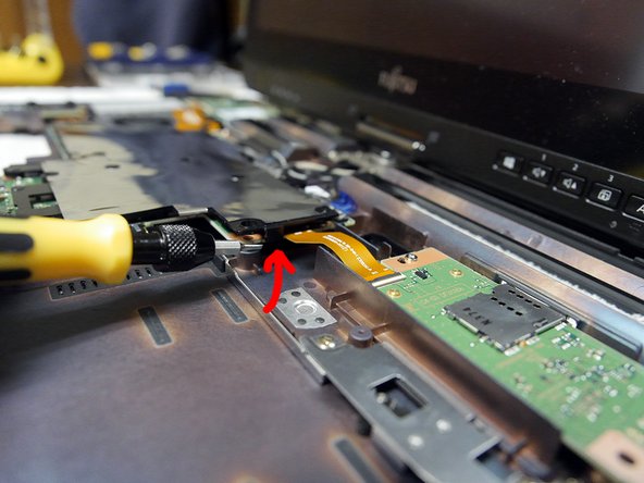

  16. Fujitsu T902 Teardown, Next we prepare to remove the display.: crwdns2935265:016crwdnd2935265:01crwdnd2935265:03crwdne2935265:0 Fujitsu T902 Teardown, Next we prepare to remove the display.: crwdns2935265:016crwdnd2935265:02crwdnd2935265:03crwdne2935265:0 Fujitsu T902 Teardown, Next we prepare to remove the display.: crwdns2935265:016crwdnd2935265:03crwdnd2935265:03crwdne2935265:0
    • Remove the wifi antennas. (picture one)
    • Remove the display, touch, and backlight connectors from the motherboard as indicated in pictures two and three.

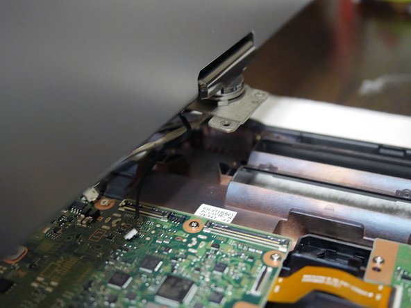

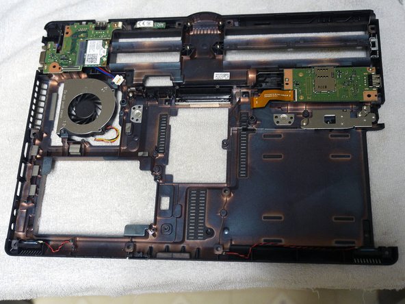

  17. Fujitsu T902 Teardown: crwdns2935265:017crwdnd2935265:01crwdnd2935265:02crwdne2935265:0 Fujitsu T902 Teardown: crwdns2935265:017crwdnd2935265:02crwdnd2935265:02crwdne2935265:0
    • After disconnecting the display connections we are ready to unscrew the display mount screws.
    • Use the trusty PH1 bit to take out the 4 screws indicated in picture one.
    • You can now lift out the display assembly, 2 antennas and 3 cables will be attached to it. Set it aside.

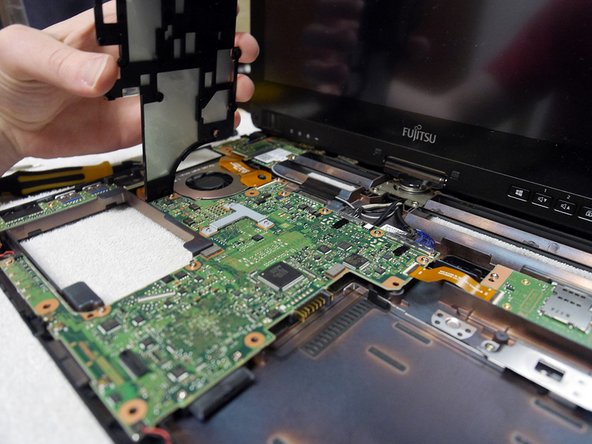

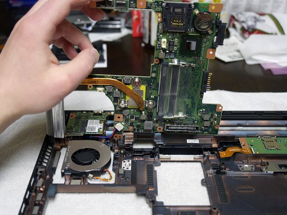

  18. Fujitsu T902 Teardown, Now it's time to remove the motherboard.: crwdns2935265:018crwdnd2935265:01crwdnd2935265:02crwdne2935265:0 Fujitsu T902 Teardown, Now it's time to remove the motherboard.: crwdns2935265:018crwdnd2935265:02crwdnd2935265:02crwdne2935265:0
    • Remove the 9 screws indicated in picture 1 with PH1 bit.
    • Pivot the motherboard up from the front as indicated in picture 2.

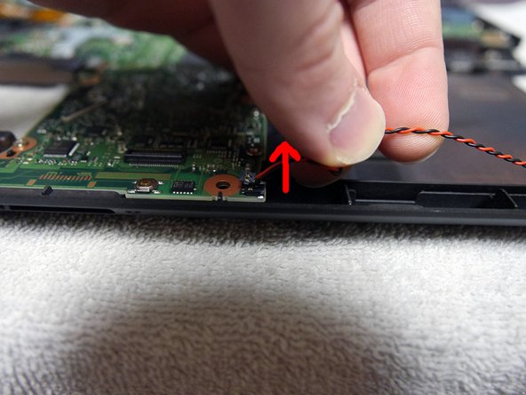

  19. Fujitsu T902 Teardown: crwdns2935265:019crwdnd2935265:01crwdnd2935265:03crwdne2935265:0 Fujitsu T902 Teardown: crwdns2935265:019crwdnd2935265:02crwdnd2935265:03crwdne2935265:0 Fujitsu T902 Teardown: crwdns2935265:019crwdnd2935265:03crwdnd2935265:03crwdne2935265:0
    • Next we must disconnect the power plug from the motherboard before we can remove it.
    • This connector is the same style as from step 12.
    • Now you can remove the motherboard and set it aside on an anti-static bag or surface.
    • The motherboard is very sensitive so handle it with care by only touching the edges of the board and make sure you are properly grounded to ensure no ESD occurs.

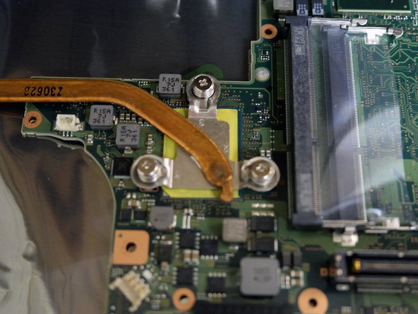

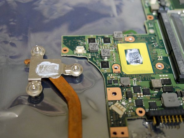

  20. Fujitsu T902 Teardown, Let's have a look at the motherboard.: crwdns2935265:020crwdnd2935265:01crwdnd2935265:03crwdne2935265:0 Fujitsu T902 Teardown, Let's have a look at the motherboard.: crwdns2935265:020crwdnd2935265:02crwdnd2935265:03crwdne2935265:0 Fujitsu T902 Teardown, Let's have a look at the motherboard.: crwdns2935265:020crwdnd2935265:03crwdnd2935265:03crwdne2935265:0
    • Heatsink is very inadequate, which is why this laptop gets noticeably high temperatures.
    • Board appears to be well designed and made to the highest of quality standards.
    • Thermal paste appears to be gooped on but applying an alternative had no significant advantages.
