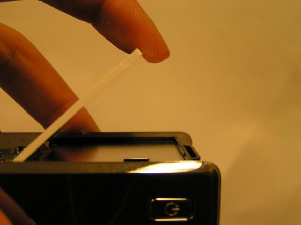

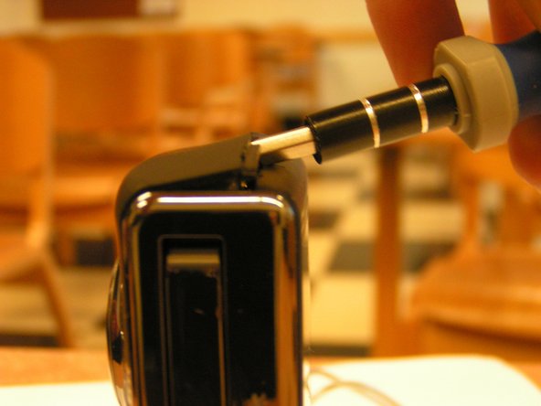

    • Pry off the top of the camcorder with a flat head screwdriver. The cover is glued on with adhesive so it will take some force to dislodge it from the device.

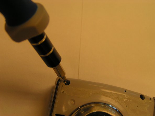

    • Use a small Phillips head screwdriver to remove the two screws at the bottom of the battery slot and the two screws above the camera lens.

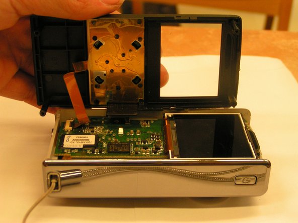

    • Gently pull off back cover of the camcorder. Once again, it is glued with adhesive
  7. Flip Ultra HD Teardown: crwdns2935265:07crwdnd2935265:01crwdnd2935265:02crwdne2935265:0 Flip Ultra HD Teardown: crwdns2935265:07crwdnd2935265:02crwdnd2935265:02crwdne2935265:0
    • Remove the ribbon cable gently and pull the back cover off

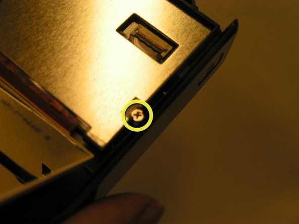

    • Remove all of the screws on the circuit board
    • Make sure to remove the screw behind the display

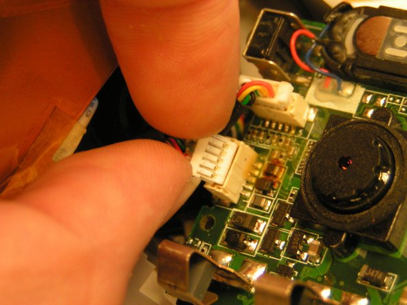

  9. Flip Ultra HD Teardown: crwdns2935265:09crwdnd2935265:01crwdnd2935265:02crwdne2935265:0 Flip Ultra HD Teardown: crwdns2935265:09crwdnd2935265:02crwdnd2935265:02crwdne2935265:0
    • There are two wires with white heads connecting the circuit board to the front of the device. Gently pull them from their slots to detach the front casing from the circuit board.
