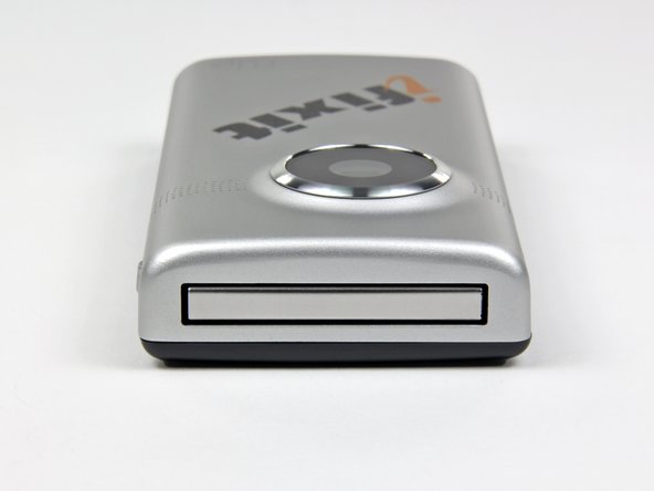

    • What's better than a Flip MinoHD? A custom-labeled Flip MinoHD!
    • Eight unique touch-sensitive capacitive buttons (power, play, delete, record and four-way navigation) allow for ease of use.
    • An mini-HDMI output connector makes it easy to watch video on your HDTV.
    • There's also a tripod mount that fits any standard tripod.

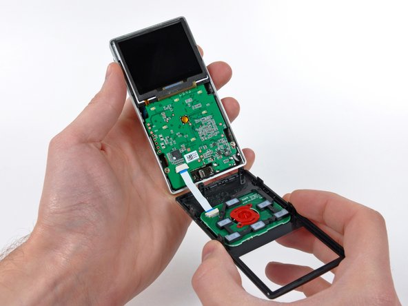

    • Push the front panel toward the top edge of the MinoHD to release it from the mounting tabs along its top inner edge.
    • Don't try to remove the front panel just yet! It is still attached to the logic board by a small ribbon cable.

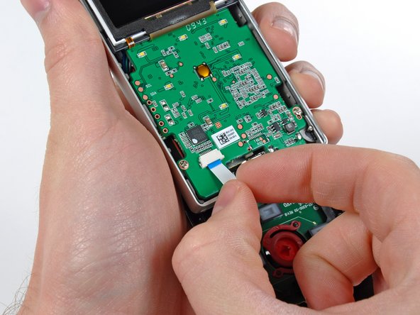

    • Carefully rotate the front panel away from the rest of the MinoHD.
    • Pull the control panel ribbon cable away from its socket on the logic board.

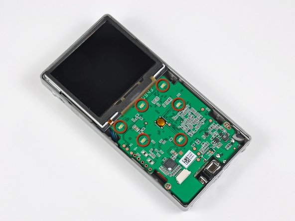

    • There's not too much interesting going on inside the front panel.
    • Capacitive sensors under each of the control symbols (play, back, etc.) provide the logic board with control data, while small LEDs mounted to the logic board (shown in red) under each "button" project light through the front panel to provide their illumination.

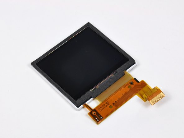

  8. Flip MinoHD Teardown: crwdns2935265:08crwdnd2935265:01crwdnd2935265:02crwdne2935265:0 Flip MinoHD Teardown: crwdns2935265:08crwdnd2935265:02crwdnd2935265:02crwdne2935265:0

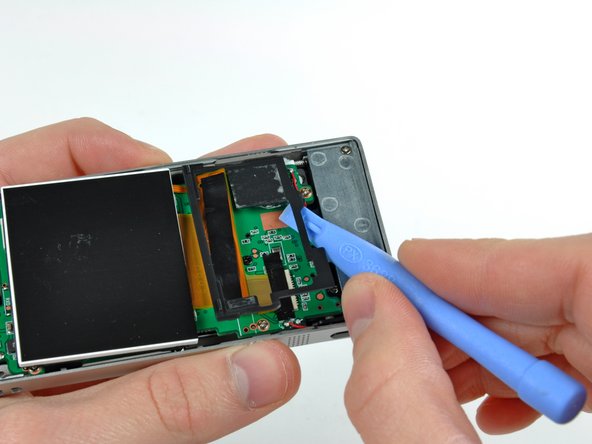

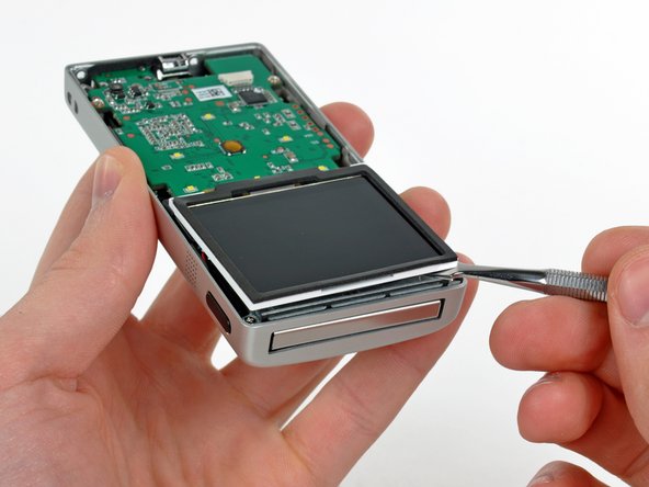

    • Use a plastic opening tool to carefully lift the top edge of the display out of its bracket.
    • It may be necessary to use a metal spudger to release a small piece of film stuck between the LCD and the display bracket.
  9. Flip MinoHD Teardown: crwdns2935265:09crwdnd2935265:01crwdnd2935265:03crwdne2935265:0 Flip MinoHD Teardown: crwdns2935265:09crwdnd2935265:02crwdnd2935265:03crwdne2935265:0 Flip MinoHD Teardown: crwdns2935265:09crwdnd2935265:03crwdnd2935265:03crwdne2935265:0

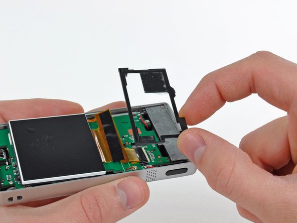

    • To access the display data cable, use a plastic opening tool to pry the metal and plastic display brackets off the logic board.
  10. Flip MinoHD Teardown: crwdns2935265:010crwdnd2935265:01crwdnd2935265:02crwdne2935265:0 Flip MinoHD Teardown: crwdns2935265:010crwdnd2935265:02crwdnd2935265:02crwdne2935265:0
    • Carefully use your fingernail to flip up the retaining flap on the display data cable ZIF socket.
    • Pull the display data cable out of its socket and remove the display.
    • Interesting note: On-board video playback is provided by a 2" 960x240 transflective TFT LCD display.

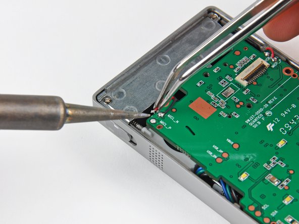

  11. Flip MinoHD Teardown: crwdns2935265:011crwdnd2935265:01crwdnd2935265:03crwdne2935265:0 Flip MinoHD Teardown: crwdns2935265:011crwdnd2935265:02crwdnd2935265:03crwdne2935265:0 Flip MinoHD Teardown: crwdns2935265:011crwdnd2935265:03crwdnd2935265:03crwdne2935265:0

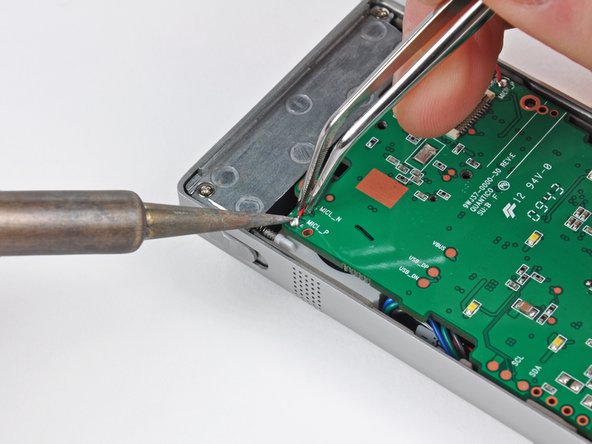

    • Remove the four silver Phillips screws attaching the logic board to the outer case.
    • To remove the logic board, you must first de-solder the leads of both microphones from the logic board. When soldering on a circuit board, be sure not to heat up the connection excessively.
    • Use a pair of tweezers to gently pull each lead as you heat up the joint with the tip of a soldering iron.
    • Repeat this process to remove all four microphone leads. Their locations are boxed in orange on the first picture.

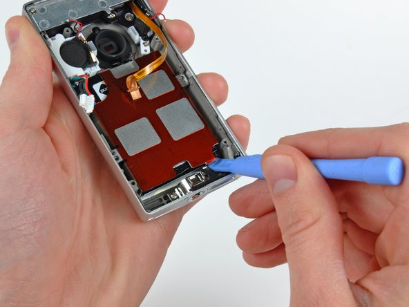

    • Remove the two small silver Phillips screws securing the battery to the outer case.
    • Use a plastic opening tool to pry the battery up off the outer case.

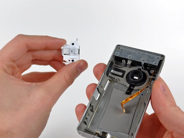

  14. Flip MinoHD Teardown: crwdns2935265:014crwdnd2935265:01crwdnd2935265:03crwdne2935265:0 Flip MinoHD Teardown: crwdns2935265:014crwdnd2935265:02crwdnd2935265:03crwdne2935265:0 Flip MinoHD Teardown: crwdns2935265:014crwdnd2935265:03crwdnd2935265:03crwdne2935265:0

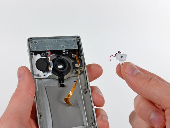

    • Remove the three Phillips screws securing both microphones to the outer case.
    • The microphone assembly on the left also houses a small speaker for audio during video playback. It connects to the board via two spring-loaded pressure contacts.
    • Lift both microphones off the inner surface of the outer case.

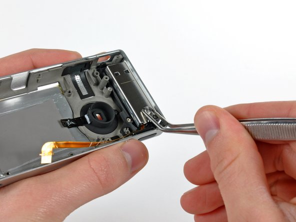

  15. Flip MinoHD Teardown: crwdns2935265:015crwdnd2935265:01crwdnd2935265:03crwdne2935265:0 Flip MinoHD Teardown: crwdns2935265:015crwdnd2935265:02crwdnd2935265:03crwdne2935265:0 Flip MinoHD Teardown: crwdns2935265:015crwdnd2935265:03crwdnd2935265:03crwdne2935265:0

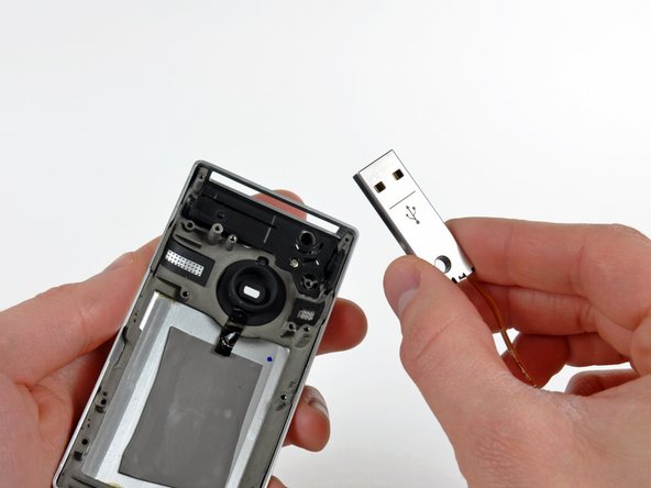

    • Remove the four Phillips screws securing the aluminum USB bracket to the outer case.
    • Use a pair of tweezers to pull the flip-up USB axle away from the outer case.
    • Once the axle clears the outer case, the flip-up USB connector may be ejected at high speed. Wear safety glasses.

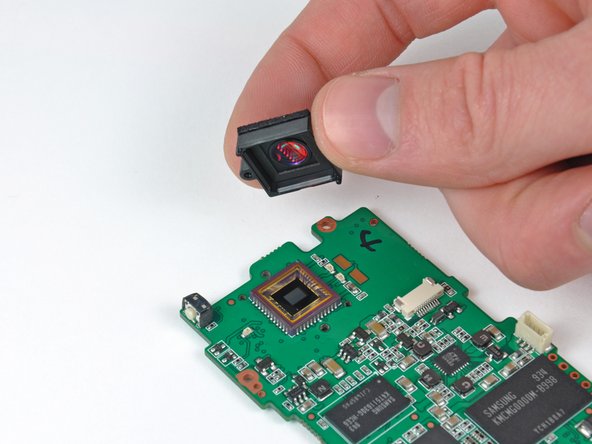

  16. Flip MinoHD Teardown: crwdns2935265:016crwdnd2935265:01crwdnd2935265:03crwdne2935265:0 Flip MinoHD Teardown: crwdns2935265:016crwdnd2935265:02crwdnd2935265:03crwdne2935265:0 Flip MinoHD Teardown: crwdns2935265:016crwdnd2935265:03crwdnd2935265:03crwdne2935265:0
    • Remove the two Phillips screws securing the camera lens to the logic board.
    • Lift the camera lens off the board to reveal the CMOS sensor.
    • The high definition CMOS sensor has .0000022 meter wide pixels to capture clear 720p video.

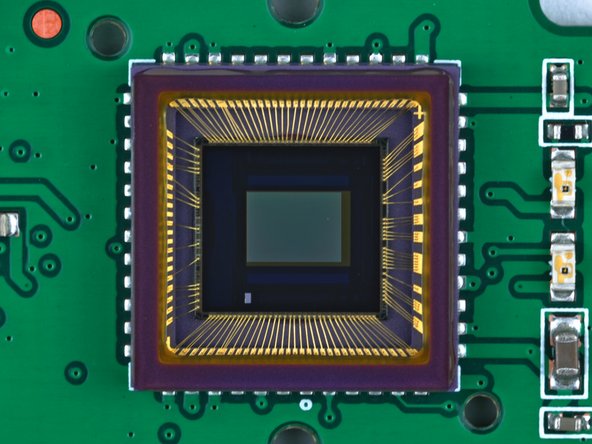

  18. Flip MinoHD Teardown: crwdns2935265:018crwdnd2935265:01crwdnd2935265:02crwdne2935265:0 Flip MinoHD Teardown: crwdns2935265:018crwdnd2935265:02crwdnd2935265:02crwdne2935265:0

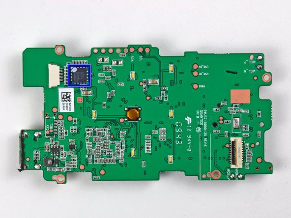

    • The big players on the logic board include:
    • A Zoran COACH (camera on a chip) 12 processor featuring real-time lens distortion compensation and noise reduction.
    • Samsung's 934 KMCMG0000M-B998 8 GB NAND flash memory for video storage.
    • One Samsung K4T51163QG 512 Mb DDR2 SDRAM chip.
    • Texas Instruments' TPD12S521 to protect the board from electrostatic discharge through the HDMI port.
    • Cypress' CY821434-24LXTI PSoC presumably for encoding signals received from the capacitive touch controls.
