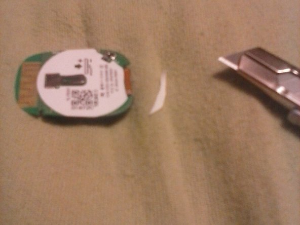

    • Use your knife to slice off the bottom edge of the sticker found here on the rear of the board

  5. Fitbit Zip Teardown: crwdns2935265:05crwdnd2935265:01crwdnd2935265:01crwdne2935265:0
    • Seems to be it. The display doesn't appear to be separable from the logic board, sadly, making repairability completely out of the question.

The display can be separated from the logic board, just pull it free from the logic board connector.
