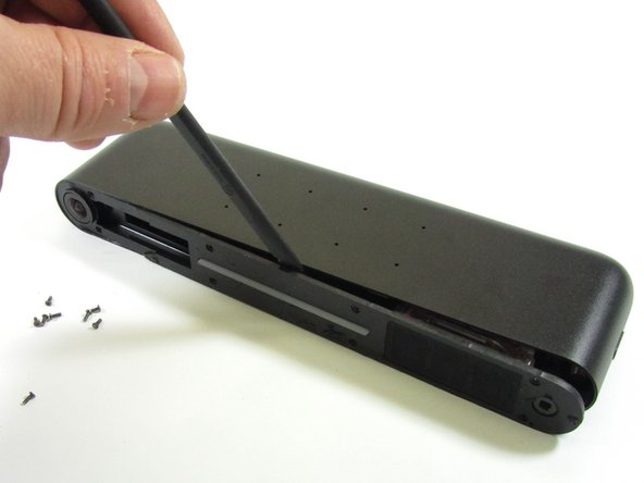

    • At first there didn't seem to be way into this device
    • Flipping the device upside down, there was cover between the enclosure, and the base. Removing this cover revealed sixteen T5 screws
    • Removing the sixteen screws, only removed the base
    • There was still no obvious way into to the product
  4. Facebook Portal TV Teardown: crwdns2935265:04crwdnd2935265:01crwdnd2935265:03crwdne2935265:0 Facebook Portal TV Teardown: crwdns2935265:04crwdnd2935265:02crwdnd2935265:03crwdne2935265:0 Facebook Portal TV Teardown: crwdns2935265:04crwdnd2935265:03crwdnd2935265:03crwdne2935265:0
    • It was time to get the Spudger Tool out and test a few edges
    • Working along the front edge, it appeared that the face plate was glued or held in place with double stick tape
    • The Spudger Tool was use to loosen a gap along the face plate edge
    • A Jimmy Tool was used to further release face plate
    • With the face plate removed
    • We can see the led light pipe
    • We can also see the camera shut off switch
    • LED Light Pipe

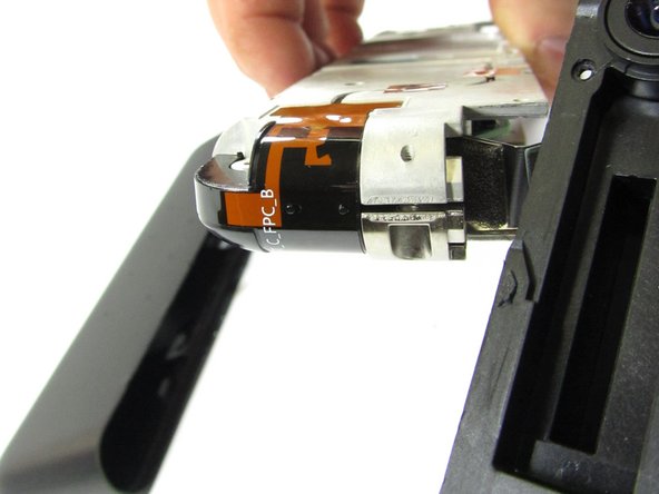

  7. Facebook Portal TV Teardown: crwdns2935265:07crwdnd2935265:01crwdnd2935265:03crwdne2935265:0 Facebook Portal TV Teardown: crwdns2935265:07crwdnd2935265:02crwdnd2935265:03crwdne2935265:0 Facebook Portal TV Teardown: crwdns2935265:07crwdnd2935265:03crwdnd2935265:03crwdne2935265:0
    • We can now use tweezers to remove the speaker cable attaching the front panel to the rest of the enclosure.
    • Then we can slide out the metal enclosure that holds the electronics from the main enclosure
    • Now use we can use tweezers to flip up the flex cable lock latch to release the flex cable attached to the main electronics in the metal enclosure and outer body. As will be seen shortly, this cable goes to a microphone array PCB in top of the outer enclosure
  8. Facebook Portal TV Teardown: crwdns2935265:08crwdnd2935265:01crwdnd2935265:03crwdne2935265:0 Facebook Portal TV Teardown: crwdns2935265:08crwdnd2935265:02crwdnd2935265:03crwdne2935265:0 Facebook Portal TV Teardown: crwdns2935265:08crwdnd2935265:03crwdnd2935265:03crwdne2935265:0
    • Now with the outer enclosure removed, and the front plate removed we can work on opening up the metal enclosure that contains the main electronics
    • The metal enclosure is held together with eight T5 screws. Use a T5 tool to remove these screws
    • The metal enclosure is also held together on each outer end with a flexible sticker type antenna. These flexible antenna will have to be removed before the metal enclosure can be opened up

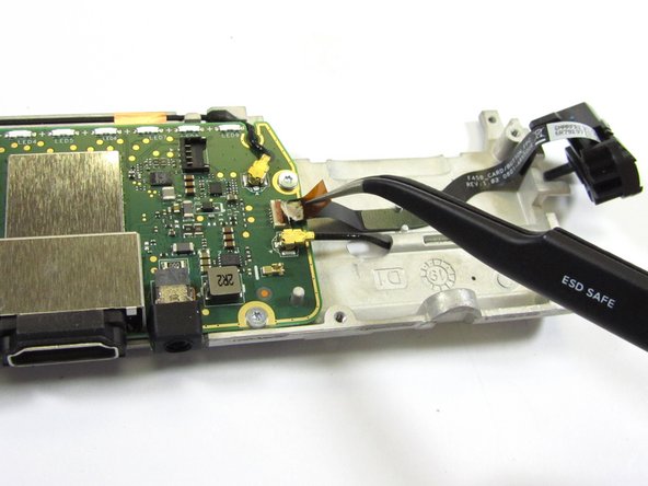

    • Before we can get a closer look at the electronics, we also need to remove the U.FL antenna cables that attached to the main electronics board
    • A Spudger Tool can be used to pry up and off the antenna cables from the U.FL connectors
    • Now use a spudger to remove the main electronics board from the metal enclosure

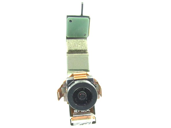

    • With the main electronics board removed, we can now remove the camera that is attached
    • To do this, first remove the plastic film over the camera connector. Then remove camera flex cable by prying up on the connector latch and siding out the camera flex cable free with tweezers
  14. Facebook Portal TV Teardown: crwdns2935265:014crwdnd2935265:01crwdnd2935265:01crwdne2935265:0
    • Camera flex cable is also held in place via a thick plastic block attached to the main electronics PCB. This plastic block can be pulled away from the PCB

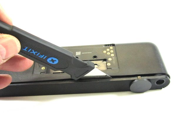

    • As can be seen in the first step photos of this teardown, there are eight pin holes in the top of the main enclosure. These pin holes are for the microphone array. The holes pass sound to the eight MEMS micrphones below the pin holes
    • On the opposite out side of the main enclosure, we see eight circle holes. These hole are covered on the inside by black tape
  16. Facebook Portal TV Teardown: crwdns2935265:016crwdnd2935265:01crwdnd2935265:03crwdne2935265:0 Facebook Portal TV Teardown: crwdns2935265:016crwdnd2935265:02crwdnd2935265:03crwdne2935265:0 Facebook Portal TV Teardown: crwdns2935265:016crwdnd2935265:03crwdnd2935265:03crwdne2935265:0

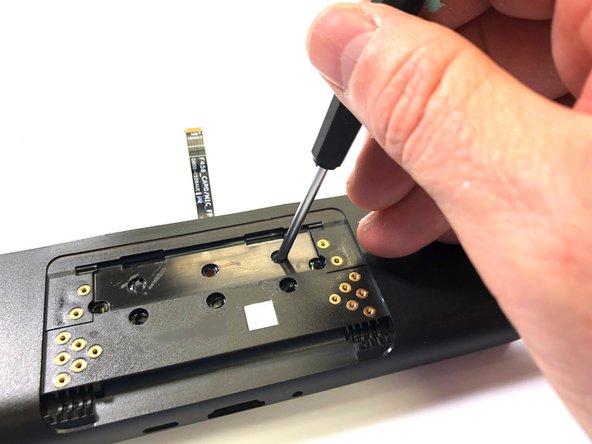

    • We can use tweezers to punch a holes in the black tape to give access to the screws that hold the microphone array PCB on the opposite side of the enclosure
    • Once we have holes punched in the tape we use a T2 Torx bit to remove the screws holding the microphone PCB in enclosure
  17. Facebook Portal TV Teardown: crwdns2935265:017crwdnd2935265:01crwdnd2935265:03crwdne2935265:0 Facebook Portal TV Teardown: crwdns2935265:017crwdnd2935265:02crwdnd2935265:03crwdne2935265:0 Facebook Portal TV Teardown: crwdns2935265:017crwdnd2935265:03crwdnd2935265:03crwdne2935265:0
    • After the microphone array PCB mounting screws have been removed, we can just use the spudger to pry the PCB free. It is also held in place with double stick tape in addition to the screws
    • Once the microphone array board has been removed, we can get a closer look at it

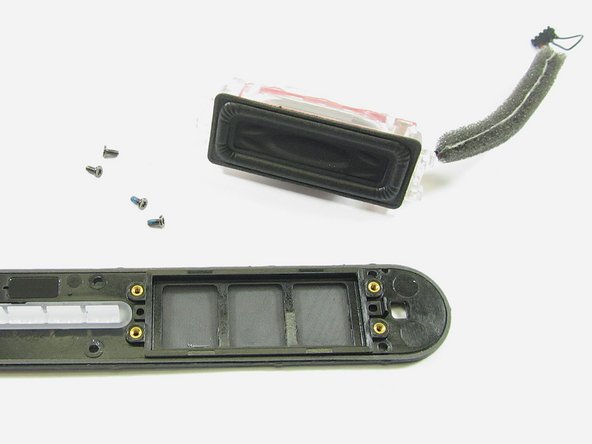

    • Now we can separate the speaker from the front cover
    • The speaker is held in place with four T2 Torx screws. Use a T2 Torx bit to remove these screws

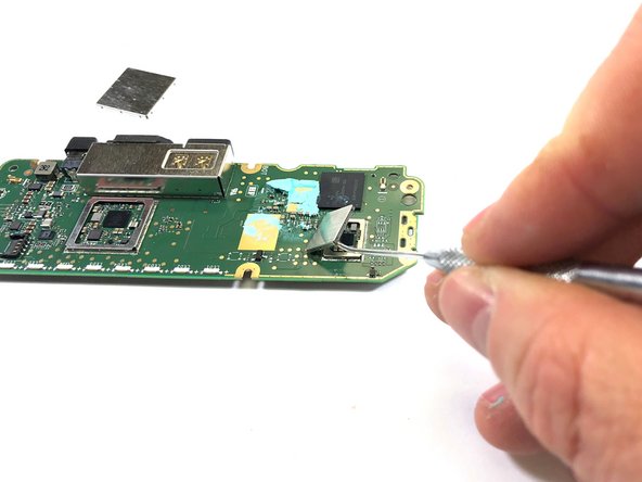

    • Turning our attention back to the main electronics PCB, we need to remove the RF shielding so we can see components under the RF shields
    • Use a pick tool to remove each RF shield. The RF shields are only snapped in place and can be easily removed
  21. Facebook Portal TV Teardown: crwdns2935265:021crwdnd2935265:01crwdnd2935265:02crwdne2935265:0 Facebook Portal TV Teardown: crwdns2935265:021crwdnd2935265:02crwdnd2935265:02crwdne2935265:0
    • Now flip the main electronics board over and remove two more RF shields
    • Use a dental pick tool to remove these RF shields
  22. Facebook Portal TV Teardown: crwdns2935265:022crwdnd2935265:01crwdnd2935265:02crwdne2935265:0 Facebook Portal TV Teardown: crwdns2935265:022crwdnd2935265:02crwdnd2935265:02crwdne2935265:0

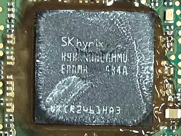

    • With the RF shielding removed, we can take a closer look at the components on the PCB. The main SoC is underneath the SK Hynix Memory, and not easy to access. SK Hynix also makes image processors, so it could be their SoC/imager. A number of parts could not be crossed referenced, if you have information on a part please leave it in the comments
    • FLH - could not cross reference
    • DSP Group D7A1C Audio DSP
    • SK Hynix H9Hknnncrmmuernmh LPDDR4 32GB 256Mx16 PC3733
    • Qualcomm PM8998 Power Management IC (PMIC)
    • Qualcomm WCN3990 - WiFi 2.4Ghz, 5Ghz, 2x2, Dual-band concurrent, 802.11ac
    • Qualcomm 3C/485Z - could not cross reference, but may be power amplifiers for Wi-Fi
    • AW9109 - could not cross reference, but may be an LED driver IC from Shanghai awinic Technology

    • Now, let's review the camera in the unit. The camera lens and imager are combined and not easily separated.
    • The Camera could not be cross-referenced with the marking on the camera flex cable. There are no markings on the camera body.

    • Next, let us review the speaker
    • Speaker part number - 8GVRMS138N9454 - could not cross reference

    • As mention earlier, the SK Hynix DRAM is bonded over the main SoC
