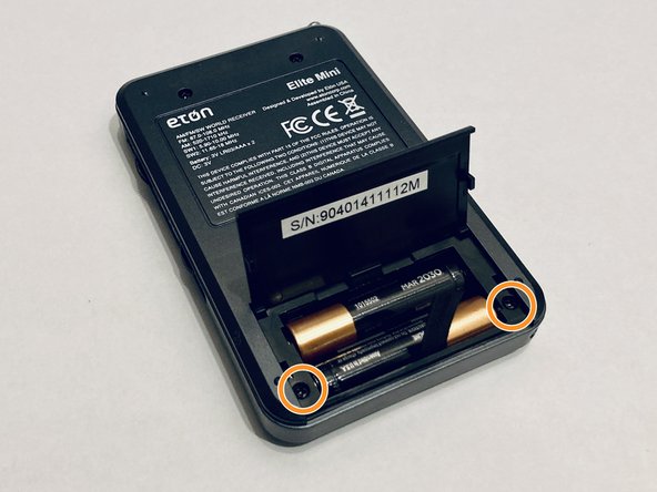

    • Before you begin. Make sure that the device is turned off and the batteries have been removed.
    • To remove the 2 AAA batteries. Press your thumb on the grooves of the battery cover (on the lower back of the radio) and move your thumb downward.
    • You'll see a black battery ribbon once the battery cover has been removed. Gently tug on the battery ribbon to remove the batteries from the compartment.

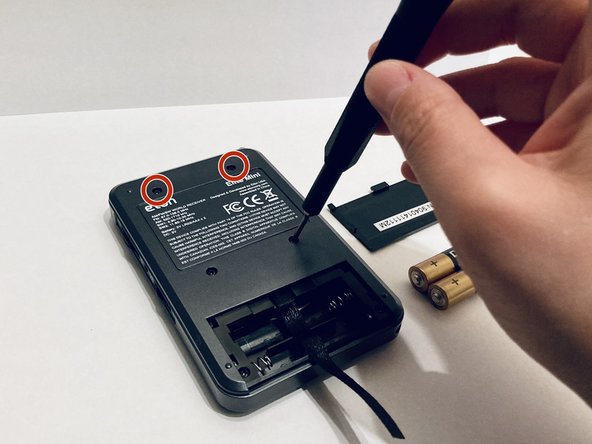

    • For these steps you will need your #000 Philips Head screwdriver bit.
    • Place the radio face-down so the back panel is visible. Then unscrew the four screws located on the top and middle of the back panel.
    • The two top screws are smaller then the two middle screws. If you think you might want to put this back together again it's important to remember where to put each size screw so as to not mess up any internal components.
    • There are two screws inside the battery compartment that also need to be unscrewed. The #000PH will work for this step too. These screws are just as long as the middle screws from the back plate.
