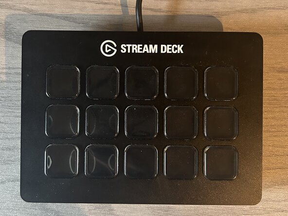

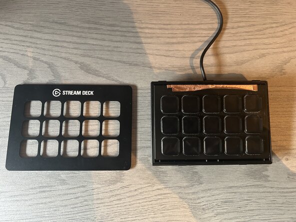

  1. Elgato Stream Deck Classic Teardown, Take off front cover: crwdns2935265:01crwdnd2935265:01crwdnd2935265:02crwdne2935265:0 Elgato Stream Deck Classic Teardown, Take off front cover: crwdns2935265:01crwdnd2935265:02crwdnd2935265:02crwdne2935265:0
    • Pull up from the bottom its held on by some clips and adhesive. All you need are your hands
    • Slowly pull up until the entire front cover is off

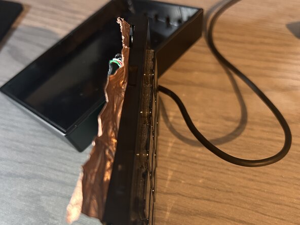

  2. Elgato Stream Deck Classic Teardown, Remove the electrons from the housing: crwdns2935265:02crwdnd2935265:01crwdnd2935265:02crwdne2935265:0 Elgato Stream Deck Classic Teardown, Remove the electrons from the housing: crwdns2935265:02crwdnd2935265:02crwdnd2935265:02crwdne2935265:0
    • Pry up on the bottom
    • Pull out the module be careful to not pull on the cable to hard
  3. Elgato Stream Deck Classic Teardown, Peel off the copper tape: crwdns2935265:03crwdnd2935265:01crwdnd2935265:01crwdne2935265:0
    • Slowly and carefully peel off the copper tape

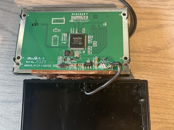

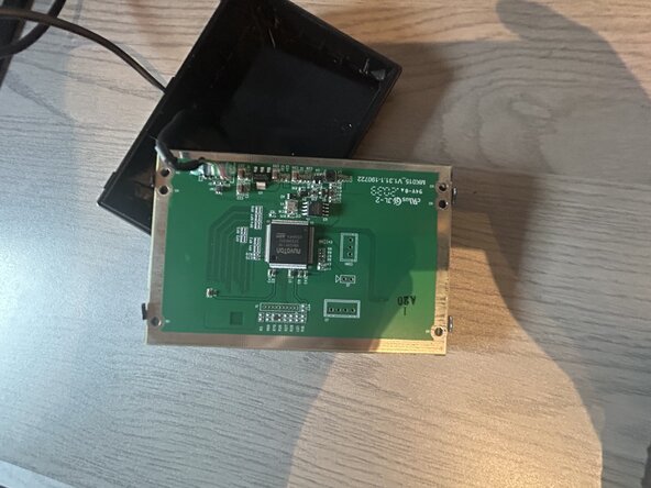

  4. Elgato Stream Deck Classic Teardown, bend the tabs: crwdns2935265:04crwdnd2935265:01crwdnd2935265:02crwdne2935265:0 Elgato Stream Deck Classic Teardown, bend the tabs: crwdns2935265:04crwdnd2935265:02crwdnd2935265:02crwdne2935265:0
    • Bend the tabs on either side of the metal housing out.
    • I recommend using pliers to do this

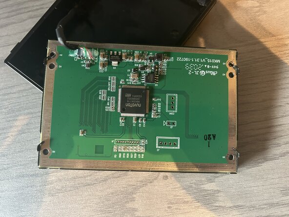

  5. Elgato Stream Deck Classic Teardown, Lift up on the circut board: crwdns2935265:05crwdnd2935265:01crwdnd2935265:01crwdne2935265:0
    • Be carefulk not to break the ribbon cables under the board.

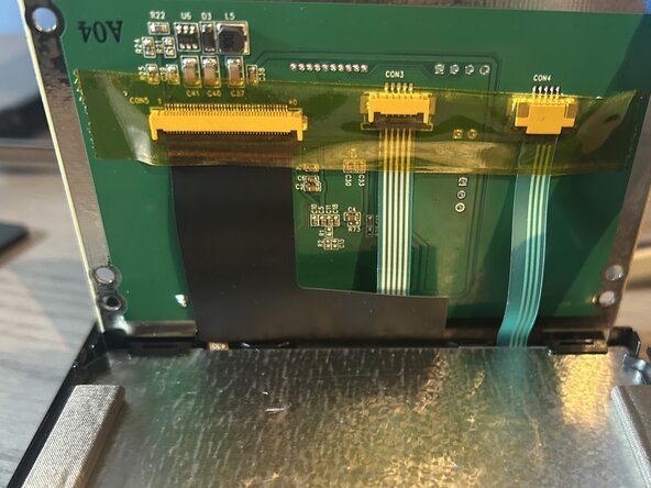

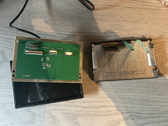

  6. Elgato Stream Deck Classic Teardown, Seperate the circult board and screen: crwdns2935265:06crwdnd2935265:01crwdnd2935265:01crwdne2935265:0
    • Remove the yellow tape to access the ribbon cable connectors
    • The connector on the left and middle you pull up on the black piece to remove the cable
    • The connector on the right you pull the black connector away from the white part (it should look like the picture)

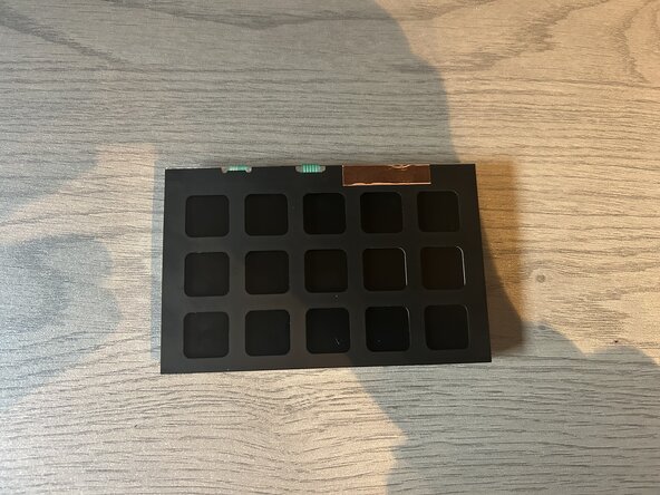

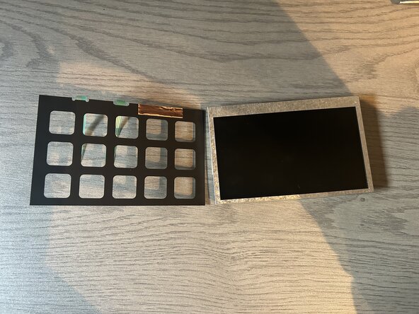

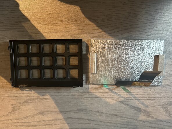

  7. Elgato Stream Deck Classic Teardown, Remove the screen module: crwdns2935265:07crwdnd2935265:01crwdnd2935265:03crwdne2935265:0 Elgato Stream Deck Classic Teardown, Remove the screen module: crwdns2935265:07crwdnd2935265:02crwdnd2935265:03crwdne2935265:0 Elgato Stream Deck Classic Teardown, Remove the screen module: crwdns2935265:07crwdnd2935265:03crwdnd2935265:03crwdne2935265:0
    • Bend all the latches out of the way.
    • The 4 on the sides (2 on opposite sides) bend outwards like the ones before
    • The 2 on top bend upwards.
    • Push up on the buttons to get the screen module up until you can pull it out.
    • DO NOT pull on the cables as you risk damaging them

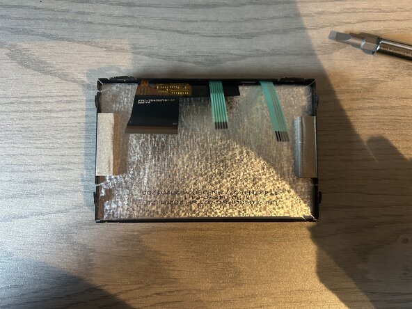

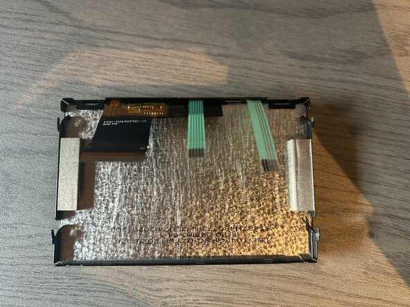

  8. Elgato Stream Deck Classic Teardown, Peal up on the black part: crwdns2935265:08crwdnd2935265:01crwdnd2935265:02crwdne2935265:0 Elgato Stream Deck Classic Teardown, Peal up on the black part: crwdns2935265:08crwdnd2935265:02crwdnd2935265:02crwdne2935265:0
    • Carefully peal up on the black film.
    • The 2 smaller ribbon cables are attached to the black film
