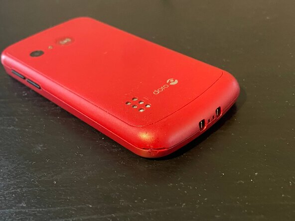

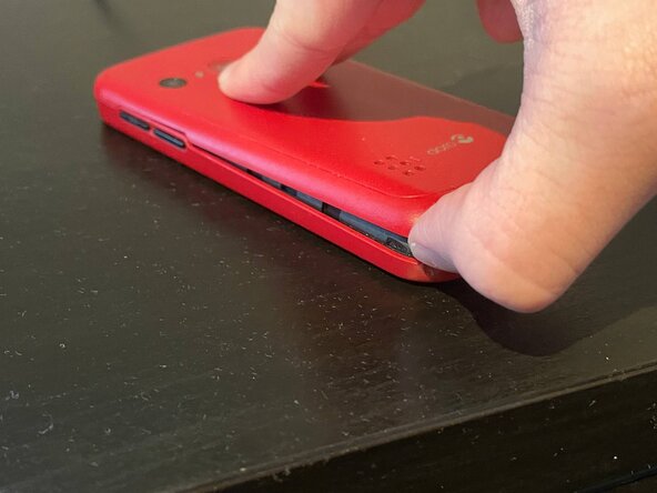

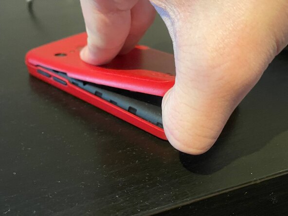

  1. Doro 1881 Teardown, Remove the back cover: crwdns2935265:01crwdnd2935265:01crwdnd2935265:03crwdne2935265:0 Doro 1881 Teardown, Remove the back cover: crwdns2935265:01crwdnd2935265:02crwdnd2935265:03crwdne2935265:0 Doro 1881 Teardown, Remove the back cover: crwdns2935265:01crwdnd2935265:03crwdnd2935265:03crwdne2935265:0
    • Theres a notch at the bottom left side of the device
    • You can simply pull up on the back cover with your fingernail

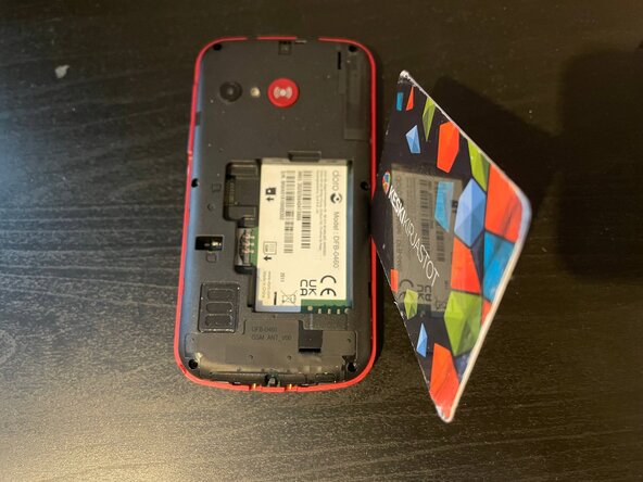

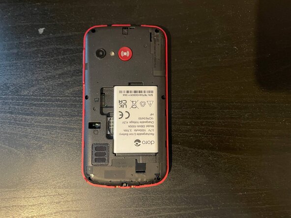

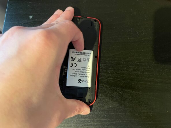

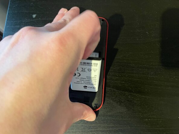

  2. Doro 1881 Teardown, Remove the battery: crwdns2935265:02crwdnd2935265:01crwdnd2935265:03crwdne2935265:0 Doro 1881 Teardown, Remove the battery: crwdns2935265:02crwdnd2935265:02crwdnd2935265:03crwdne2935265:0 Doro 1881 Teardown, Remove the battery: crwdns2935265:02crwdnd2935265:03crwdnd2935265:03crwdne2935265:0
    • Theres a notch just above the battery, where you can pull the battery out

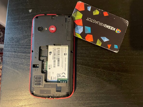

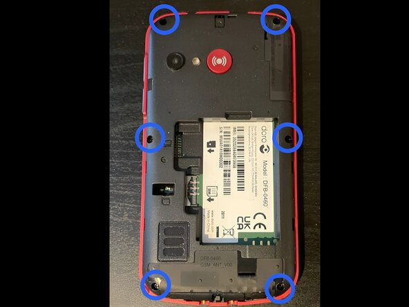

  3. Doro 1881 Teardown, Unscrew the cover: crwdns2935265:03crwdnd2935265:01crwdnd2935265:01crwdne2935265:0
    • There are 6 phillips screws around the cover (circled in the image)

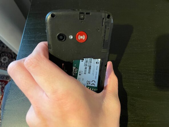

  4. Doro 1881 Teardown, Remove the cover: crwdns2935265:04crwdnd2935265:01crwdnd2935265:03crwdne2935265:0 Doro 1881 Teardown, Remove the cover: crwdns2935265:04crwdnd2935265:02crwdnd2935265:03crwdne2935265:0 Doro 1881 Teardown, Remove the cover: crwdns2935265:04crwdnd2935265:03crwdnd2935265:03crwdne2935265:0
    • After removing the screws, insert an opening pick from the right side of the device
    • Drag the tool upwards
    • Once you reach the edge of the cover, pull the tool towards you
    • You should hear a click, and should be able to pull the cover off

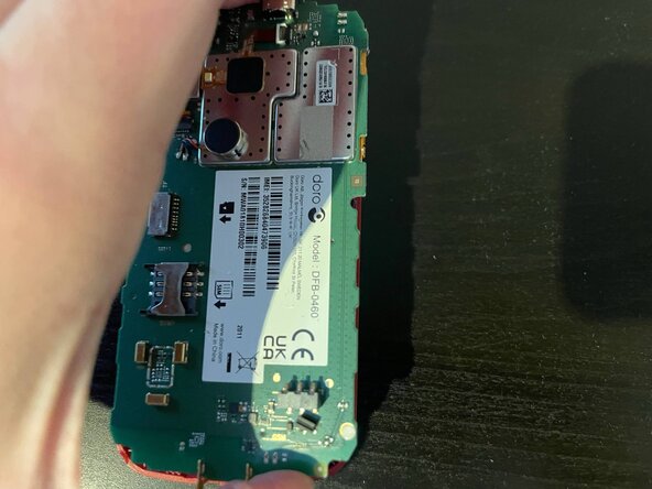

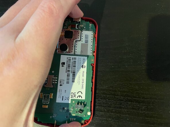

  5. Doro 1881 Teardown, Remove the board: crwdns2935265:05crwdnd2935265:01crwdnd2935265:03crwdne2935265:0 Doro 1881 Teardown, Remove the board: crwdns2935265:05crwdnd2935265:02crwdnd2935265:03crwdne2935265:0 Doro 1881 Teardown, Remove the board: crwdns2935265:05crwdnd2935265:03crwdnd2935265:03crwdne2935265:0
    • You can simply pull the PCB towards you
